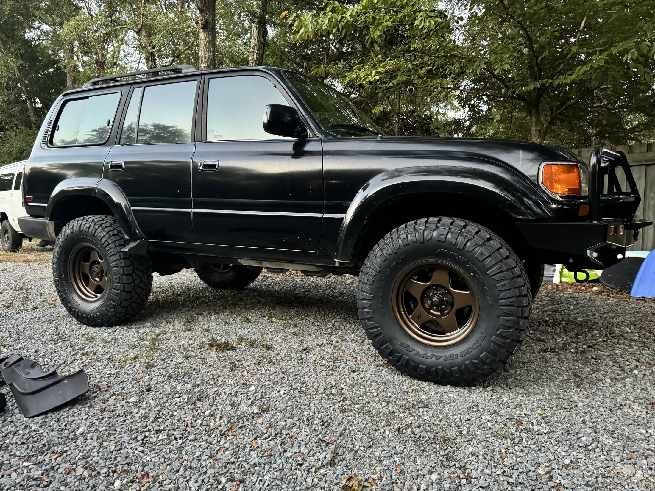

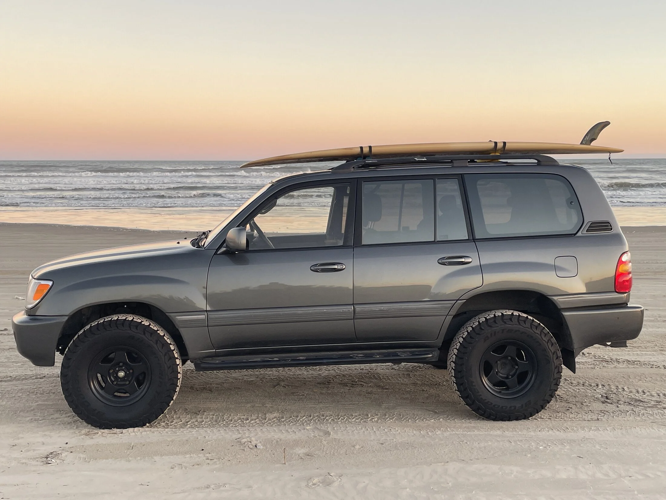

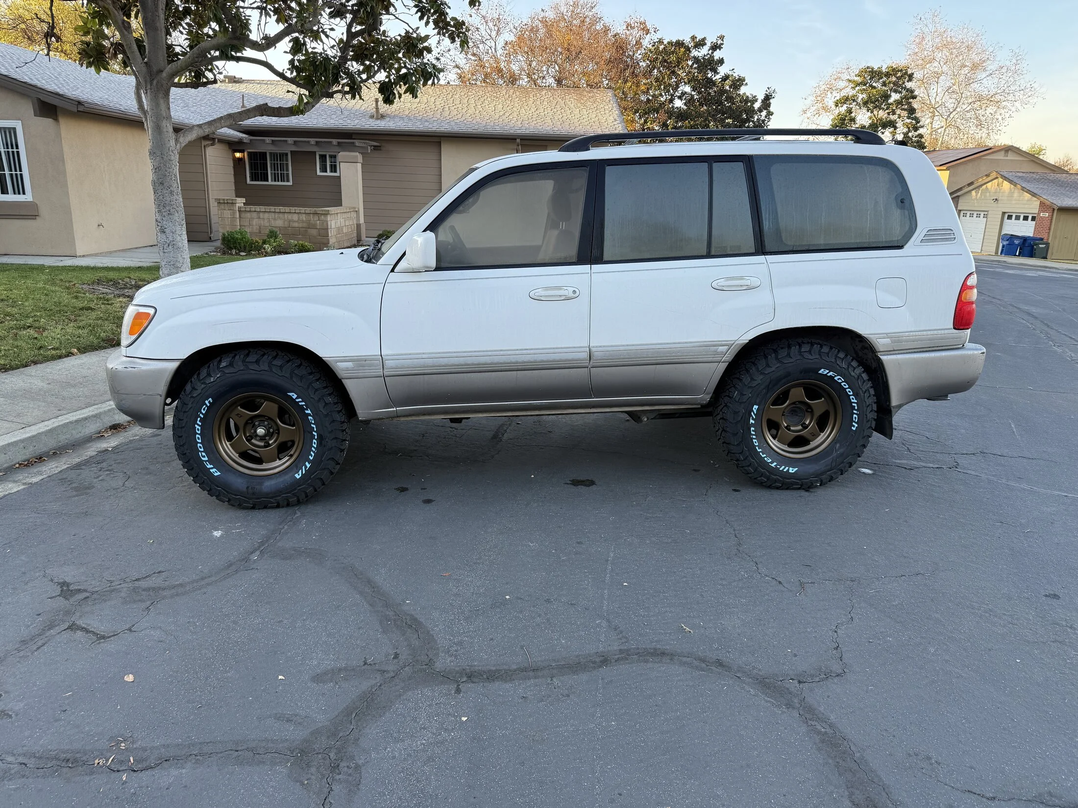

Here ya go
Some of the 200 series guys are running them and tons of tundra owners

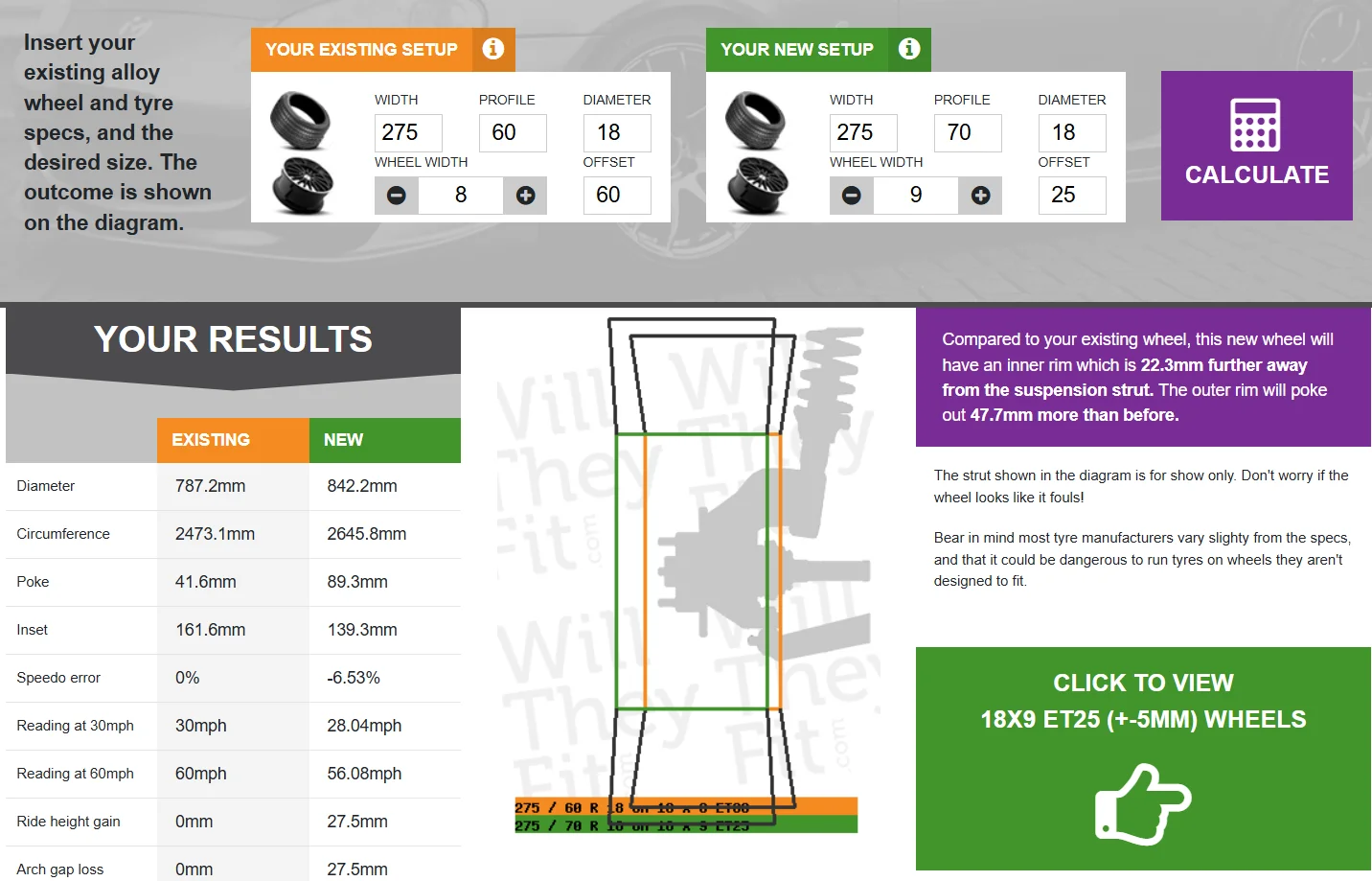

What size tires are you going to run? I'm on the stock AHC and was thinking of getting the F5 in 18" with 275/70/18 - just not sure if they will fit and having a hard time finding info on these wheels in 18" since it used to be 16" only
I’d confirm with SCS that they fit a 100 specifically. +25 is fine for offset, will be similar to a stock rim with 1.25" spacers (+28)
Edit:
24.5lbs isn't bad for an 18.

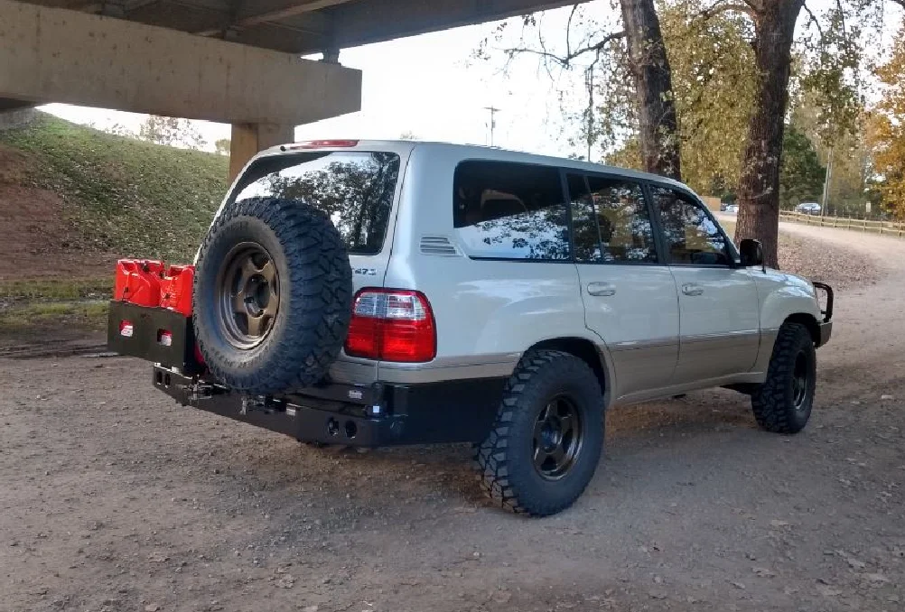

Here is my RRG with 285/75-16s on SCS F5s.. 2.5” lift with OME bars and 860 springs. Yep, it rubbed, but just on the plastic, heat gun was able to fix that. Not sure why 18s would be an advantage?
