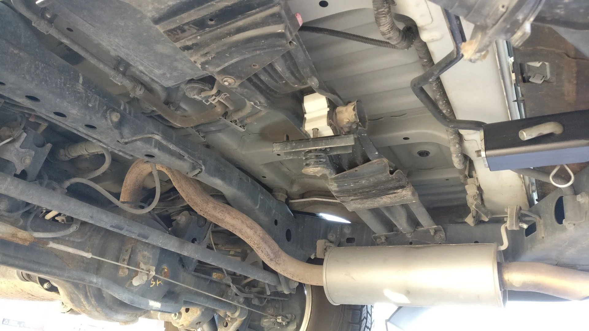

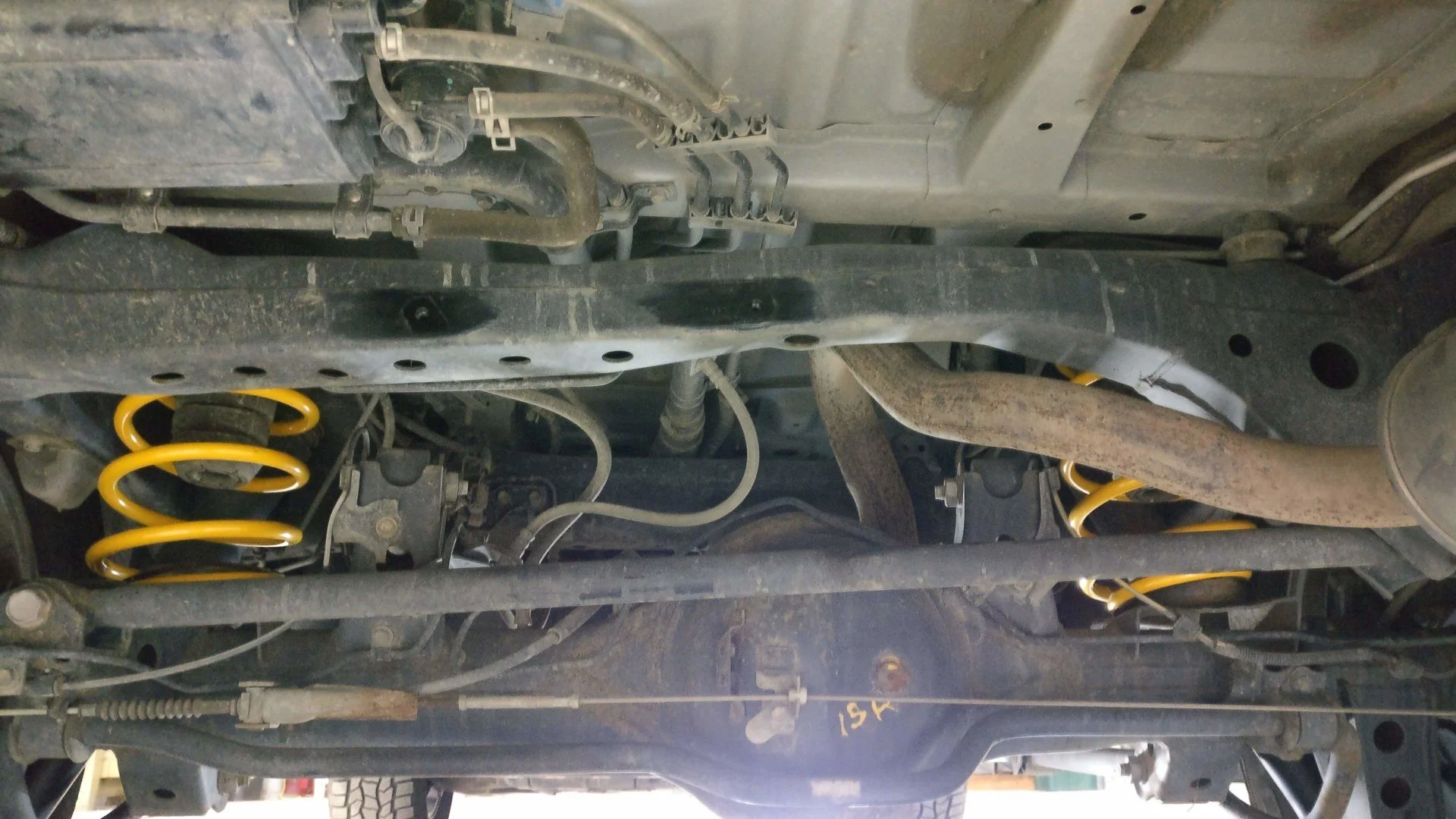

This wont work for everyone and I fully realize its a privilege, but I bought a winter beater.. At first snow/ice of the season the LX gets parked and doesn't come out until late-April after all the salt and salt brine has washed off the roads. This is the result after 5 winters in Michigan with a Florida truck... Seeing the cost of annual undercoating its not all that much more expensive to invest 2-3k into a beater and run it into the ground. Its totally worth the peace of mind when you're 2500 miles from home to know you can make repairs easily with hand tools (no rusted fasteners or lines).
1903676
1903678
1903677
Very nice bottom @whitenoise! BUT, the LC is so capable and fun to drive in the snow that I'm like a kid on Christmas morning before a snow storm. I make up excuses to get out and drive in the fluffy stuff even when we're not packing the family up for a ski weekend up in the mountains. Guess my LC is my winter "beater" :grinpimp::bounce2:
