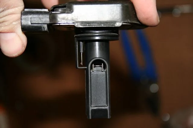

In the picture in that thread MAF and TB cleaning, it shows a picture of (what would seem to me) the MAF. Sorry for the silly question (I'm hardly a mechanic or anything close to it), where would I find this on the truck. That picture just shows a zoomed up picture of it being held in hand. Where can I find this on my truck to clean it? I do the TB regularly on mine, just want to do the MAF. Ideas?
The MAF is the large, round sensor assembly JUST aft of the airbox in the intake track. You'll see the plug for the wires going into it, and it will be attached via worm clamps - one side attaching to the lip of the airbox, the other side attaching to the intake tube that runs in front of the fan shroud and into the TB.
Just unclip the plug from the MAF sensor, loosen the worm clamps, and pull it free of the airbox and tube. DO NOT touch the internal wires with anything. They are fragile and can be permanently damaged by physically fiddling with them. The only thing you need is some MAF-specific cleaner in an aerosol can. Just spray the wires and let it dry thoroughly before reinstalling. Easy peasy.
This is the MAF. It mounts on top of the intake, just down from the air filter (passenger side of of truck). Disconnect the electrical harness, remove the screws and it lifts straight up. When instlalled all you can see is the top part where his fingers are holding it.
