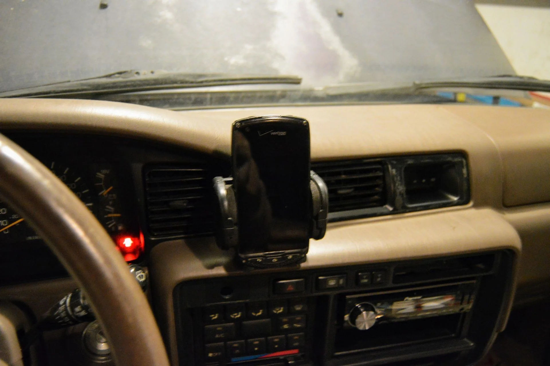

The brackets are laser-cut, CNC bent, and clear zinc plated for corrosion protection and screws/ are included. The comparable mount, made by Pro-clip is $29.99, + shipping is made of plastic, and covers up your center vent. Installation of my bracket is easy and only requires minor trimming of the inner dash (covered up when the vent trim is installed). More detailed installation instructions to follow.
EDIT: see below for my current recommended device holder/method
For now, if you purchase my mount, you'll need to buy Bracketron P/N PHV-202-BL (holder) and COM-102-PB (base plate) to complete the setup. I will hopefully lock down a source for both of these soon to include everything as a kit

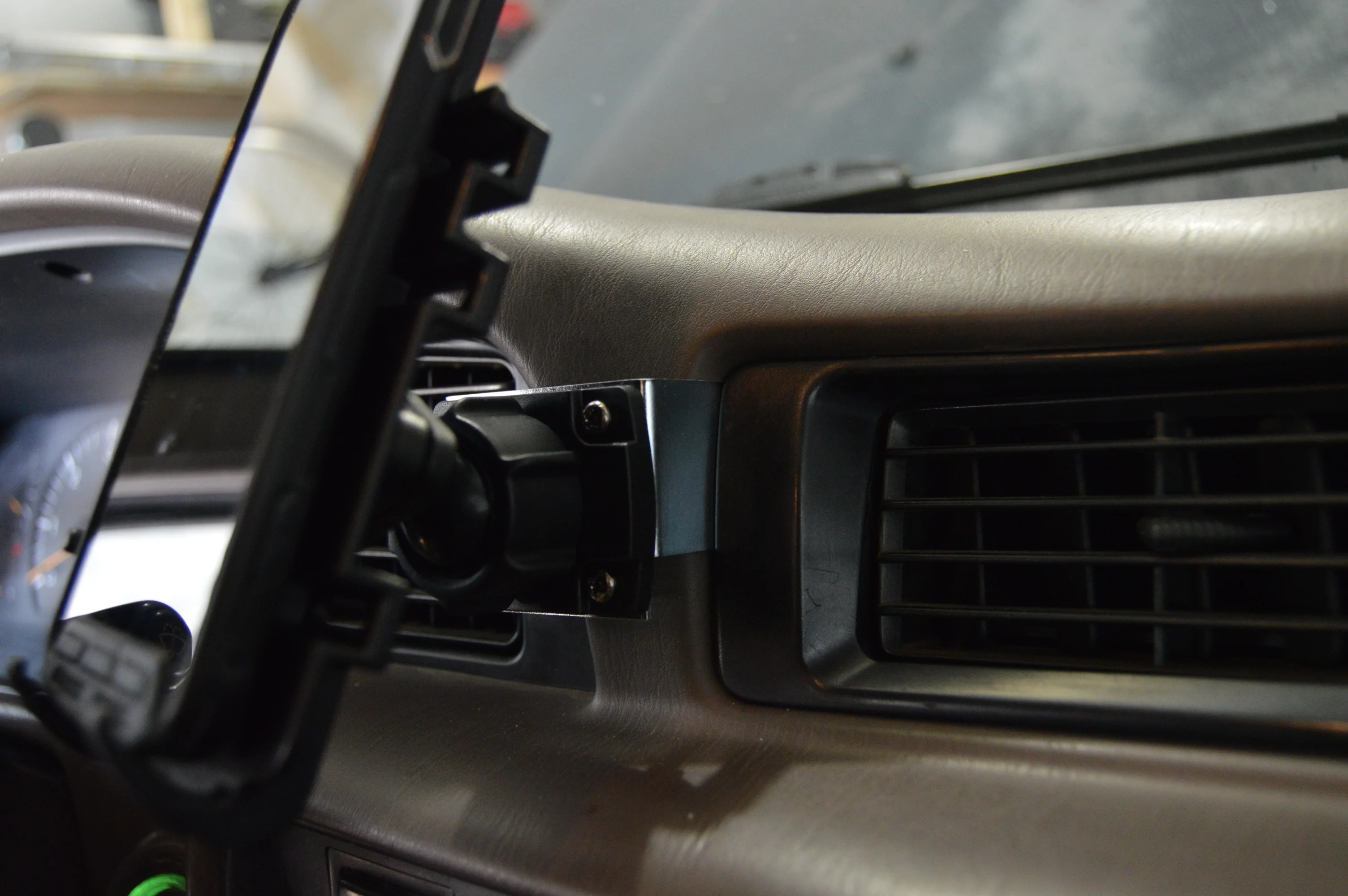

Update - I wasn't 100% happy with the Bracketron mount, so I found a solution to use the much more popular and versitile RAM mounts. This setup will allow any of their device holders with the 1" ball to attach to the bracket. I like this setup since the device is still tucked close to the dash, but lets you adjust the mount to the perfect angle.

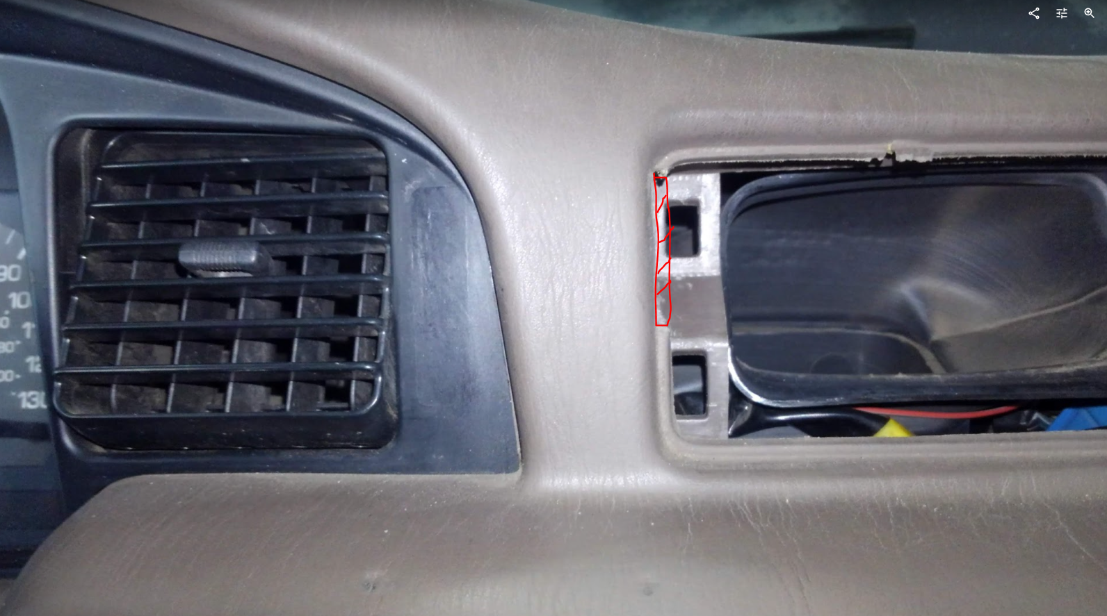

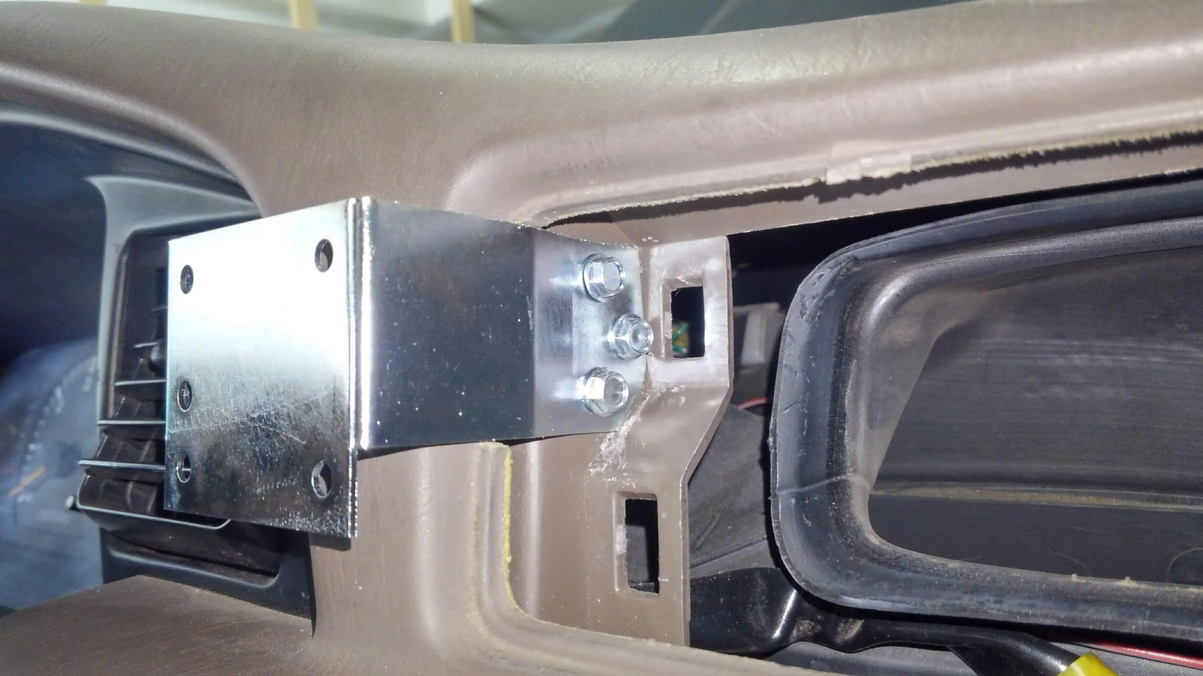

Forgot to add those photos above - you remove the center vent piece (not too difficult with the right plastic prying tools), then install self-tapping screws as shown after some minor trimming with a file.
Option 1 is to use double-sided tape behind the tab attaching to the gauge cluster surround (not shown)
Option 2 is to use the long self-tapping screws to attach the mount. I consider that the phone mount is permanent so I didn't mind drilling holes there.
Option 2: (can use 1 or 2 screws here depending on how heavy your device is and how many holes you are ok with creating)
