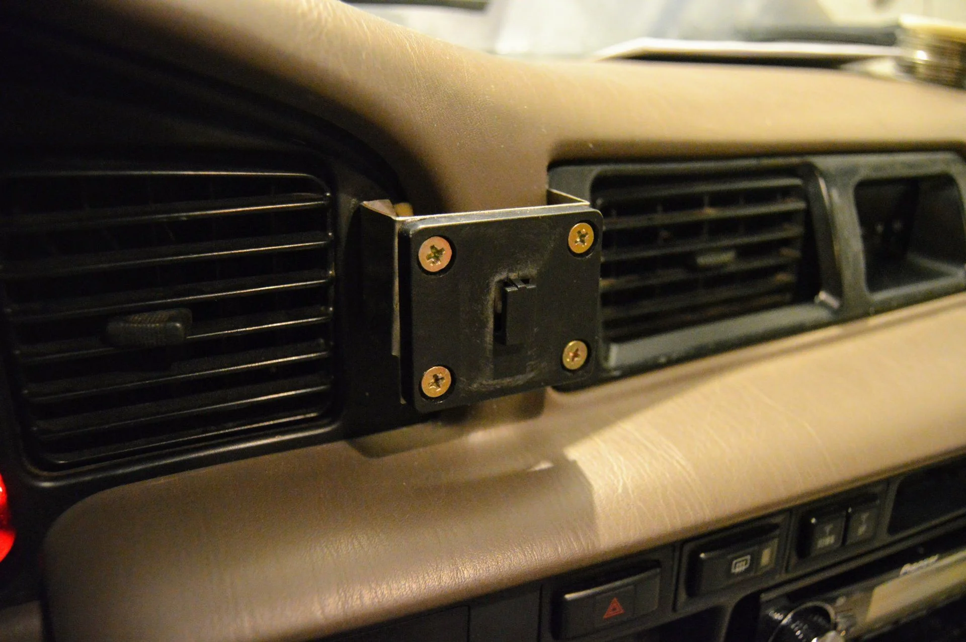

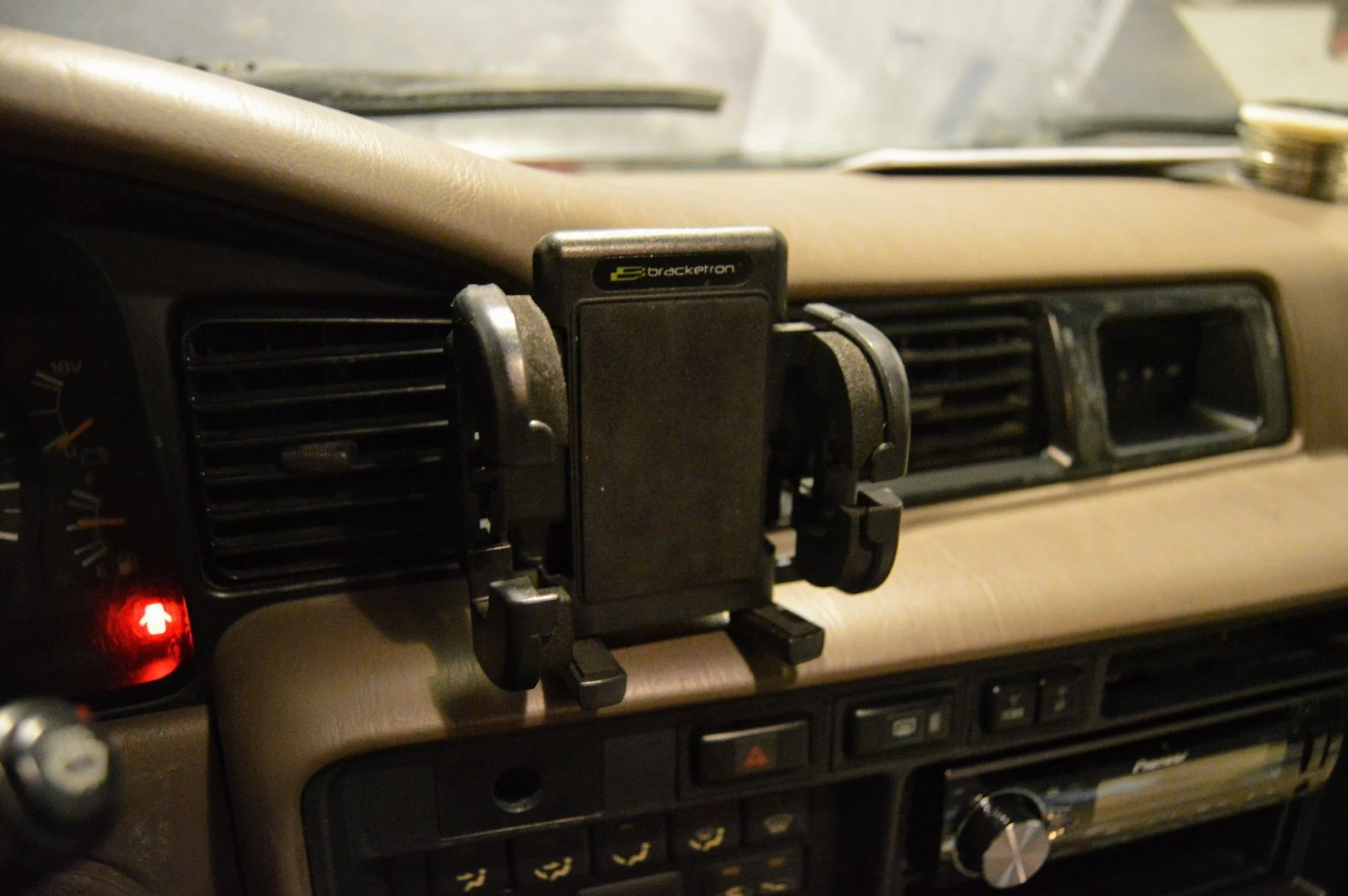

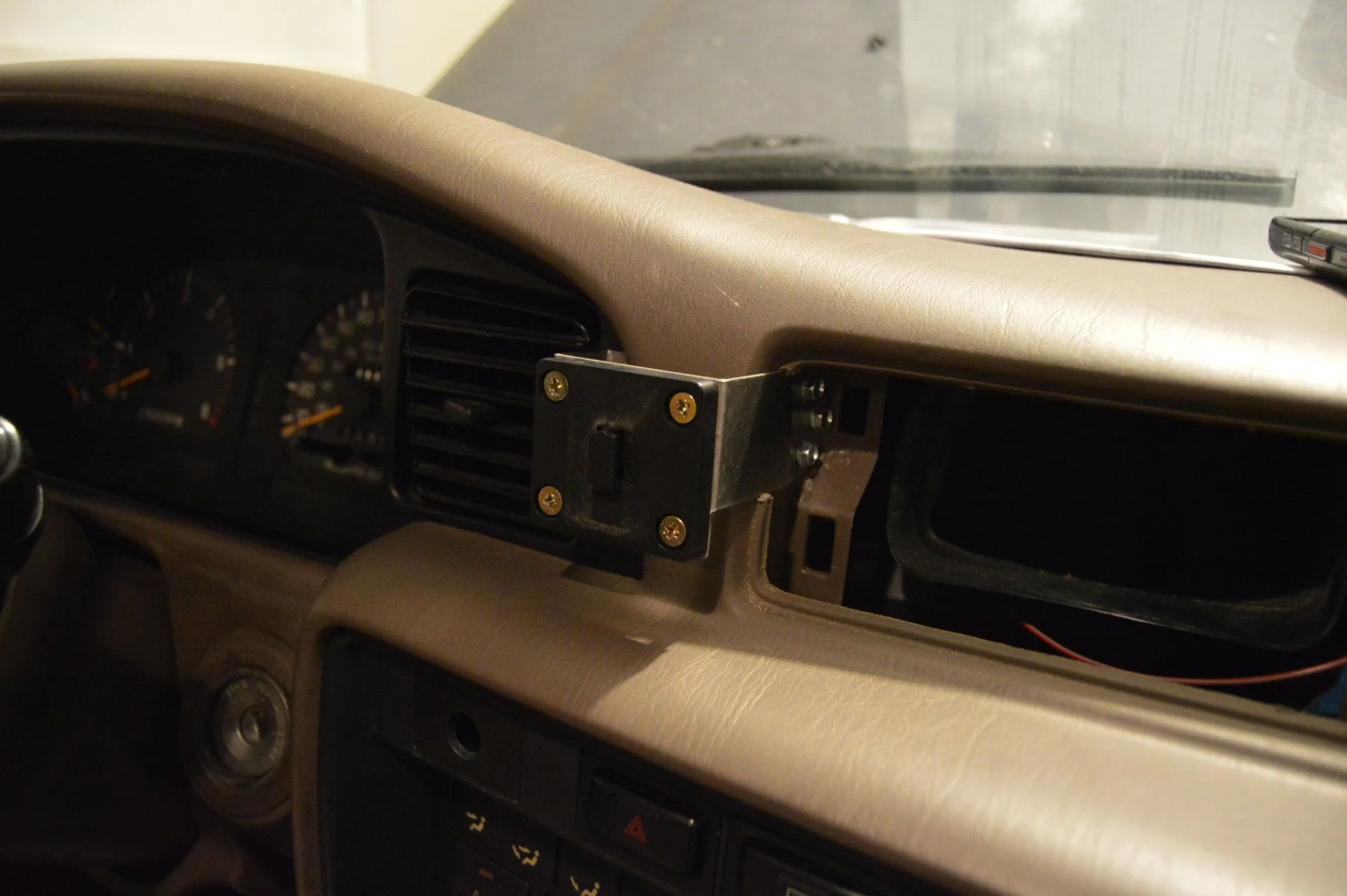

I've never been too keen on the 80 series phone mount solutions that place the device way over in the useless cubby area, or any windshield/dash mounts. I wanted something integrated and clean, so I got to work in CAD, and got this water-jet and bent up. It uses a Bracketron device holder, but others (Ram, etc) can be made to work too.
It attaches with 3 screws to the dash structure for the load-bearing support, and a double-sided sticky tape pad on the other side for stability.

Like it. What does the dash look like when mount is removed?
If you use double-sided tape on the left side of the mount (the "foot" I call it) then the dash can be returned to 100% stock with zero evidence that it was ever installed.
Thanks! What kind of tape do you recommend to keep grip from subzero to 180 or 190 (closed car in SoCal summer)?
Sorry for the delay. I recommend 3M 4011 double sided tape, but the regular 110 stuff works well as long as the surfaces are very clean.
4011 is really hard to remove, so I have been using 110 while I get the prototypes made.
