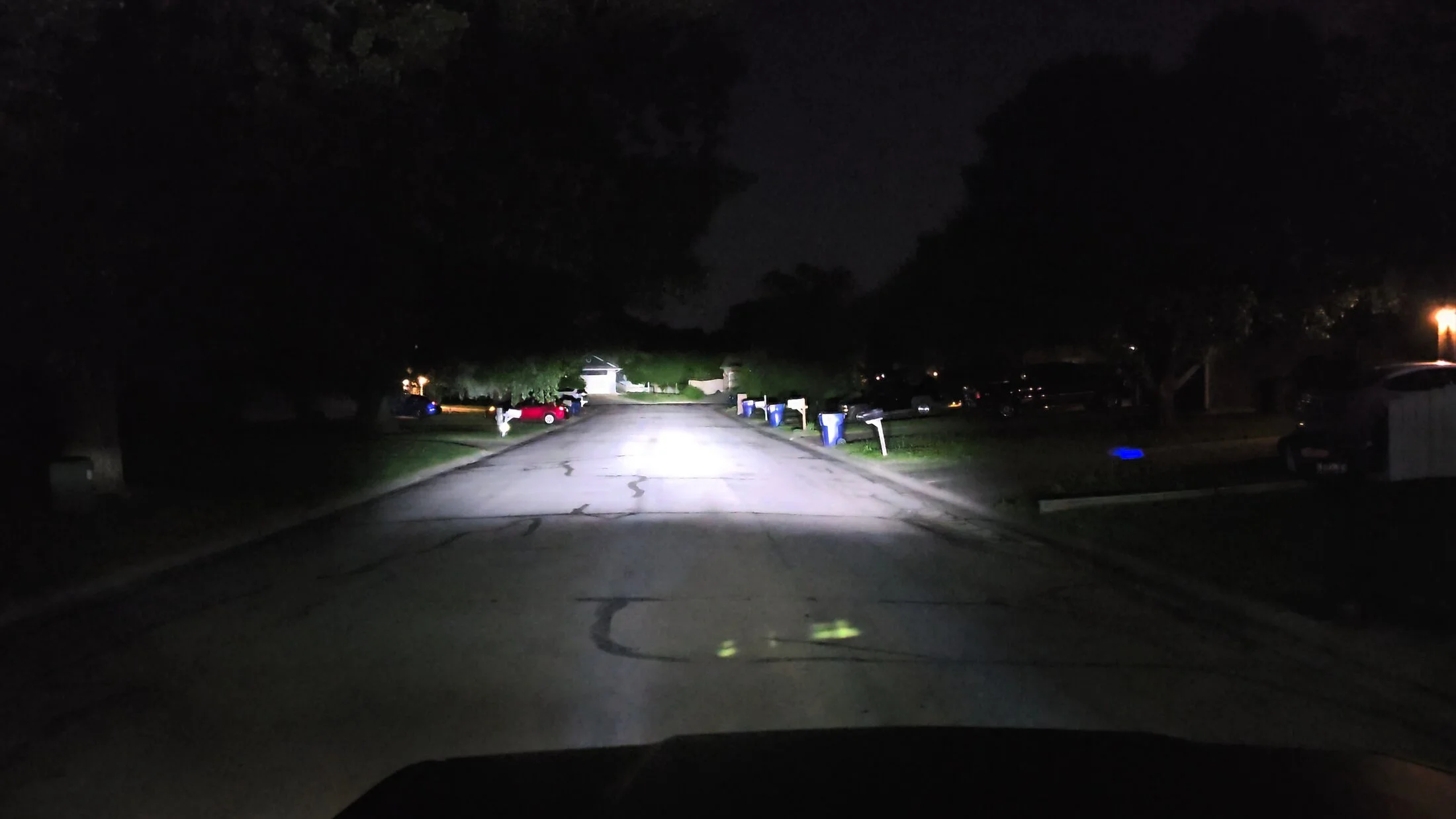

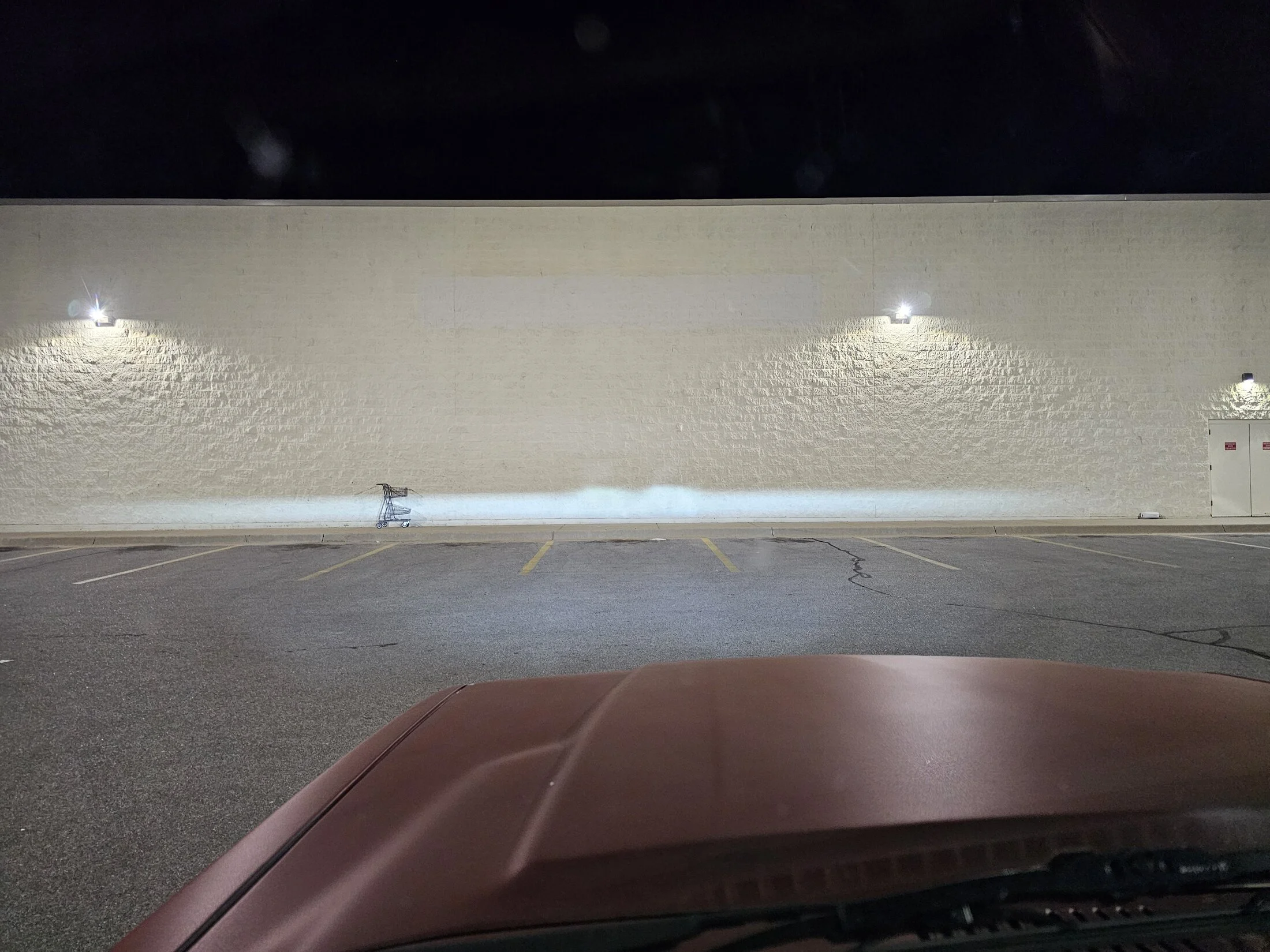

Starting off, these retain the reflector appearance while maintaining a very nice cut off line.
The beam is pretty wide and the throw is excellent for night time driving. There's not a ton of foreground to wash out your vision.

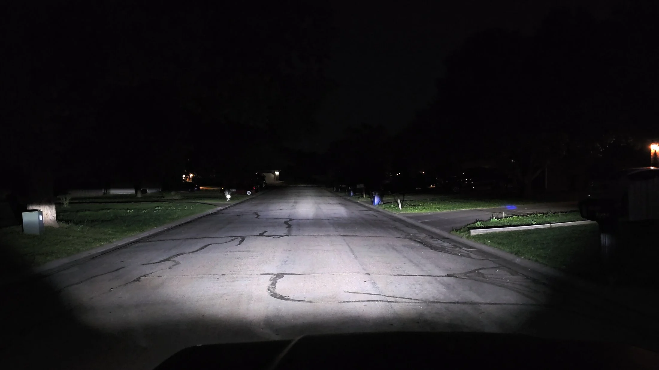

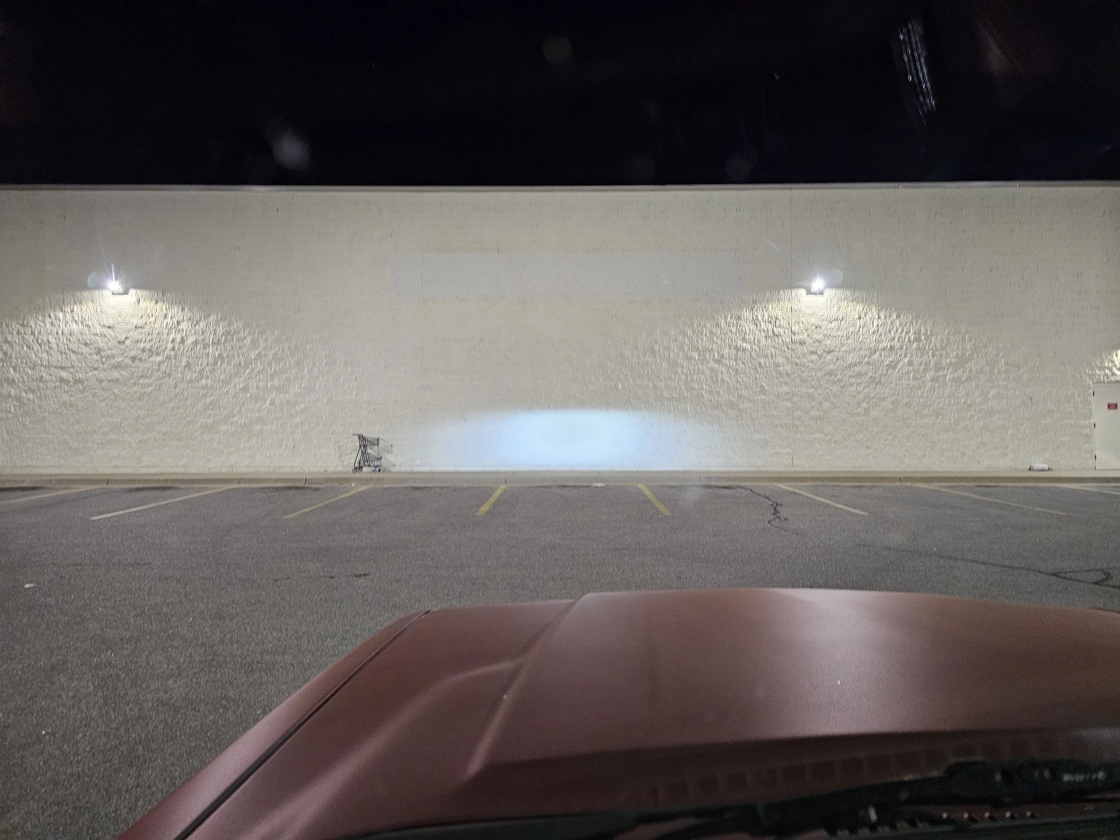

With that being said, I did take some photos of the high beams they're currently aimed close to eachother but each individual hi beam has a pretty good "hot spot" that is easy to aim.
This means that you can get a nice long distance aim when you're on those empty roads and need to light it up. Remember, excess foreground lighting prevents you from seeing well in the dark.

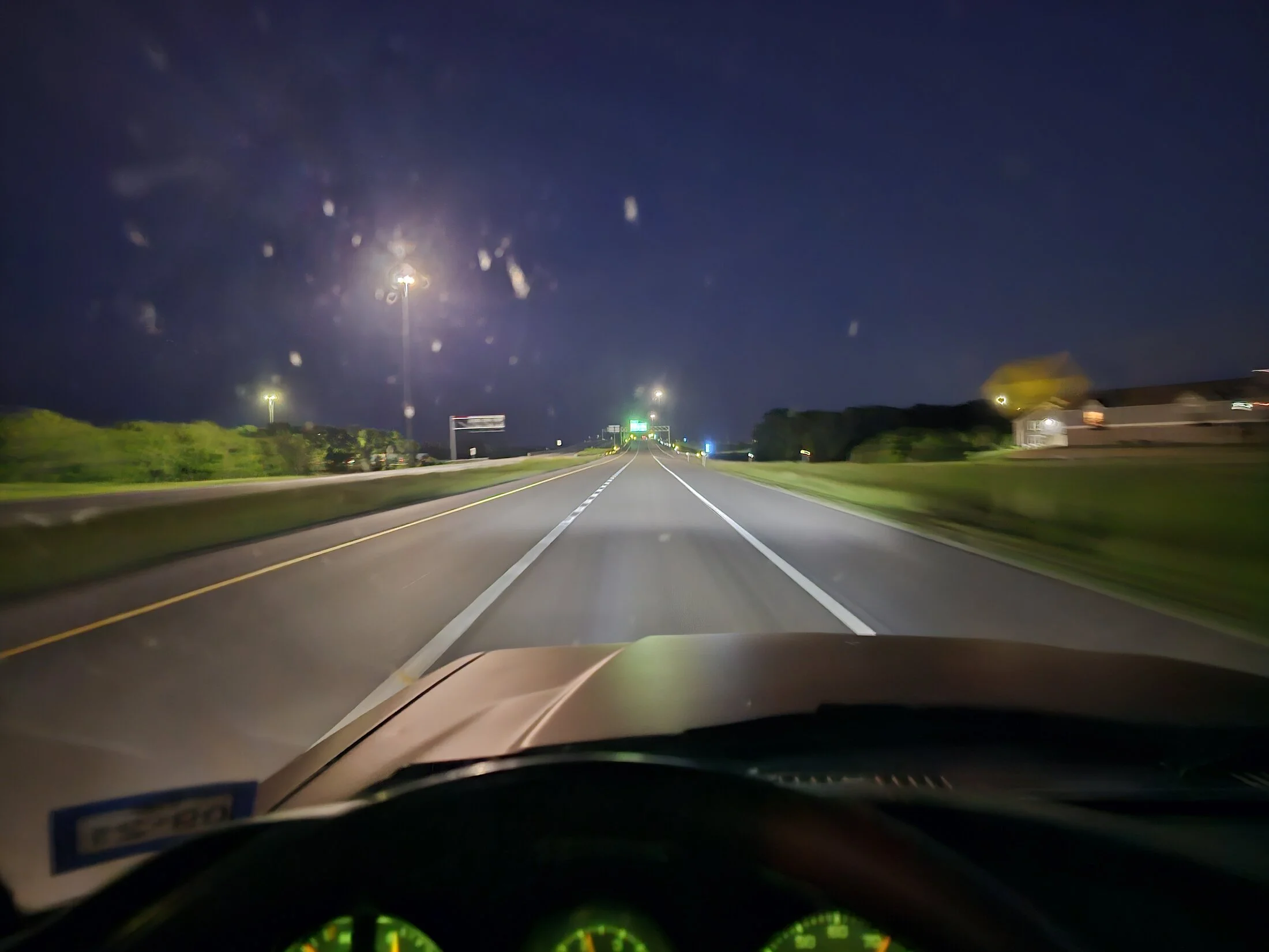

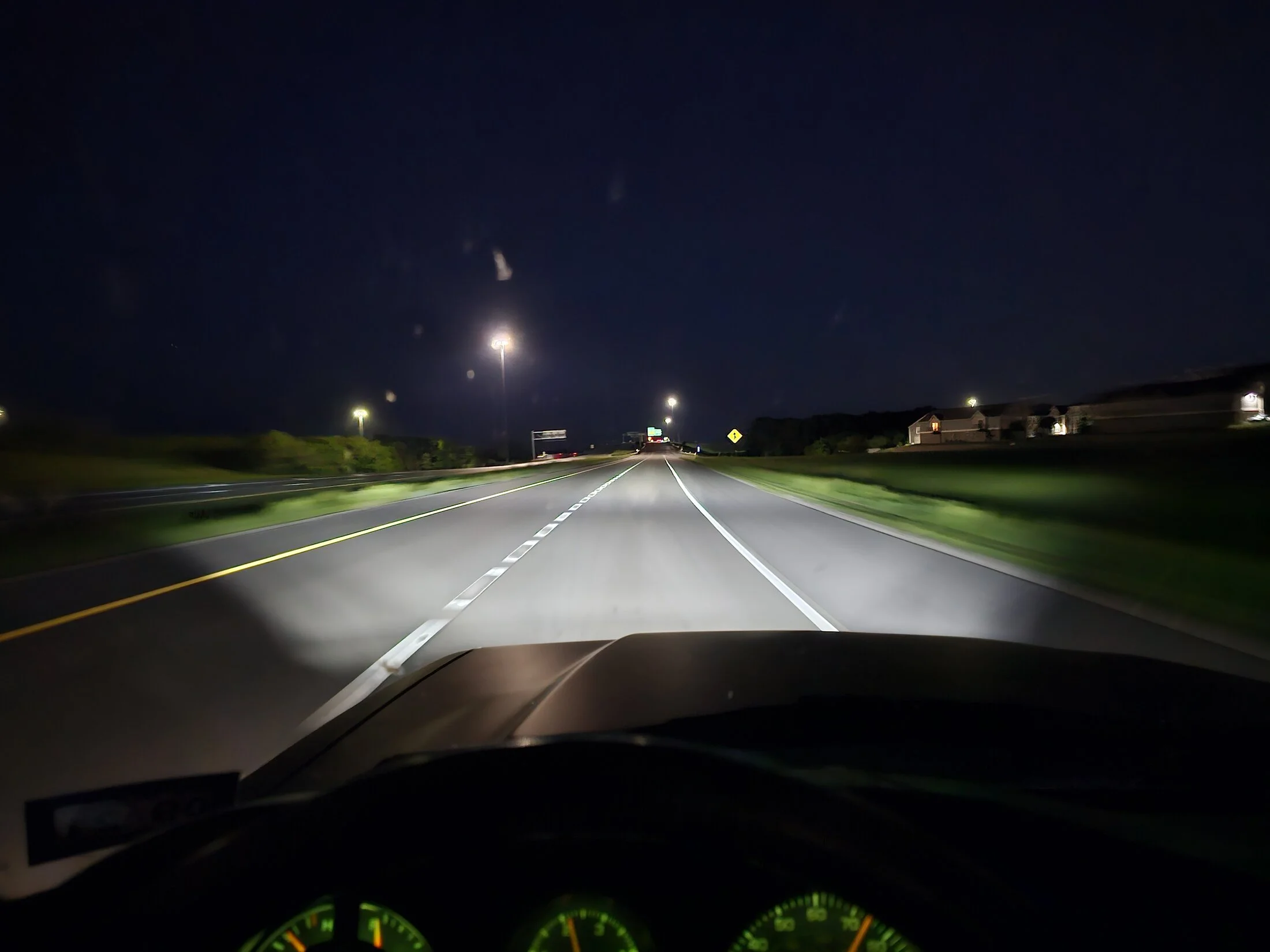

The video didn't attach. Have some screenshots instead. It is just a quick low to high in my neighborhood where it is very dark. I haven't had a chance to snag good night photos with how late sunsets and early sunrises are.
There's still a tiny amount of "bleed" (or what we call "dirty light" in tactical applications) where you can still see road signs. In the Headlight Junkies realm, we call them squirrel finders.
I retrofitted FX-R HID projectors into my Toyota Pickup and RX350 HID projectors into my Supra. While those have extremely crisp cutoff lines, they did have the tradeoff of not having any soft "light bleed" for me to hunt down road signs with.
For what it's worth, these LED reflectors are impressive for their simplicity, sharp cutoff, long distance throw, and they just look good. No ugly bulbous multi-projector'd LED setup here.

If you scroll up, there are some beam output photos against a wall and along the road.
