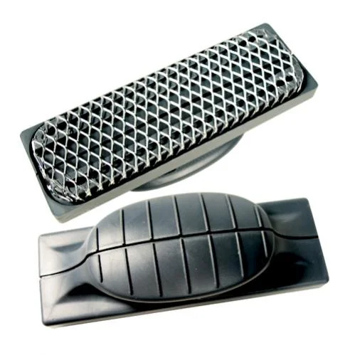

I want to cover all my bases so I have another question. I used a drywall rasp like this one,

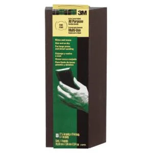

and the sanding sponge shown here,
I use the rasp first and then the fine sanding sponge to finish it off. Is there a chance that the joint compound is too smooth?

The Rasp is only to smooth the edge of a drywall !. Has coarse openings and would not recomend to do it on your skim coat job.
Sanding blocks are the best !. Fine grit is great for final sanding. A great improvement from sand paper.
