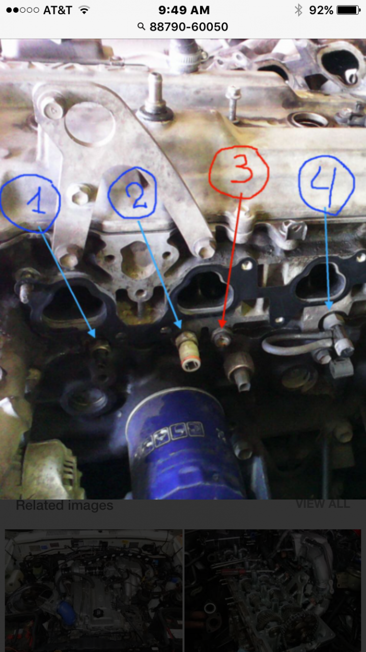

I had a similar issue and it was the #2 sensor in the picture below:
You can get to it with the intake on. Disconnect the wire going to that sensor. If your AC cutout problems stop, that sensor, or your coolant temp, is the problem.
Here's the part number for the sensor: 8879060050
It's not too tough to replace with a deep socket and the right extensions. Mine leaked about an ounce of coolant when I swapped them.
