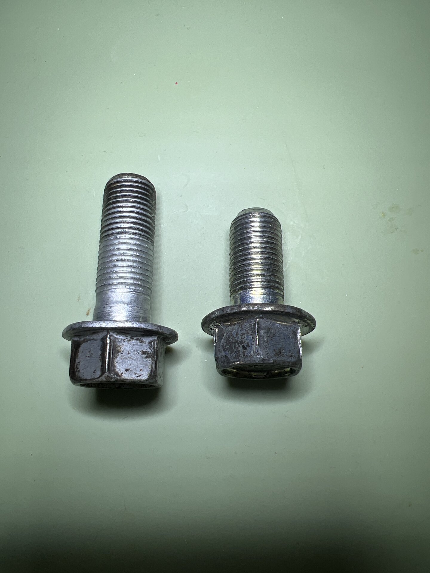

I have a 2006 Cruiser that I’ve changed the front rotors on and in so doing, stripped one of the bolts that attaches the rotor to the hub. There are five bolts (number 10 on the head) and I cannot find the OEM PN. I know it is an easy one for most of you but I’m pulling my hair out. I called the “stealer” and they said Toyota replaced the part with the same one in the caliper but I’m not sure I believe that as it is longer (same thread though)

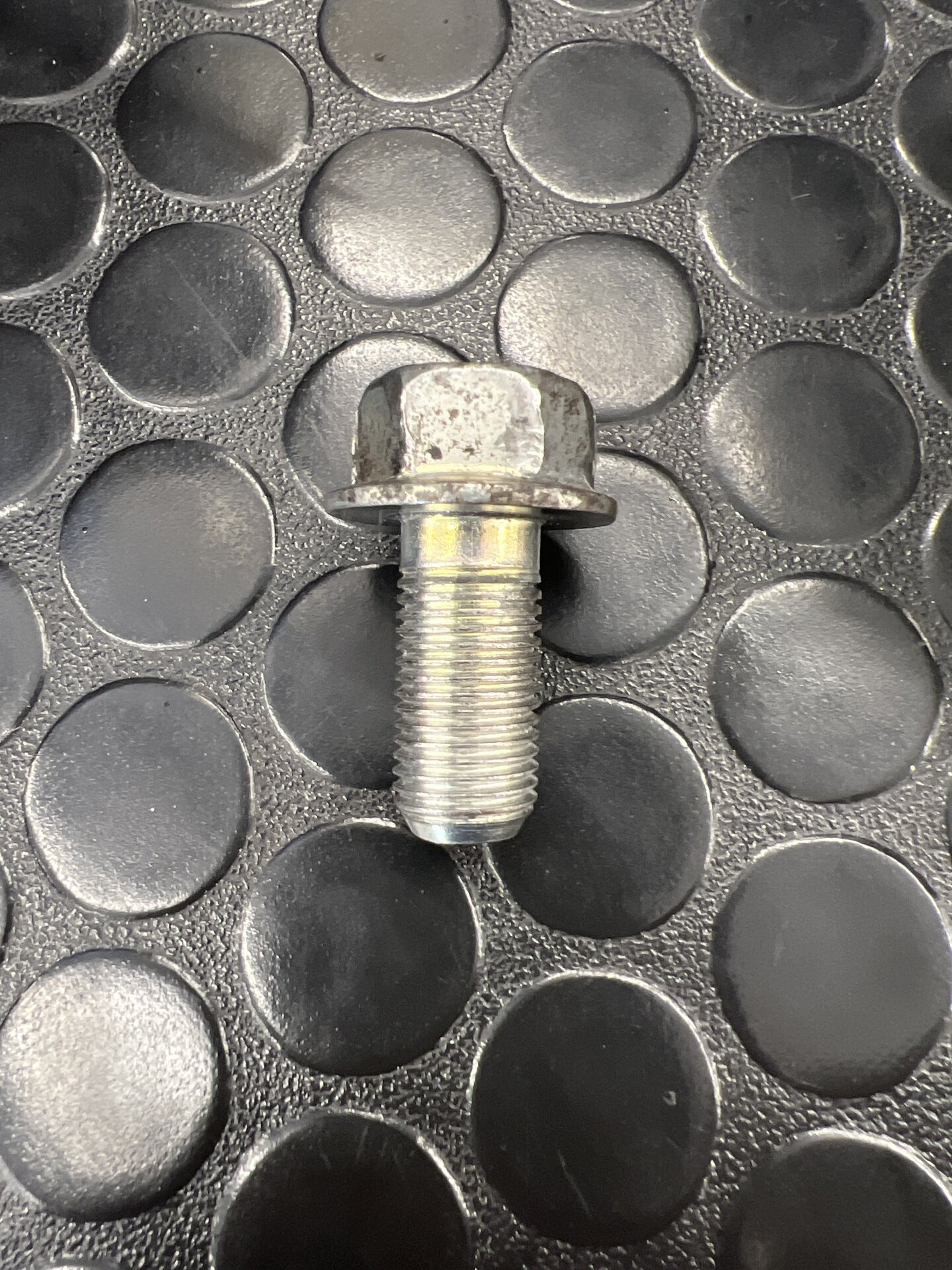

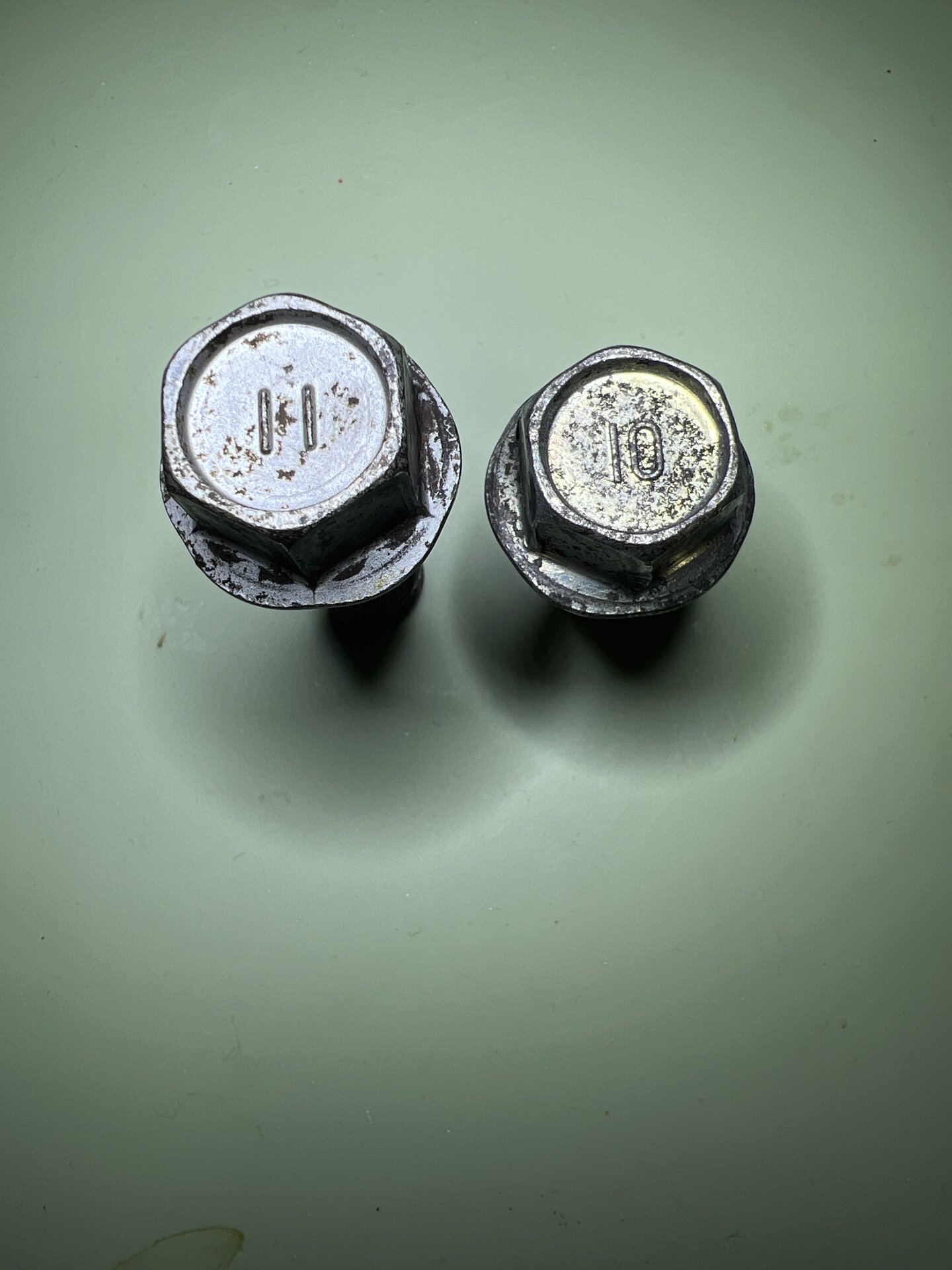

Thank you all. The bolt on the left is 90105-12174 (Rear Caliper Bolt) . The one on the right is the one I took out of the front rotor and the one I’m looking for. The part @YotaWagon sent does work but is longer (see pics). Did Toyota replace the shorter bolt with the rear caliper bolt? Also the Rear Caliper Bolt has “11” forged in the head and the mystery bolt has a “10” forged in the head.
Obviously I can't measure them directly, but I did my best to count the threads and I think the part I listed has the same number of threads as the shorter one that you're looking for. It also aligns with what the dealer told you since it's popping up as a caliper bolt in some parts diagrams.
Great! Thank you so much. I will order them. I love these 100s. I have a 2000 LX470, a 2002 LX470, and this 2006 LC. I can‘t imagine not having one in my stable.

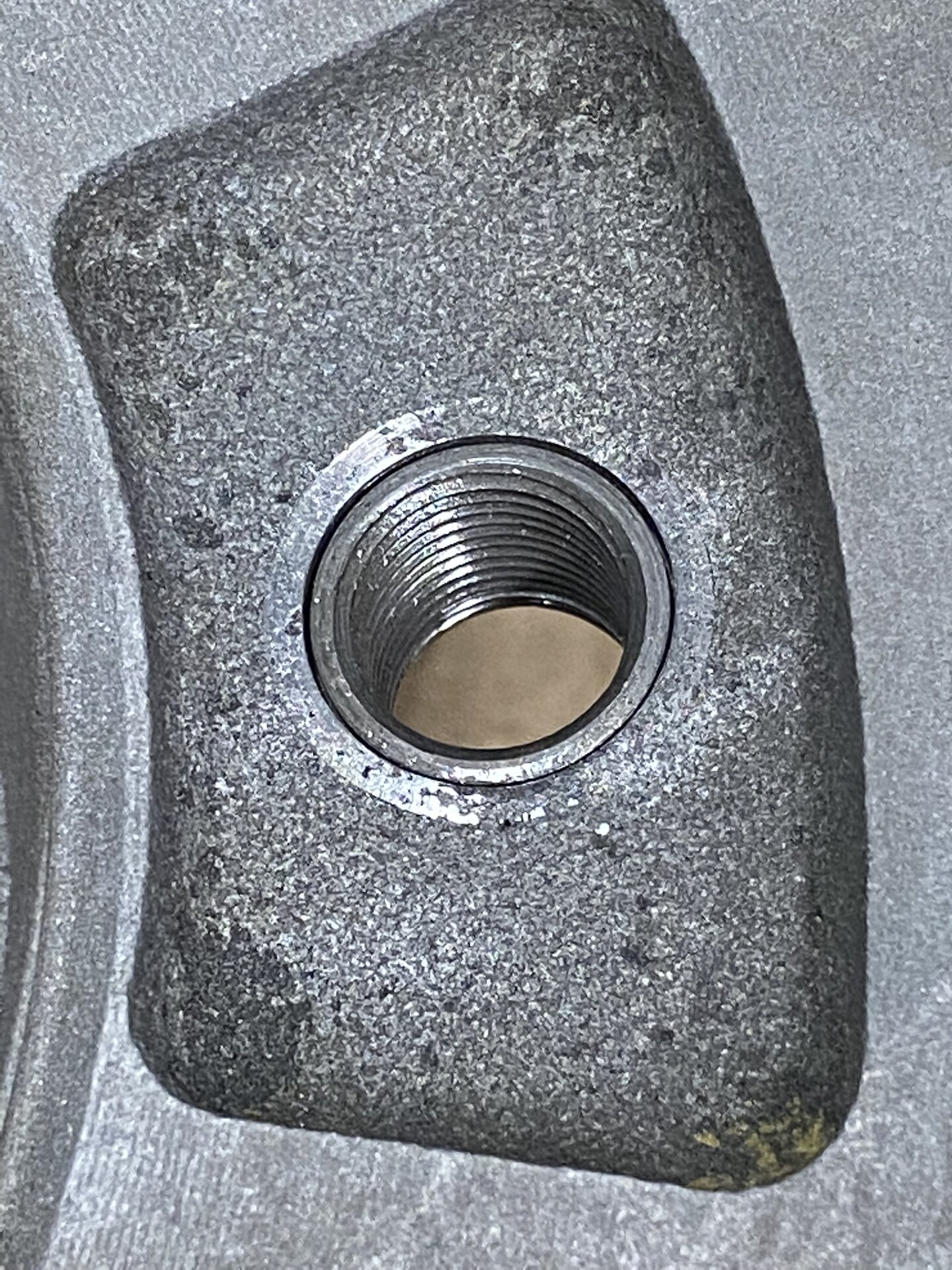

If rotor bolt cross threaded, hubs capture threads will at minimum need chasing. At worst you'll need a time-sert.
Chase Kits loaner at O'Reilly's

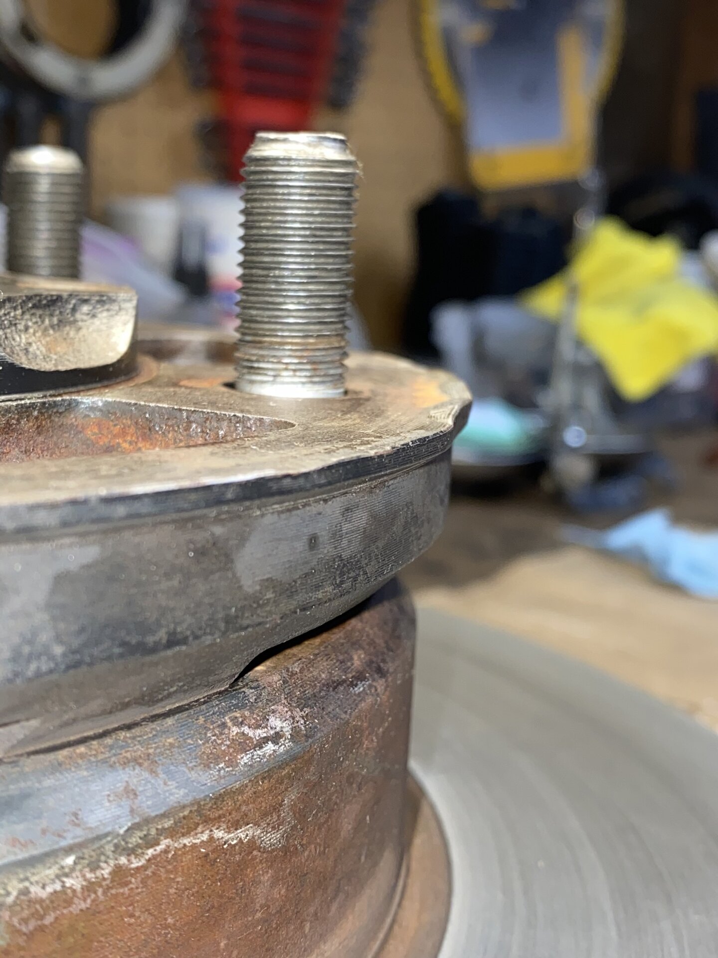

Hopefully your hub to wheel mounting surface (runout) not damage, from improper separation/removal of rotor!
Like this one.
