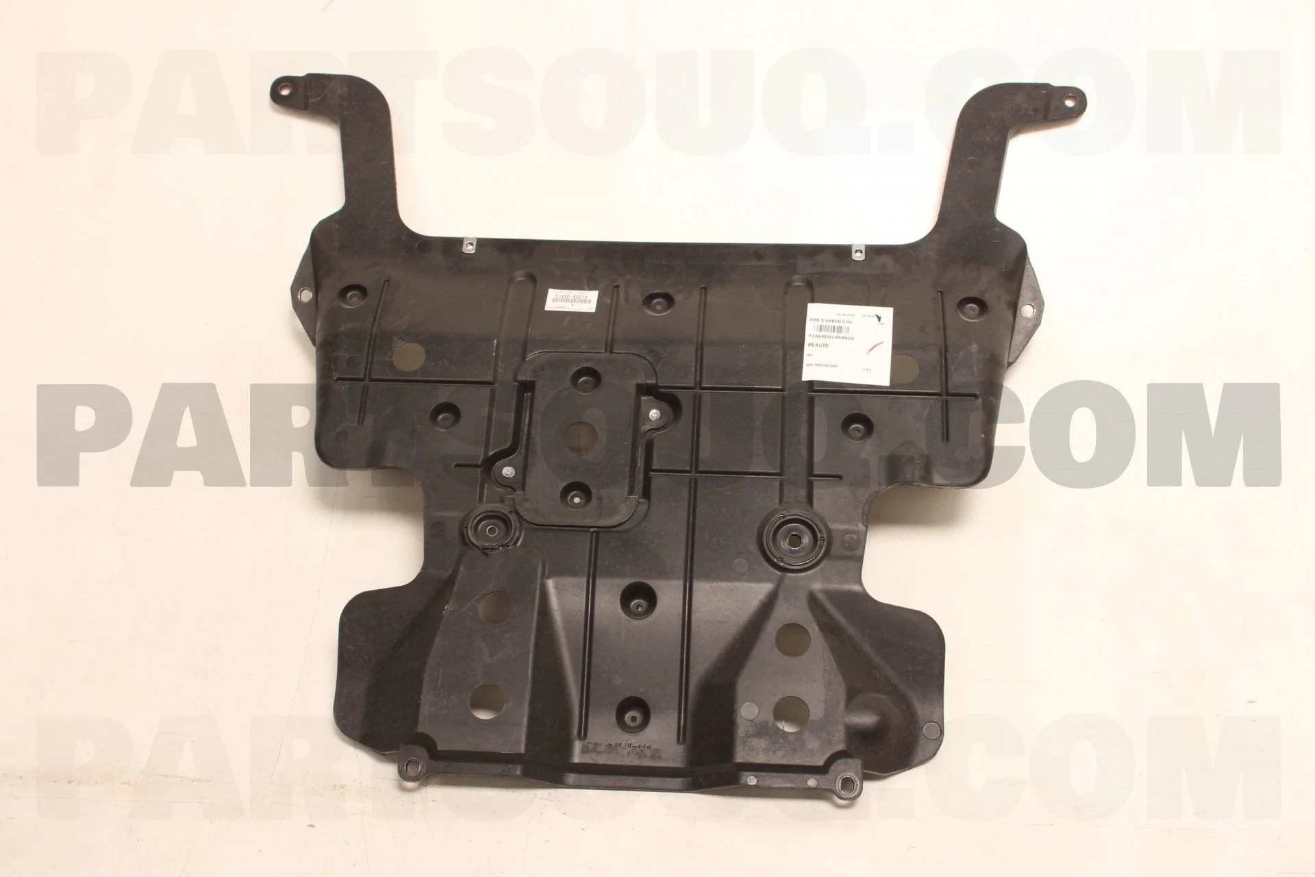

51420-60010 “COVER, ENGINE UNDER, NO.2”
That is it! Thank you sir!

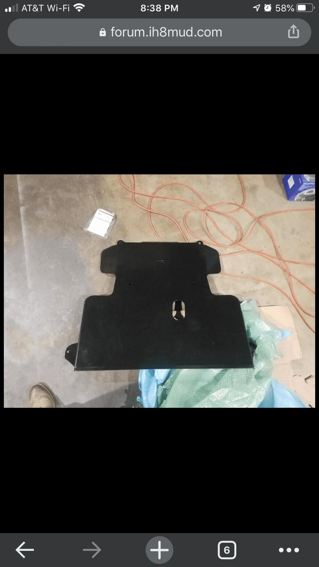

Get an aftermarket skid plate.
Do you have any recommendations?
This is cheap and people like it.
Thank you for this recommendation! This is a direct replacement for 51420-60010 “COVER, ENGINE UNDER, NO.2”? I wanted to get clarification because the link points to a "front skid plate", and I wouldn't want to order the wrong part. My front skid plate is actually in good shape, and I have a spare for when it starts to rust.

The above skid plate that was shared is not what you are looking for, don't order that.

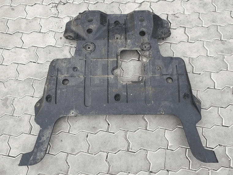

I think (if I remember correctly, perhaps not:D) it's weakened in a straight line somewhere near those tabs, because when mine broke off I could see the offending section had a /\ shaped cross section. So it breaks off very clean & looks like it have been sawed off. Just as with this random picture found on the internet (not mine). But once again, I could be wrong.

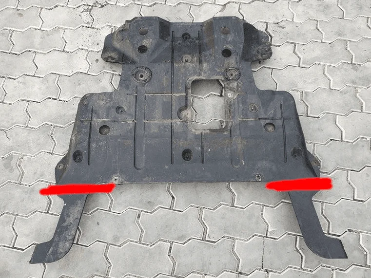

Ah, I see the broken tabs in the image you found, however, mine is completely missing the L tabs. I modified your picture. My replacement part is missing everything below the red lines. This is why I assumed the tabs were cut off after the clips at the end broke.
As a matter of fact, the driver side on my original one broke just under the door, and the remaining L bracket was flapping against the underside right under me. It was annoying as hell, and I don't know why I didn't think of cutting it off. I just tucked it up until I could replace it. :p
