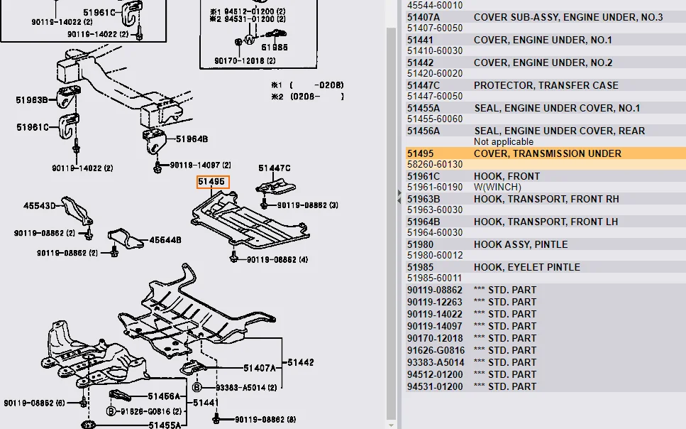

Part Number Needed - Plastic Guard, mounts under driver and passenger seats -- FOUND: 51420-60010 “COVER, ENGINE UNDER, NO.2”

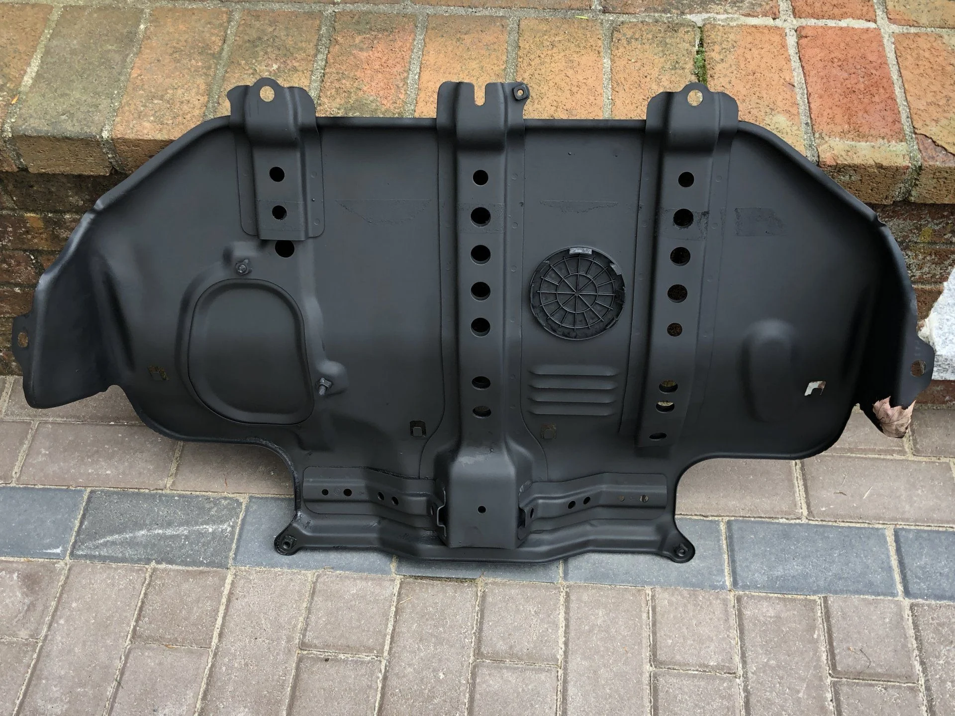

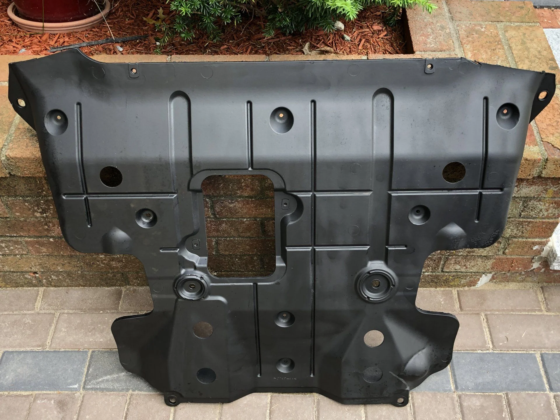

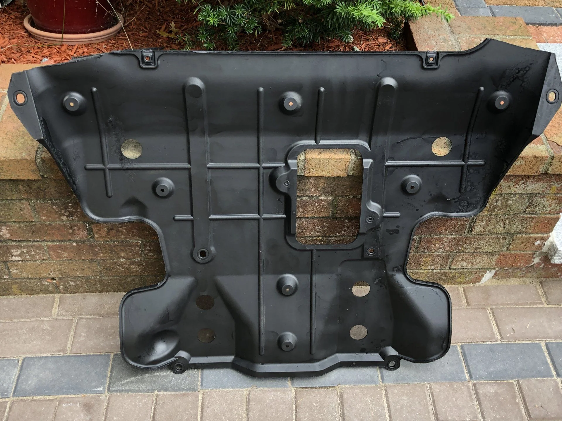

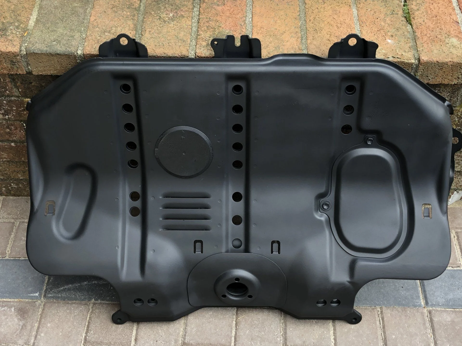

I had a look under my truck, and the front skid plate is gone enough (rust/rot) I am going to replace it with my “new” one. The tabs in the back of the front skid plate are gone, so nothing there to bolt the “COVER 2” on to anyway.

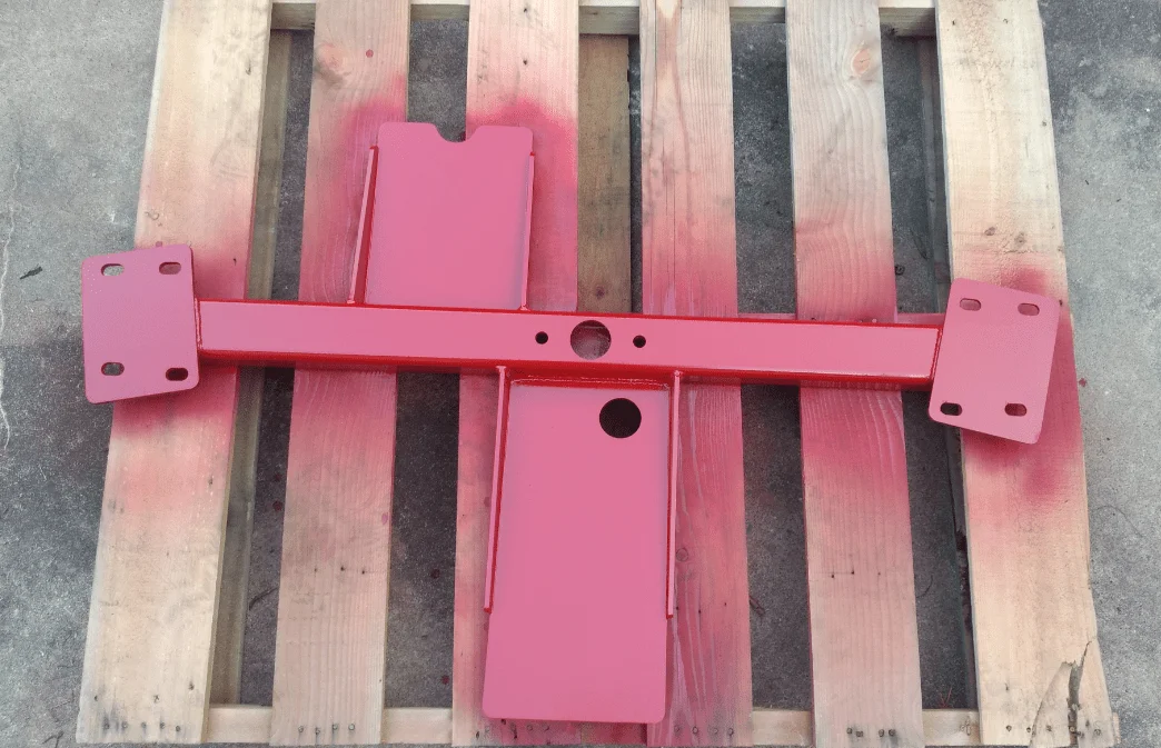

This morning my kids and I power washed my “new” skid plates, de-greased them, and hit them with rustoleum converter plus high heat paint.
I forgot to take some “before” pictures but they were caked in mud and grease, with some surface rust in a few small areas.
Here they are after the kids helped me clean and paint them
If and when these need replacing, I will upgrade to something better.

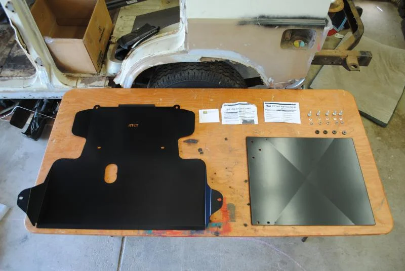

TJM makes a mid skid replacement that is made of steel and it’s decent for the price.

Check these TJM pics out from @2000UZJ and @Fitzgerald....
Holy smokes... The price is unbeatable. Great alternative to stock IMO.

Can you post a photo of your setup to show how they match up? A lot of the photos from the TJM skid thread have been dropped. Sounds like a good budget combo.
@rrc swb I think the 2nd one you posted is TJMs front skid replacement. Back when I got the middle skid from TJM this wasn’t yet offered.
TJM Front
TJM FrontView attachment 2420367
@SlowBuild , I’ll try to snap some pictures tomorrow and post them up.
You are correct. The name is want got me confused.
The one you posted is the front...

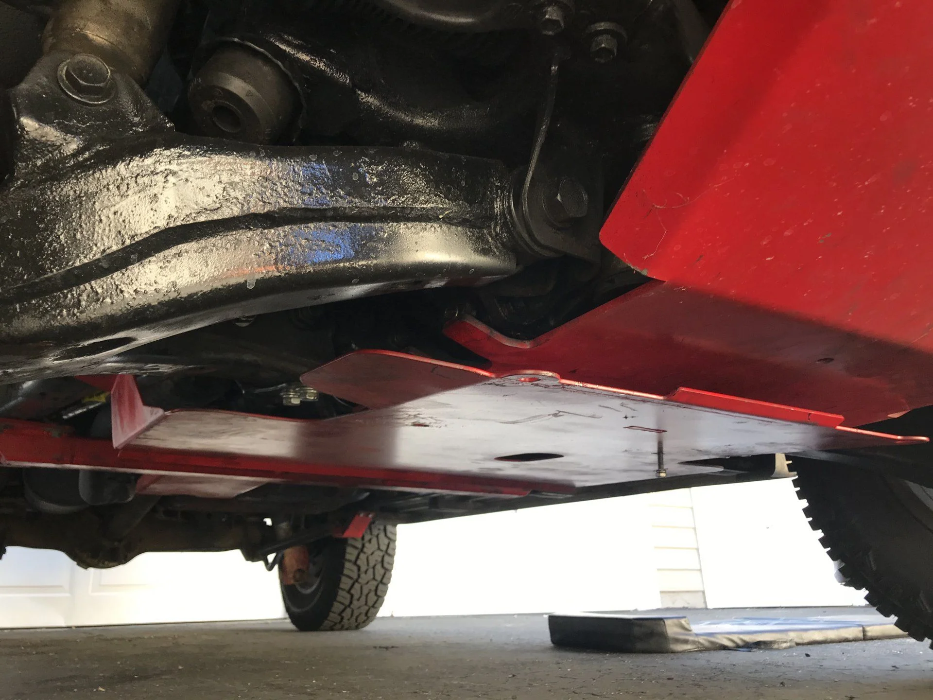

@Slashzero here is the rear of the TJM Middle (Sump guard) and how it overlaps with the transmission guard part of the Trail Tailor Creeper skid. Not in view is the skid part for the transfer case.
The rear skid from TJM requires the OEM cross member. I didn’t like it as it required test fitting and marking where to drill on the mid skid after aligning to the cross member. Then removing to drill and refit. Plus no added protection for the transfer case. The triplet set of holes is where the OEM t/c case skid is reinstalled.
In contrast the Trail Tailor creeper skid aligned perfectly and bolted right in, no need to widen any holes.

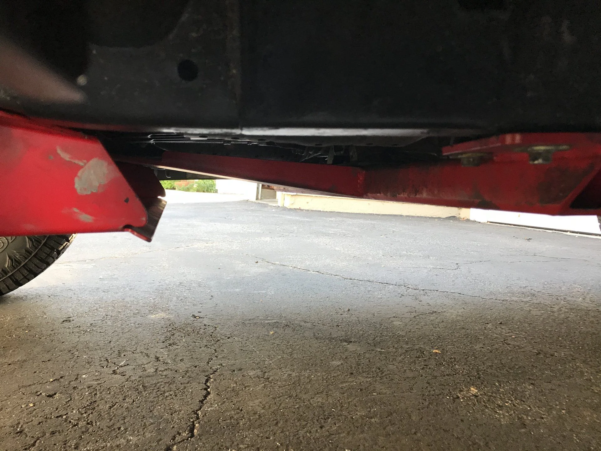

Thank you for posting the picture. I have the TT creeper skid painted red and ready for installation with a new trans mount.
When you installed the creeper skid, did you lift the transmission using a jack at the point where the engine meets the bell housing?
I have used that location to lift the engine when installing motor mounts.
No rusted bolts in the way of removing the old factory skid. This should be an easy installation. I'm just looking for a good place to support the transmission while I have the old skid out and replacing the trans mount.
