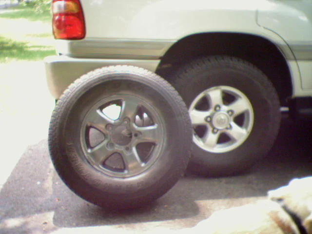

I played around this weekend. and Painted the spare. The graphite or gray color
What you think?
What you think?
What up with maskng tape?
DBrown2 said:
No time for masking tape, it was just a quick deal. That is what paint thinner is for. I just did a lite coat, to get a good solid color. To tell what it would look like.
In that case, do all of them. Any overspray on the body you can just clean up with paint thinner too. :rolleyes:

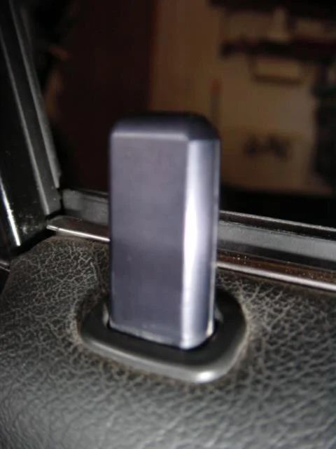

I machined some aluminum door locks for my car and had them hard-anodized about 10 years ago and they are fine, they show some fading and some wear, but they look good. (See pictures) I’m not sure how they would look after the same time out in the environments though.

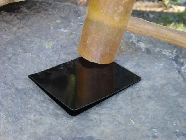

Tomorrow I will powder coat a “Q” test panel. I will take a picture of it before and after I hammer it into a flat fold/crease and then, undo it. After this, you will believe. :cool:

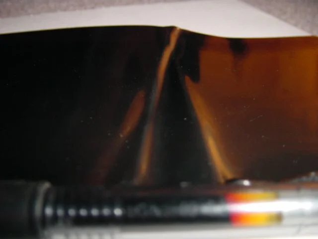

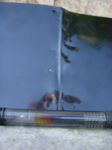

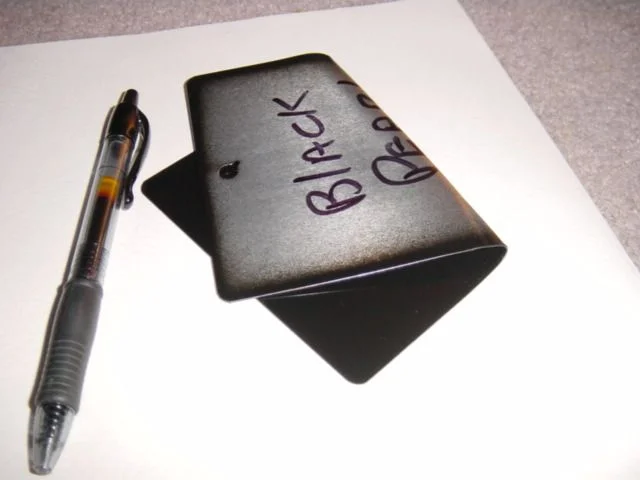

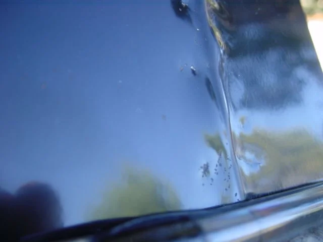

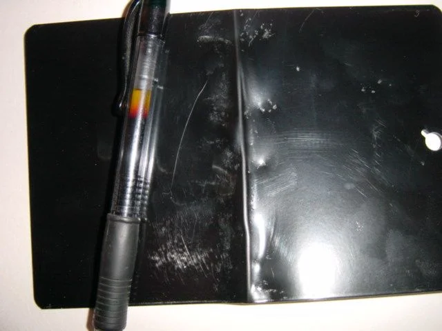

Here is a Q-panel that was powder coated. The powder coat is a TGIC (triglyceride isocyanate) color is pearl black, 90% gloss, UV rated.
If you look closely, you can see where the rock underneath caused some damage while hammering on it. :D But the crease is un-damaged other than surface scratches on the glossy surface on the side that I hammered (using a plastic mallet).
The next few pictures are of me creasing it back and forth by hand to eliminate the glare form the scratches caused by the hammering. Gloss will always show scratches. If you can think of anything else for me to try on some test pieces let me know.
Dean
More pictures
Here are more pictures of the hammering. Not any flaking of the paint on the crease. None.

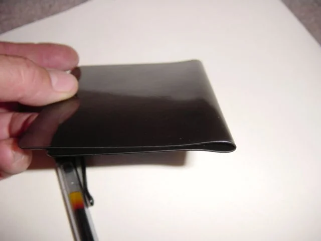

These are the picture of the hand job, uh…I mean the ones I bent by hand, to eliminate the glare I was getting caused by the flash.
