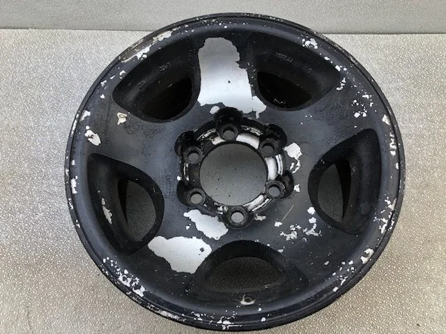

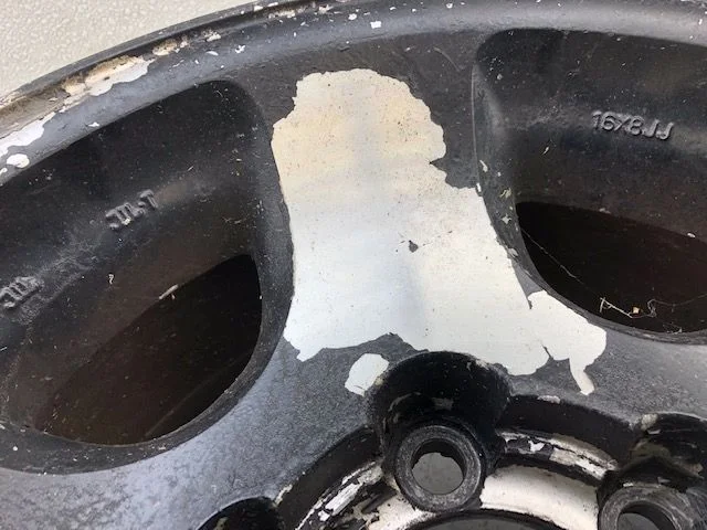

I have a set of 80 rims that look like they're very nice underneath the peeling paint.
Any product recommendations?
