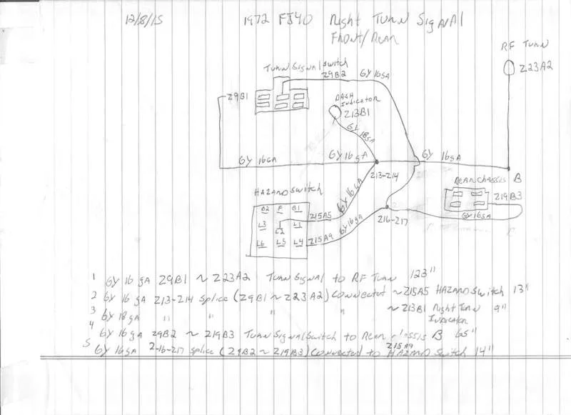

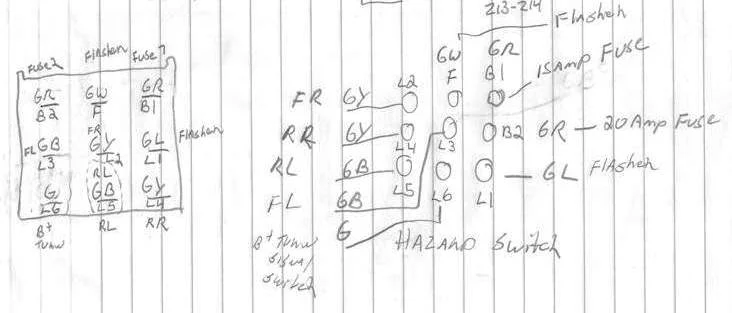

Please note that you have to add all the unlabeled wiring between the switches, flasher and indicator lights. This is where people get confused as nothing on the switches is labeled to help you.
Don't know if these will help you figure this out or not. I know they are terrible hand drawings but they are for me not for publication. 🤣
This is a 1972 Hazard switch pin out. Hopefully you cut off the mating pigtail from the old harness to make splicing easier?
1921409
This is the turn signal switch pin out.
1921410
This is a 1972 Left Turn signal switch hook up.
1921404
This is a 1972 Right Turn signal switch hook up.
1921406
