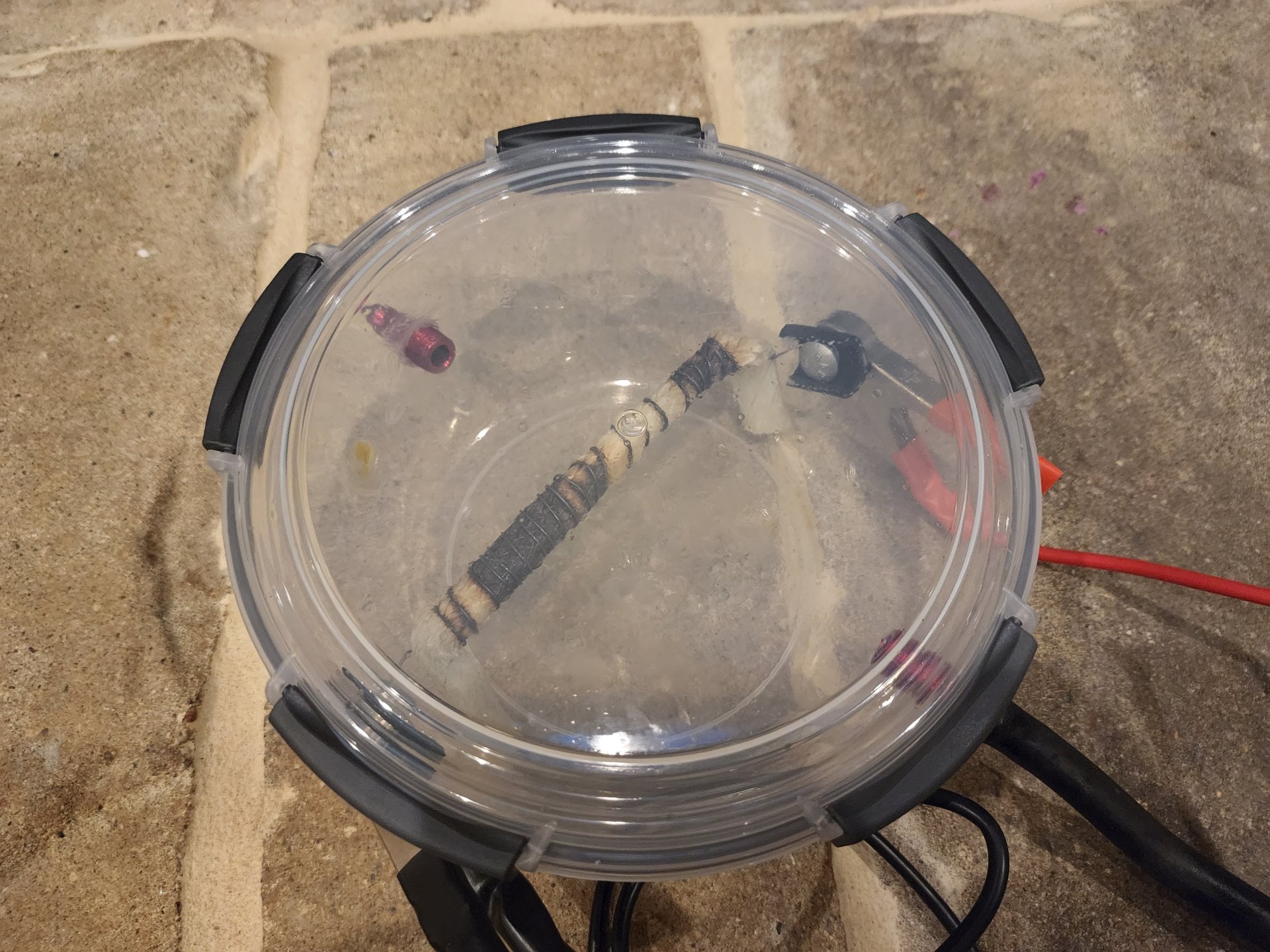

Ok so I made myself a DIY Smoke machine.. it was easy for around $15 bucks but I used tupperware lol... I pulled out the Evap plug (left one) after looking at the vacuum diagram and blew smoke but did not find anything major (there was very minor smoke from air box which is expected). So nothing major that I found in terms of a air leak.
Now I am going to find a fuel pressure gauge and make myself a DIY fuel adapter using this video here Fuel Adapter for Fuel Pump. So this will confirm if its not a fuel pump issue. Although I suspect its a fuel issue. I will follow up and let you all know.
BTW I'll get some pics of the Smoke machine when I get a chance. It worked great.

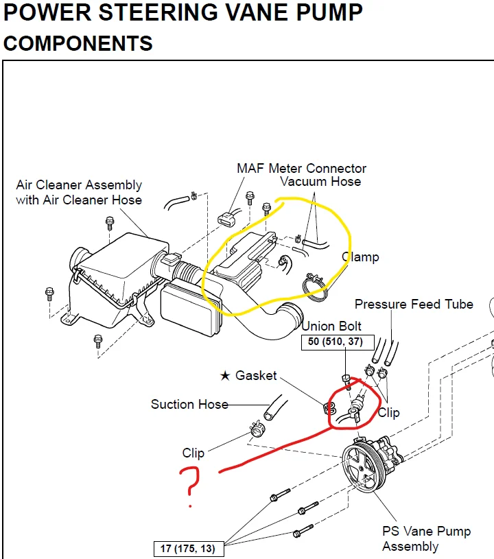

Did you check the 2 vacuum lines and niples on vane pump idle up controller! Those plastic nipples get old and brittle, broke a few just touching them.

1) Did I check the vacuum lines and niples on the vane pump???? Is the nipples on the Idle air controller valve? circled in Red in the diagram below? Do I just need to check that to see if they are going bad?
As mentioned I did a smoke test and found no air gaps, so nothing major was leaking air or taking in air Afaik.
Now when I did the Timing belt I had to take out the whole air box and take the 3 (iirc) hoses that from that circled in Yellow. I know I put them back on correctly. But I will just take the whole thing out again and put it back on and insure I did not pinch any hoses or anything.

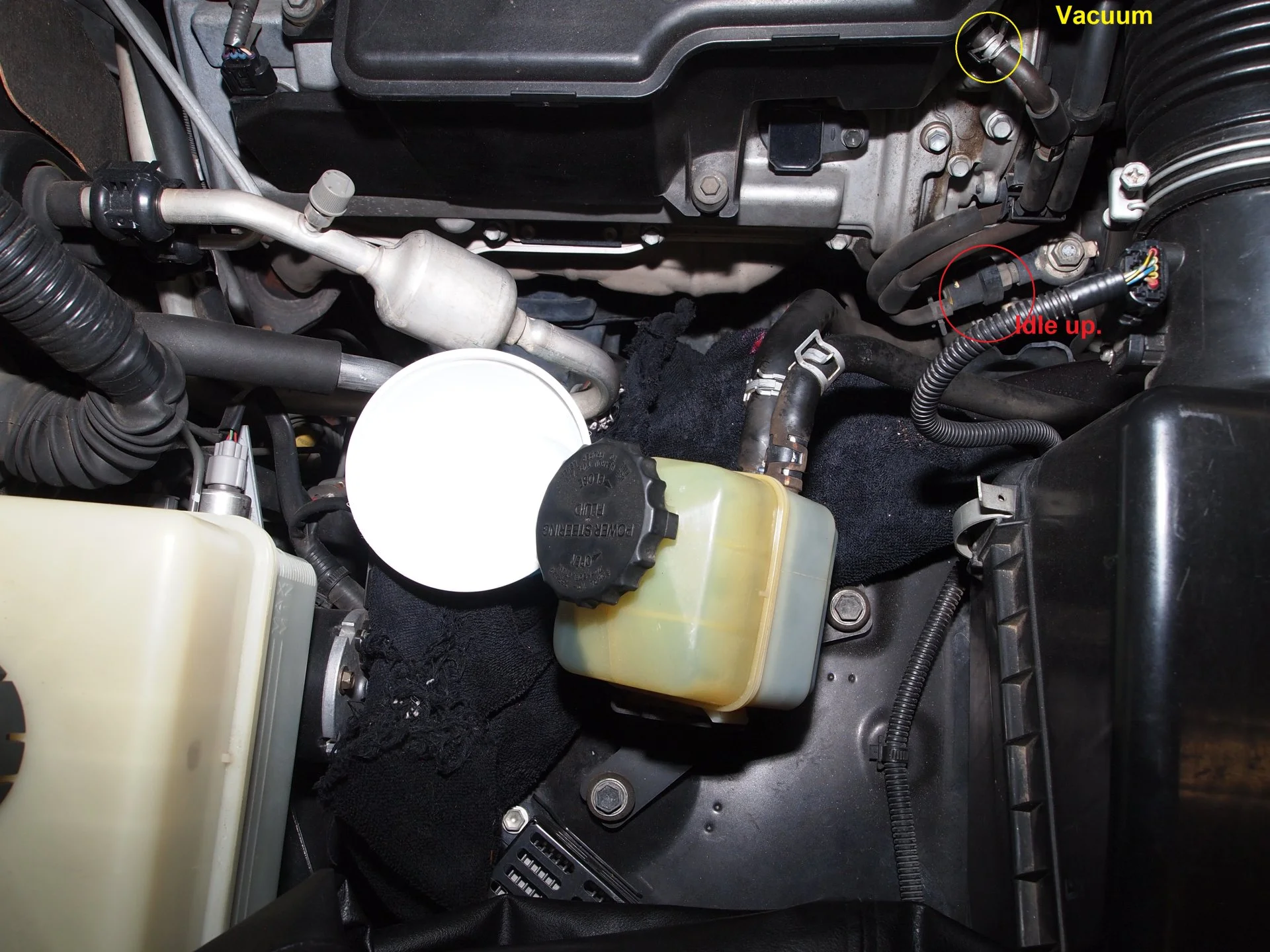

Yes you've circle in red. Here's picture of idle up circle in red.
@JunkCrzr89 posted a link for you. You'll see some of the 02 test there, with voltage specs. Basically I watch to see each side )bk1 & BK2 a/f & O2s) reacting the same or near same. As I adjust fuel trim to full rich than full lean. But highly unlike both bK 's a/f or o2 suddenly went bad. So it's more likely you've vacuum issue or mixed something up, as @abuck99.

I must be crazy.. i didnt see the Idle up tube that was just hanging there and not connected.. so much thanks to @2001LC and others. I plugged that monitoring my fuel trims and immediately noticed my fuel trims drop and the idea by a little bit..
The tube was hanging there and b/c of the angle I thought it was plugged in...and I countless times were tugging other tubes around the area.. so morel of the story.. check all and I mean ALL your daam tubes hookup dummy.. :). hehe anyways thanks for helping me out.

The good thing I got out of this is how to check for any leaks by making a DIY smoke machine (pic below).. BTW here are the pics album of the DIY tupperware smoke machine.
Come in handy when troubleshooting EVAP, O2 sensor, System too lean or rich (p0171, P0174 codes) issues quiet a bit. Here's the video I used to get the idea and components and adopted it for my own DIY tupperwhere smoke machine..lol
