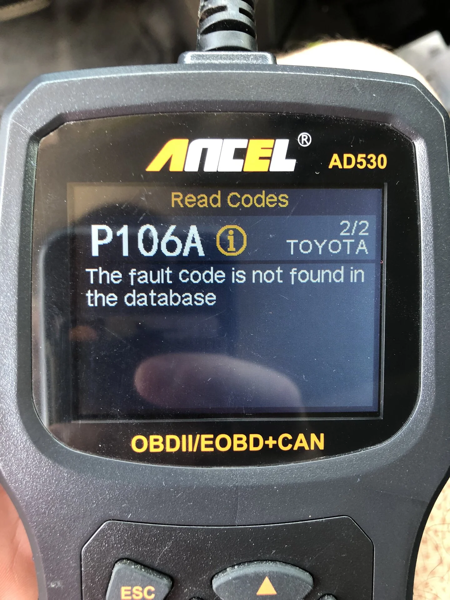

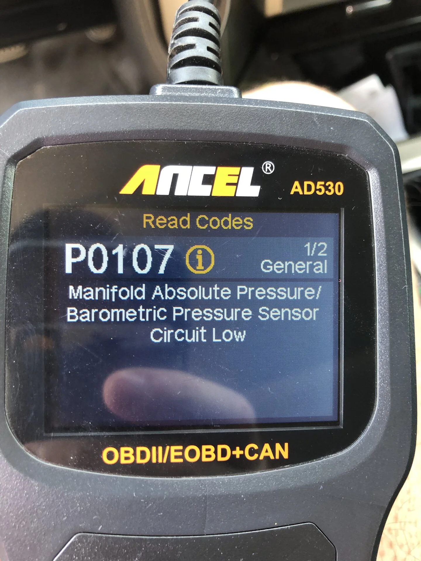

Got these codes a couple weeks ago and replaced the MAP sensor. The MAP sensor kPa is reading in the normal range as is the MAF and EVAP during idle and driving conditions. The codes did seem to appear out of no where after I did the breather filter mod for the SAIP. The SAIP itself sounds normal and doesn't seem to be dirty or clogged. I tossed the foam and end cap so I cannot return to normal unless I buy a new kit.
P106A is regarding the canister pressure sensor (vapor pressure pump?) not being within 7kPa of the MAP sensor. I cannot find this canister pressure sensor or the EVAP sensor for that matter anywhere.
What could be the culprit?
