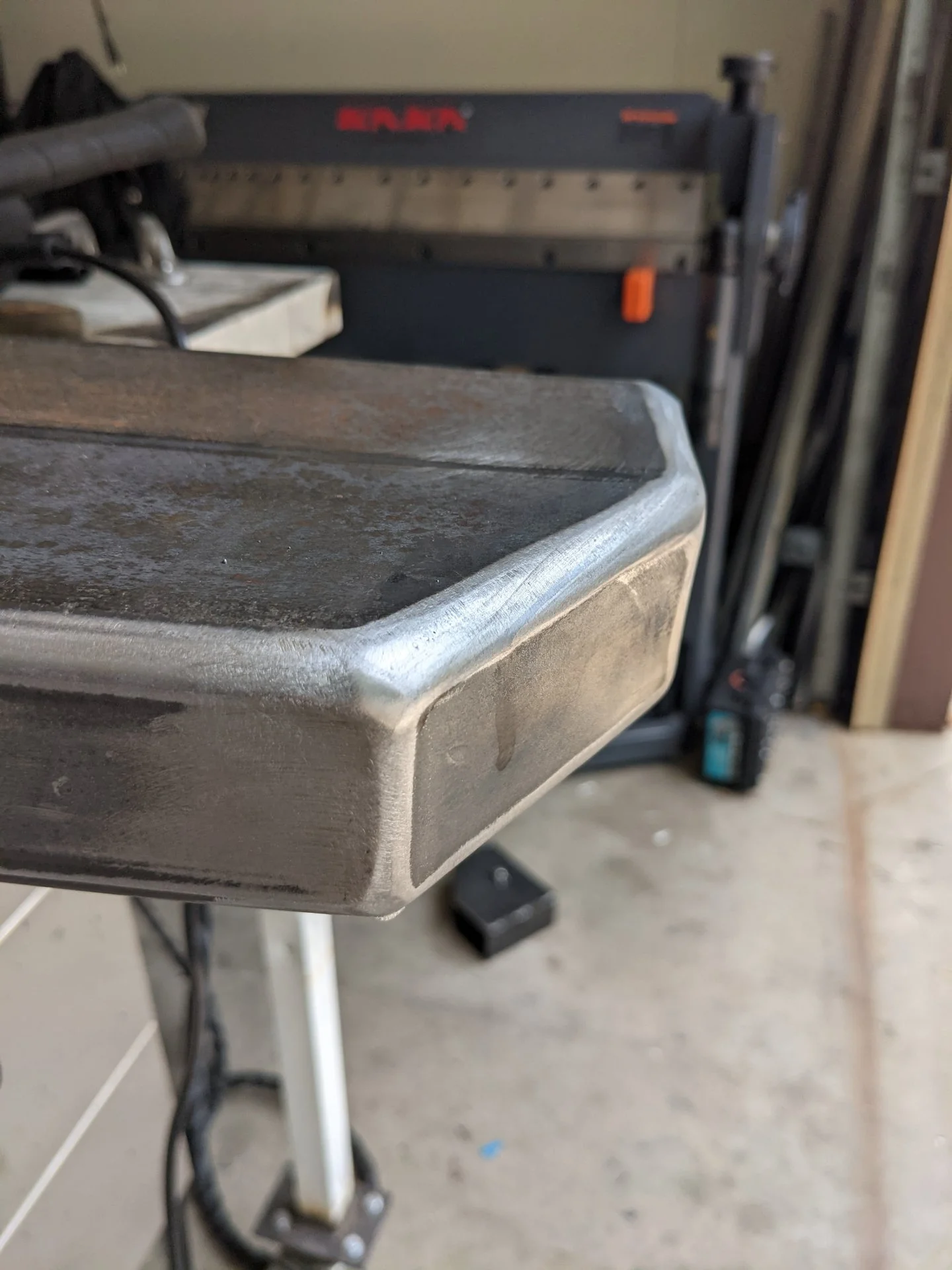

Working on a new way to weld the caps on the ends of the 2x6. The way I was doing it took about 2 hours to grind smooth per set. The new caps will likely have visible welds, but I'm working to make them look as clean as possible.

This is looking more promising. Took about 30 min per end vs an hour. I also learned from @89BIGBLUE that sharp edges aren't great for powder coating, so this would likely hold it better.

I agree. Same reason why ARB developed their “summit series” and rounded up the edges so powder coat is more resilient from cracking in the long run (apart from making it difficult for copy cats to manufacture/fabricate).
