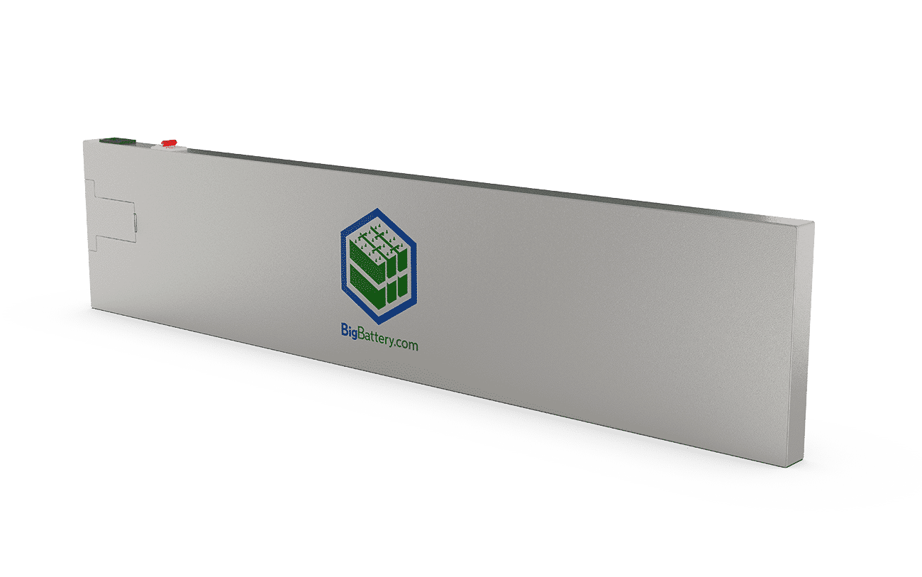

If I was doing my set-up over I would get one of these to mount to the drawer unit and behind the seats:
Other than the minimal space savings, I am not sure of the advantage of mounting any aux battery under the hood unless it is a dual battery to compliment the starter unit - not a house battery.
My Renegy LiPo is in the back along with the loads it powers and the DC/DC charger. its cooled by the rear AC when needed (or heated as the case may be)
