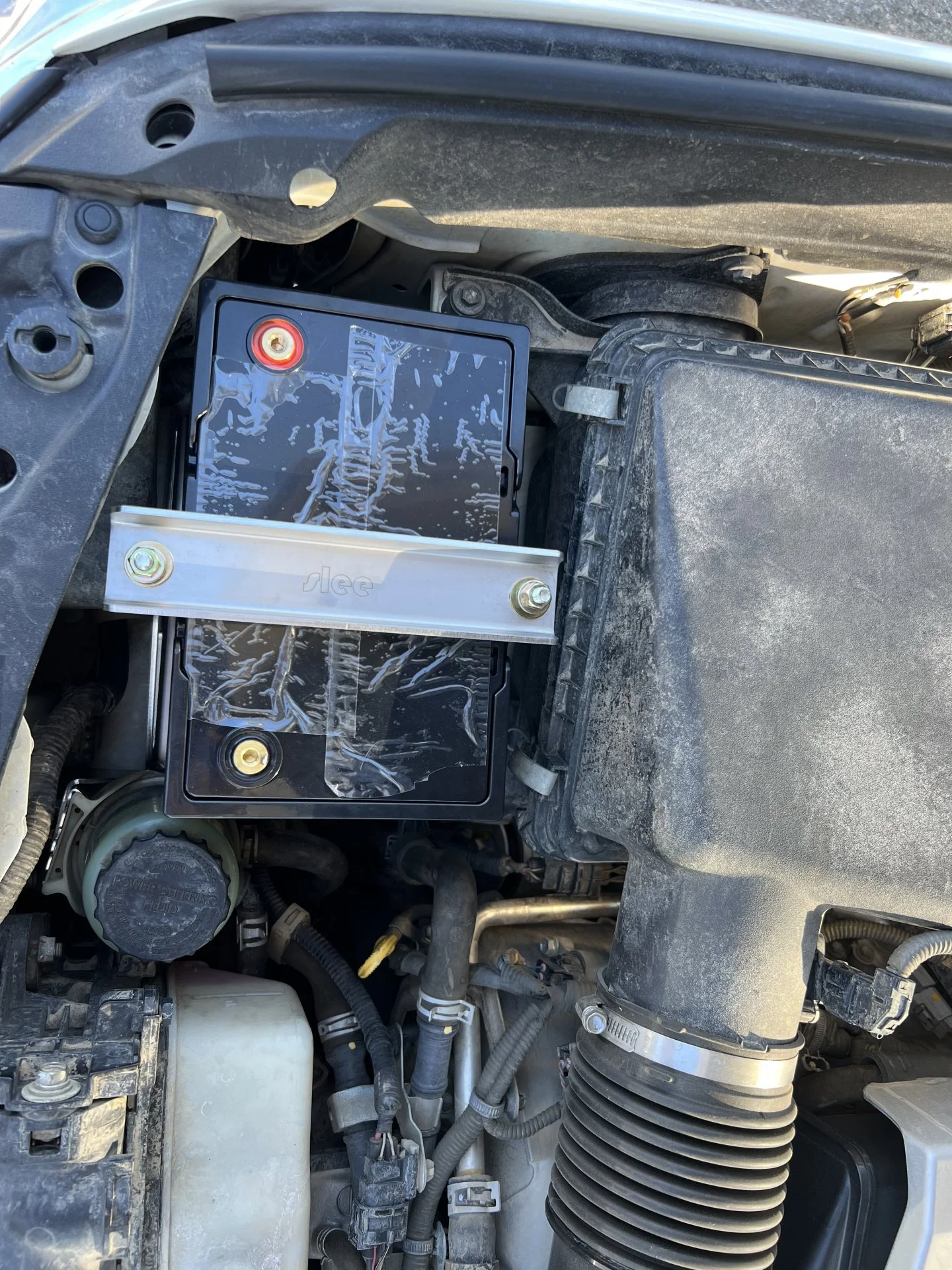

Here is a quick teaser shot.
Still working through the next steps.
Yes I know about the issues with running Li in hot and cold environments. The Aussies have had good success running them though.
Main issue with trying this is fitting a 100Ah battery in the tight space and I think I found the right combination.
A sharp eye may notice the scorch mark on the negative terminal. So…yes I can confirm the battery battery tie down bar does conduct electricity….🤦🏻

Kudos for the effort and it looks like you're doing some good work there. Not to take away from that, I'll still tell it straight.
This is arguable whether locating LiFePO4s underhood is a good idea. It will be weather and use case dependent. For someone that lives in hot regions and tends to do lots of low speed crawling over hours, I would advise against such chemistries under the hood. BMS or not, the hot environment would cause premature failure of the battery, all the way into potential fire risks.
This has also been true for AGM batteries like I've been saying for years that many now have experienced first hand. Sure, they might last 2-3 yrs, but that's surely not getting the value out of a premium battery.
That said, I think the forward location of the battery in the cruiser can help. Perhaps with a heat shield against the engine side, could make a difference.

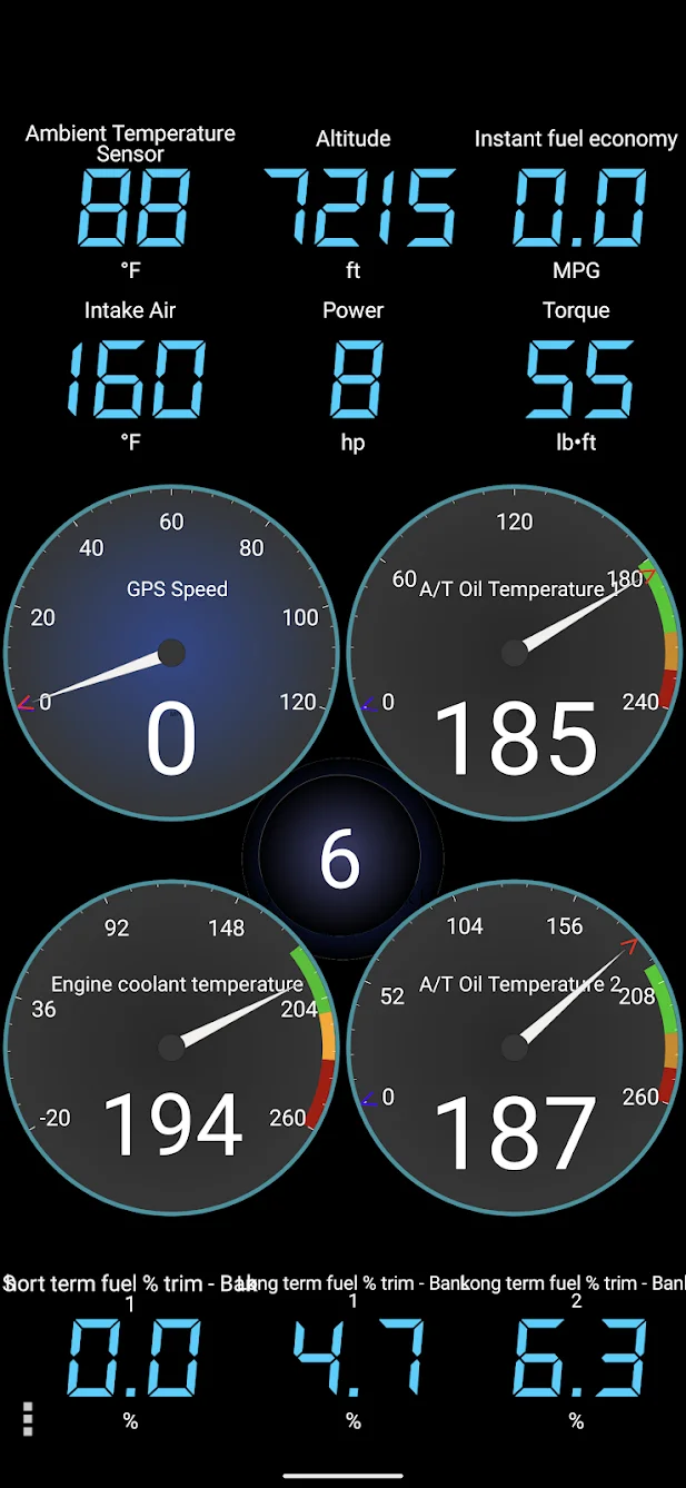

I thought it funny that this guy would conclude that all is good and well, based on a 75°C ambient temp. As your in LA, here in the southwest, ambient temps in the summer can easily be 105°F. So add a 30°F delta to his max temp results.
In the more interesting places in the desert, it's easy to go beyond that still. I can regularly see 160°F+ in off-road crawling in the engine bay area, from the intake air temps, which draws air very near where that battery is.

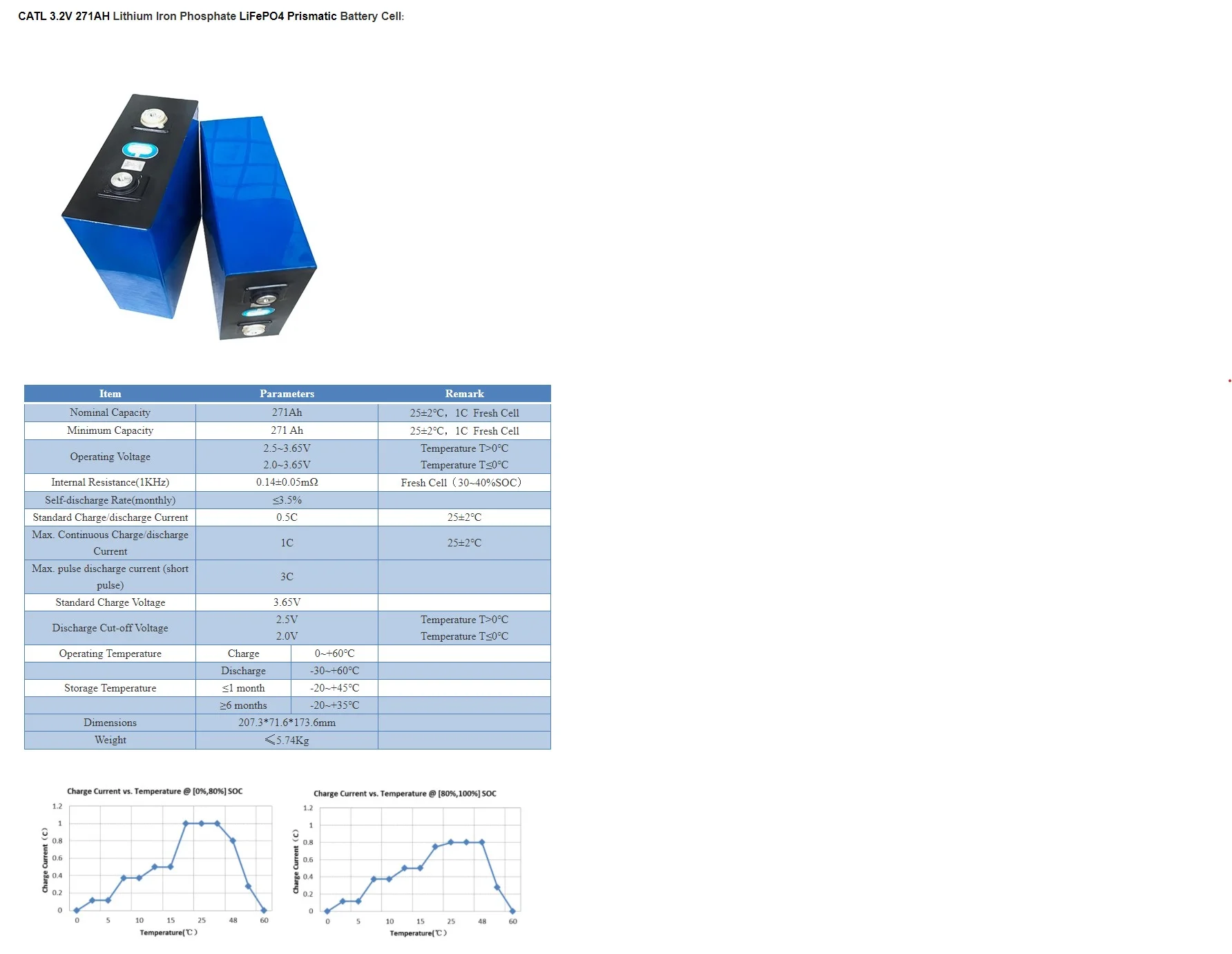

This is an example of the cells I used. Every cell is different, but LFP chemistry is all the same so they're not THAT different. 60C (140F) is the limit but notice how above 45-50C the charge rate drops off precipitously. There's a window where LFP works well - about 20C to 45C - and a larger window where it's ok and outside that you're paying a lot of money for the wrong use case. LFP is good for running a fridge for a long time if you can reasonably control the battery temperature, but it's poor for vehicle starting or heavy loads like winching, especially when you can't control for the ambient temps
FWIW I don't think you have to worry about LFP catching on fire just sitting under the hood, but a high ambient temp plus a high charge current can absolutely cause the cells to swell and burst. Also if you charge an LFP below 0F you will almost certainly kill it after the first charge. Lots of lessons at Up in smoke... learn from my mistake! - https://diysolarforum.com/forums/up-in-smoke-learn-from-my-mistake.83/
