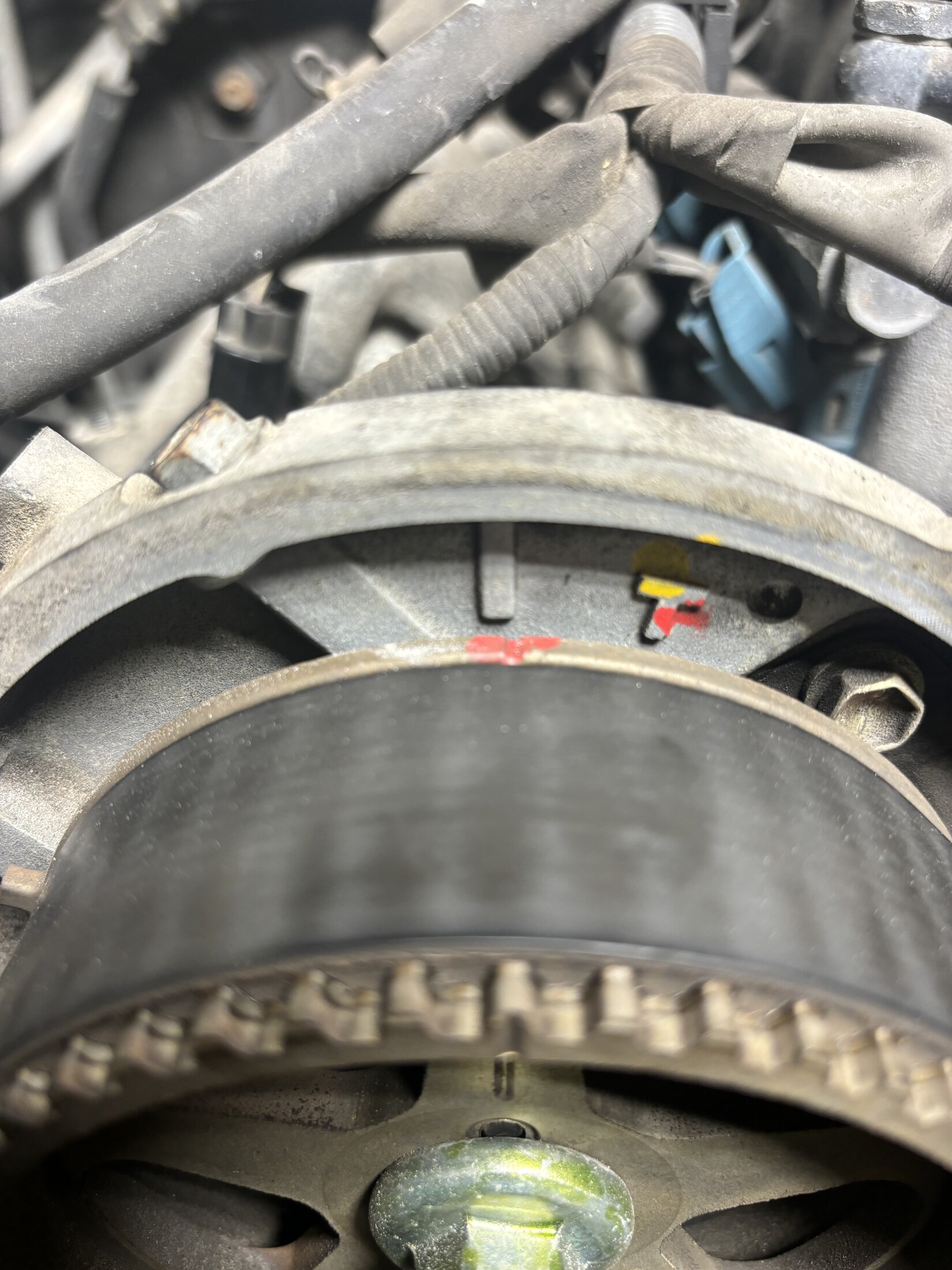

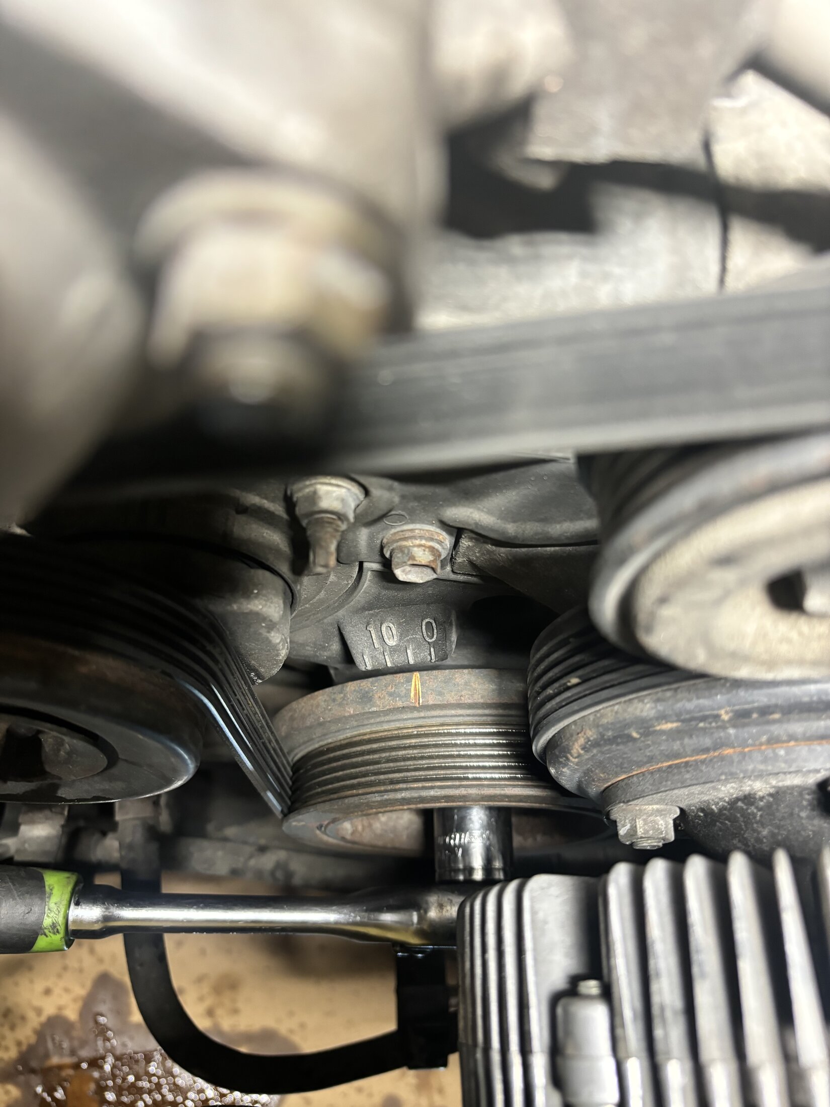

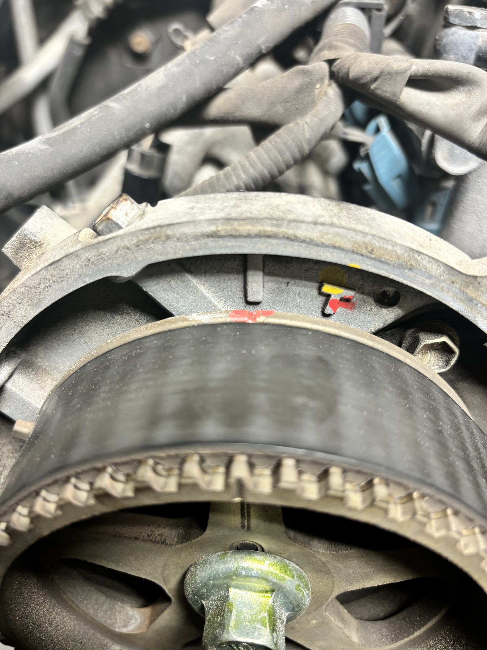

I didn’t notice the temp gauge till it was hot quickly through on the heat and it came down to normal 2 min later power loss and car cut off while driving 60mph I took the passenger timing cover off and this is where the timing marks land
That’s the crank at 0 looks a little off to me

This is with the cam lined up perfectly the crank reads 5 degrees off

timing marks look fine, must of got really hot unfortunately, you can take the valve covers off and watch the valves, may find something there but prob need to rebuild/replace the motor if your confident in your compression test, you can do a leak down also to double check.
