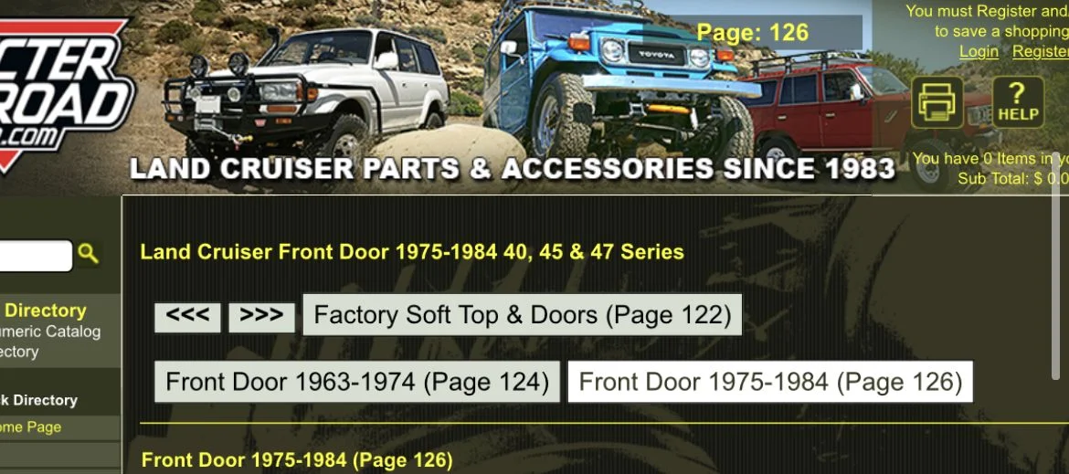

Curious, how are those doors not from a 75? Mine are identical
am not sure either. 1975 was the first year with that door, confirmed by SOR
they have the later mounting location for the mirrors......75 and 76 the mirror mounts shared the upper door hinge mount.....later doors had the three weld nuts behind the hinge
