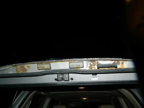

Hello,
I've been searching far and wide for a cruiser There's one just a few miles from my house that looks like a potential. 2002, 129K miles, mechanically sound....but......has rust.
Here's a picture of the lower quarter panel, near the running board by the rear wheel. Also, the hatch has some rust and there's a spot on the pillar (passanger side) rear.
In comparison to other trucks, is this rust bad? Is it fixable? I've had people say sand it down and paint it. I've also had a body shop say they wouldn't even work on it. I'm confused now!
What say Mudders?
Thanks!
Todd
Rust never sleeps. It is like cancer(metal cancer) you don't want it. Buy one from down south somewhere.
Being from CO. I don't really know what rust is but to me that looks like a bad sign. It would be typical of a 20-30 year old vehicle out here. The darker spots look like it may extend beyond the surface, If that has happened, sanding and painting won't help and it will spread and keep spreading. If it is truly limited to the surface than your sand/paint idea may work. Personally I've never seen a 100 that looks like that. Plenty of 60s and 80s but never a 100.
Next!
Seriously - run from that one. I'd rather have a rust-free 100 with a locked up 4.7!
RUN FAR AWAY unless you will drive it on salt roads and let it rust away anyway
Is that truck in Illinois? I looked at a 02 in IL a few months back and that was the reason I didn't want it.
The hatch rust is normal in the rust belt. That actually can be repaired pretty easily and isn't terrible expensive. It will come back in a few years though if it stays in the rust belt (especially if you don't wipe it down regularly). The one spot near the running board is what I don't like personally.
Patience is a virtue...Run and wait, you will find the perfect one.

I wonder if the upper rear hatch is prone to rusting. My rig is nothing like that, but my bolts have a bit of rust on the top of the hatch. The bolts on the lower half are pristine.

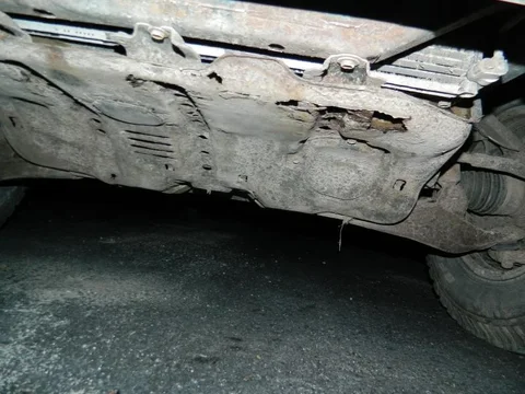

Umm... speaking of New England... Vermont is brutal... :bang:
The tail gate is my fault i didn't notice the gasket was a goner, but anything else is due to the ridiculous amount of road salt they use in Vermont. Like others before me stated forget that one and buy a southern cruiser its going to save you money in the long run.
