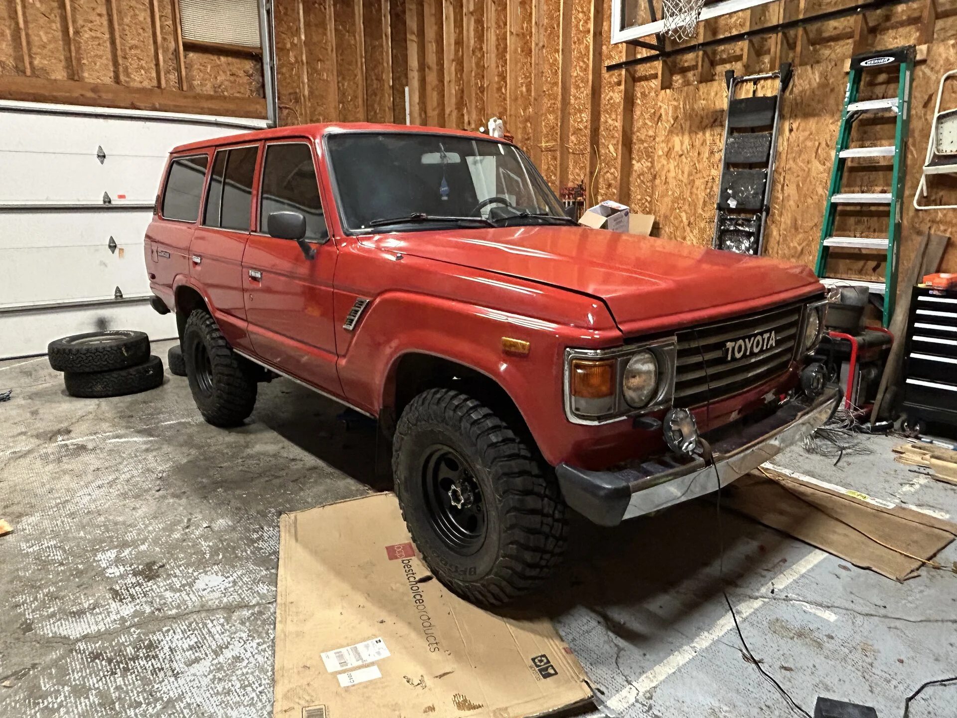

I ran some mud tires but mostly did a lot of highway driving and dirt road driving where mud tires aren’t needed.
On a few hill climbs, the mud tires definitely dug in deeper and got me over the top where an all terrain tire would have lost traction.
But I wasn’t happy with all the noise they made on the highway so I didn’t buy them again when I needed new tires. Went back to All-Terrains

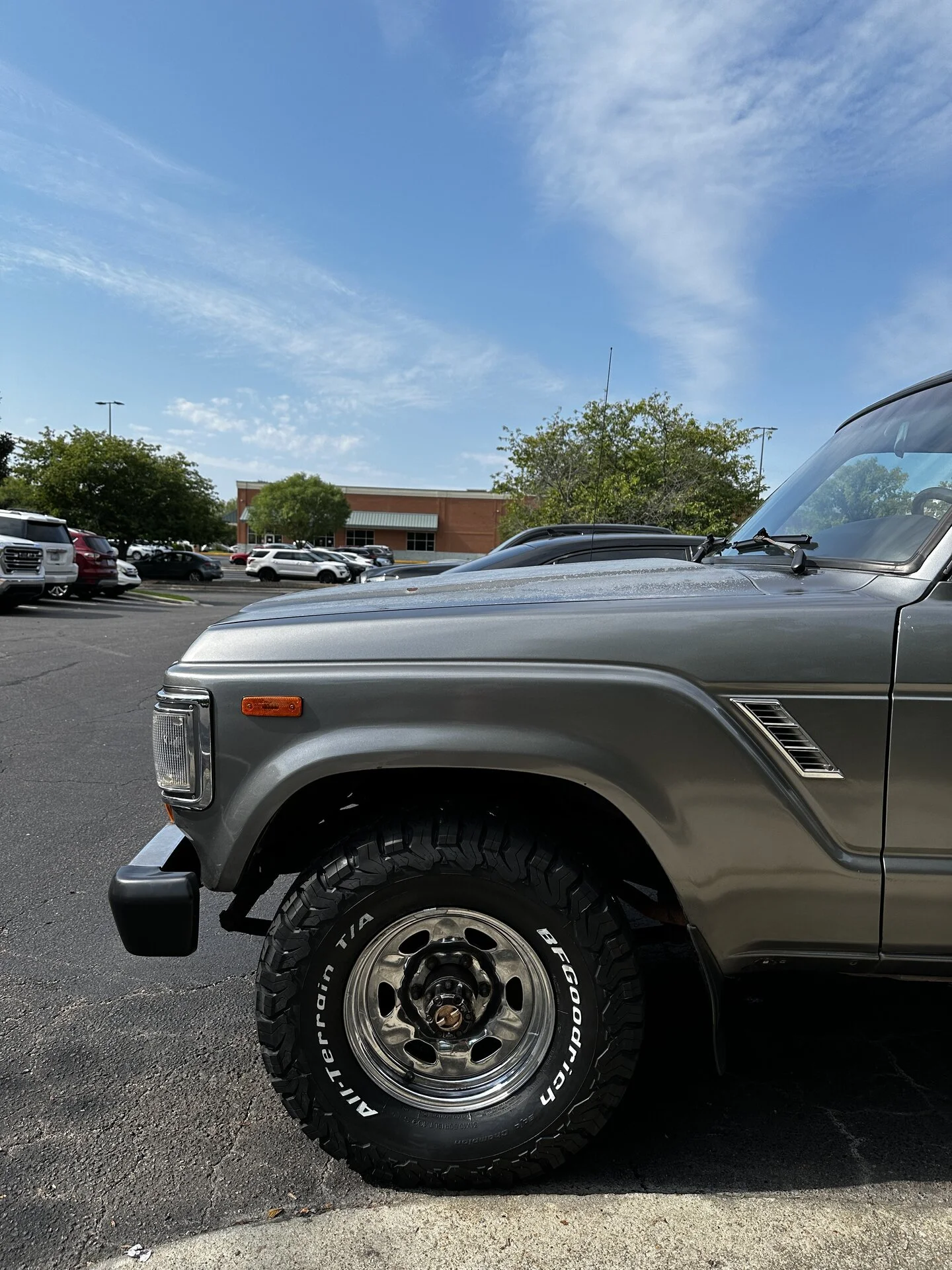

I went with OME from Cruiseroutfitters some years back. I always thought they should have come from the factory with the stance and lift/look it gives the truck. I run BFG AT 33's and I think it looks just right, the ride is just as good as factory, not too stiff. Give Kurt a call!

My setup is KYB Gas-A-Just shocks at stock height + BFG KO/2s 10.5x31, this has gotten me almost everywhere even with a non-engaging front axle for most of it. I stick with 31s since I had my rear diff rebuilt with stock-ish tires and height in mind. IMO, if you're in north GA for any trails, you will need a regear to run 33+. Our mountain highway slopes are much more severe of an angle than they have out west because the roads were graded before we learned about modern road building techniques.
I would start with a fat 31 AT and see if that gives you the look you want. BFG KO/2s rule this segement with Goodyear Wrangler Duratracs being another good option. You need a good amount of tread block siping for this truck to be safe on the highway with water and that's why an AT is a good choice. We don't have ABS, so wet tire traction is key. Mud terrains make more sense for dedicated trail rigs in locals like Moab or Florida swamps.
