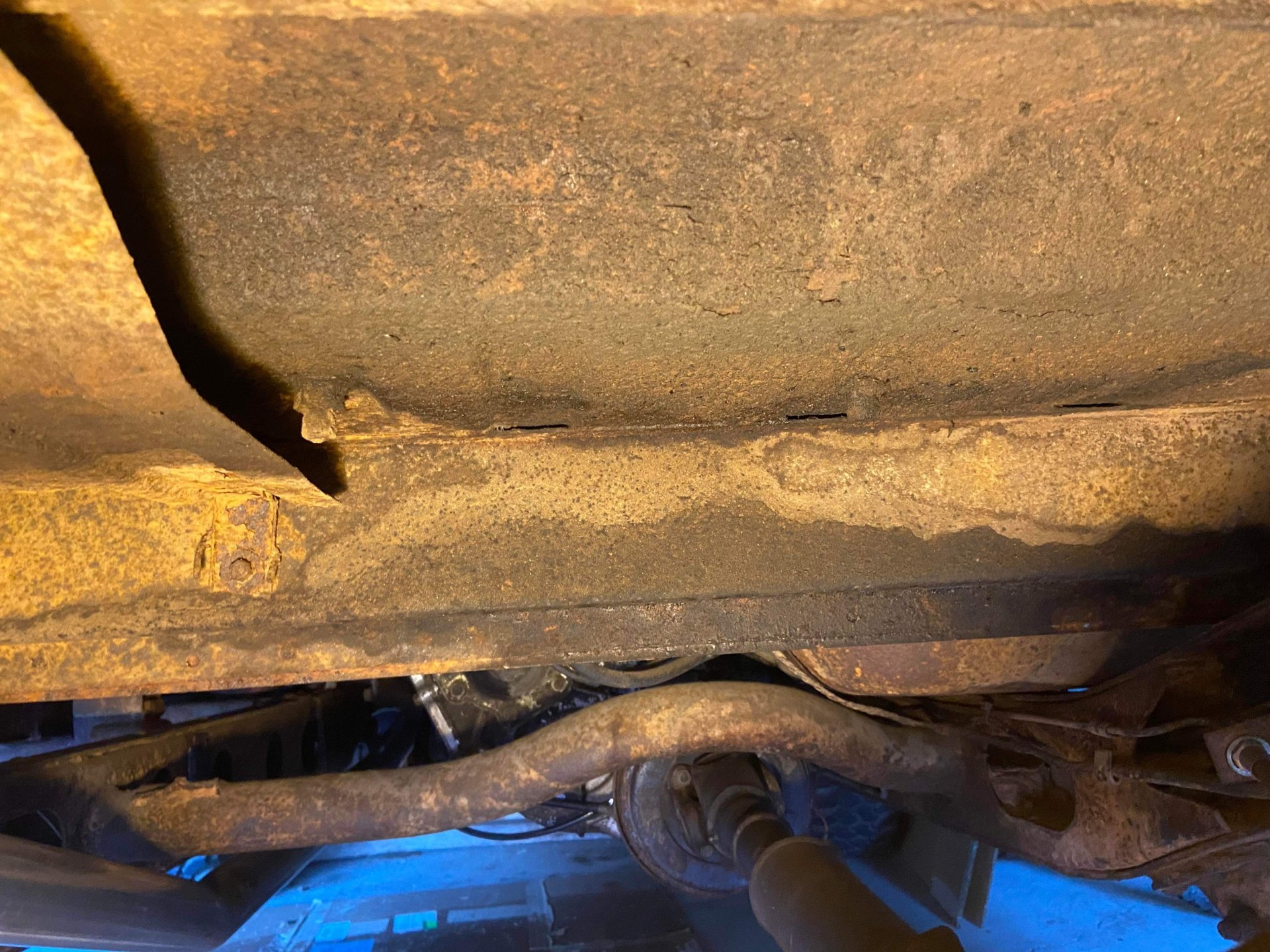

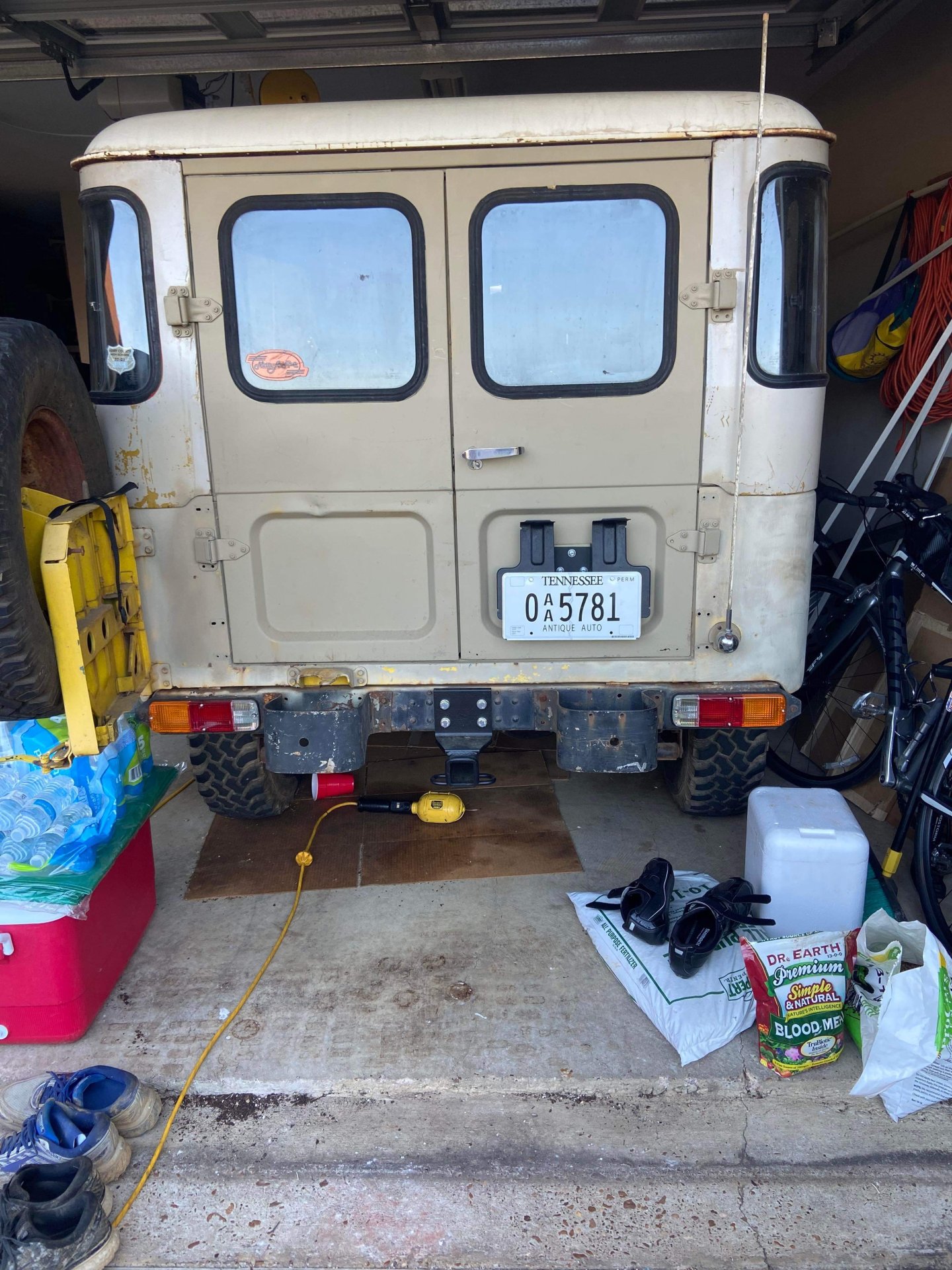

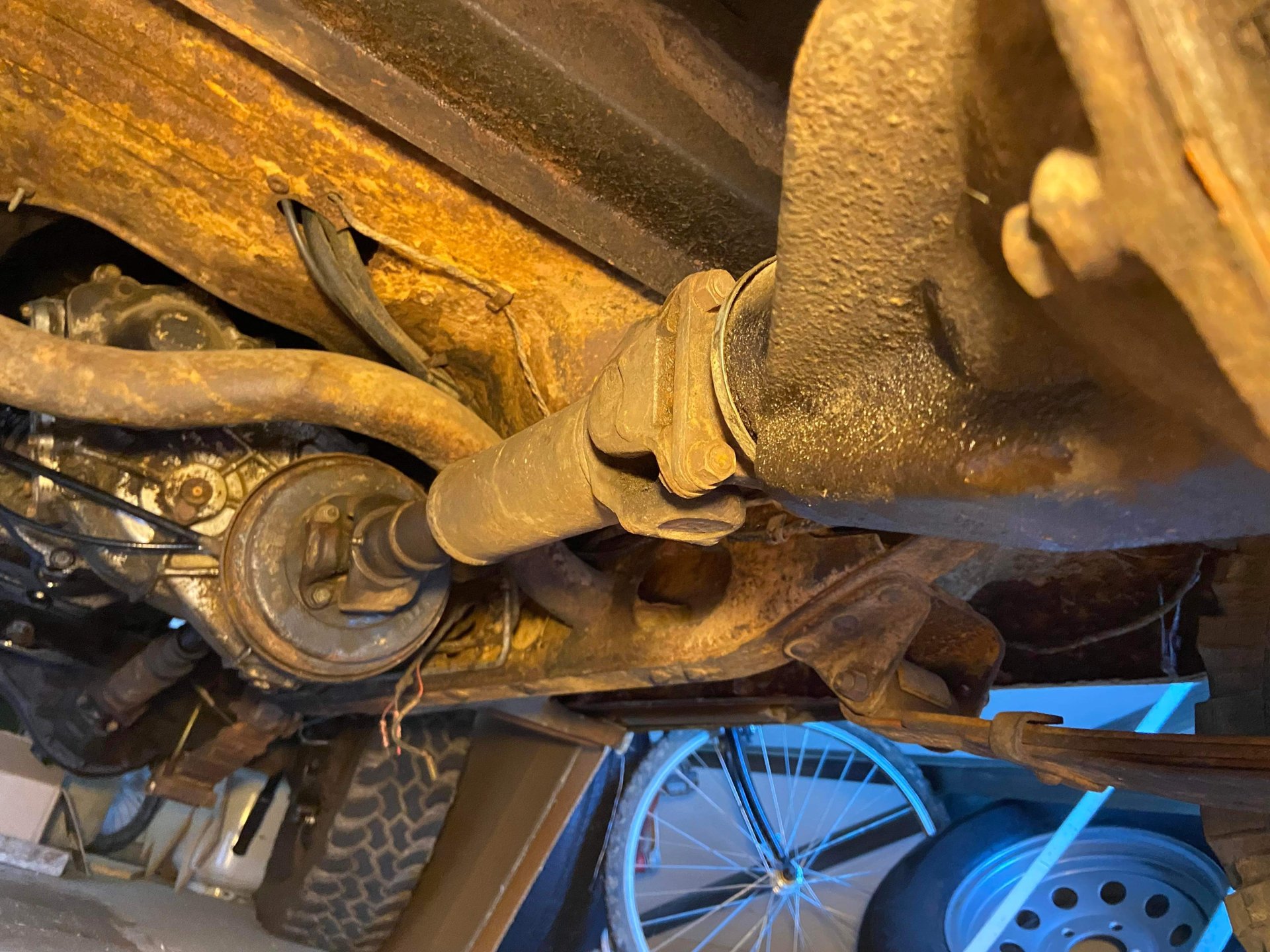

Any opinions on this 40 would be appreciated. It says 75 but there are a lot of things that look like a newer 40. Thank you
The seller also sent some more pictures. I wanted the club’s input before I go any further.
Looks decent for $11. To bad someone sprayed over that mustard...under the hood appears rustic green. Body looks pretty solid from the pics.
75 seems about right to me. Disc conversion, tank still under seat, etc. Definately rust on tub as seen from below, but I have seen much worse.
hard top is a 78ish (rear kick out windows were not avail in 76), not bad for the price. Little elbow grease and she can clean up a lot. that is a 75 tub given tire carrier on Drivers side and not a tubular version.
