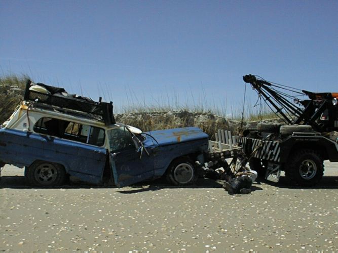

The Tacoma SNAP!!!
Or in this case, a wagoneer

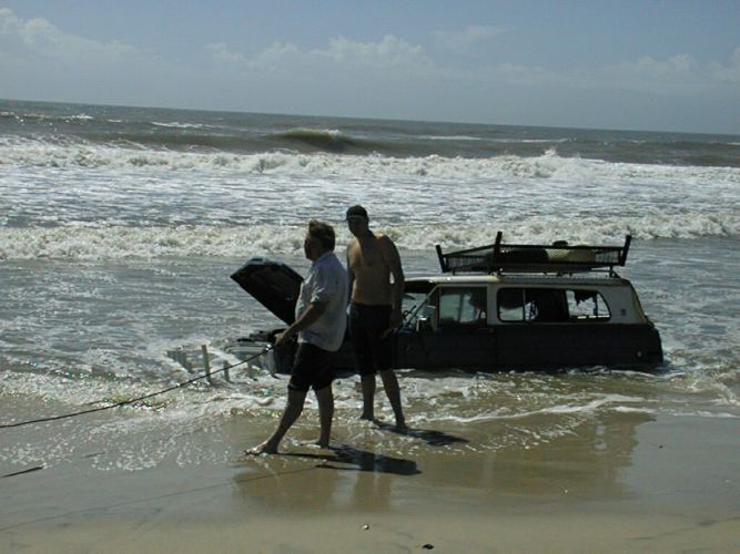

Granted, it was more than just a little stuck....
What force is involved in doin this???

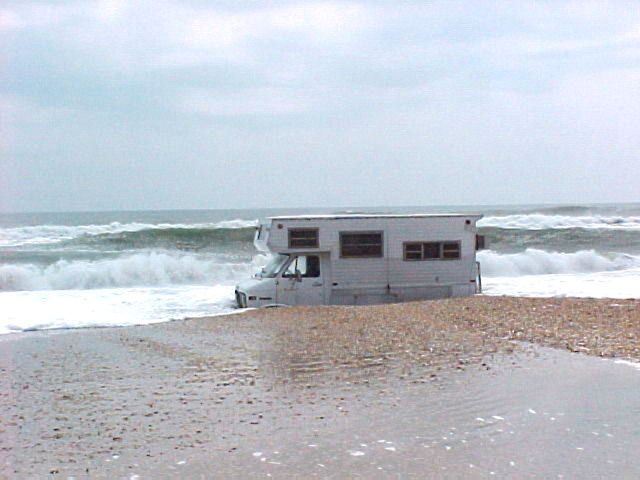

Trucks arent the only victims...Modified camper vans get hit too...

Those were sometime in the 2000's at Cape Lookout, where Lincoln did his report from.
The Cherokee was 1999, the van was sept 99, after Dennis hit the island.
Typical CALO extraction...just to get this tow truck onto the island is $750.00, because you have to rent the entire ferry to get it over. Theres a pic somewhere of it hanging the front wheels in the air. I just cant find it.
