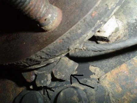

When doing my rear brakes, the parking brake cable was run like in the pic. But it looks to me that the cable should be on this swivel/pulley. Both sides were like this. Should it be on the swivel? If not, what purpose does this swivel serve?

Thanks mbb..............very helpful!!
You'll probably find that the two crimped barrels move around, or that the coating on both sides of them is worn away. I tried fixing mine with black electrical tape, but it didn't work. New cables are available and fairly cheap.
