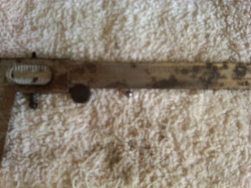

I stand corrected, I assumed it was non-ferrous due to the mag drain plug and or plugs not picking it up. I was wrong. I placed a small magnet next to it and sure enough, it went right to it.
I measured it and it is 5/32" in diameter. I snapped a photo with my phone but it did not turn out to well. As far as being a roller, needle or any other type of bearing? I'm not sure. It is completely spherical with no signs of wear or nicks.
I checked my tools thinking it may have came from a rachet or extension but all the bearings there are accounted for and I havenot done any recent bearing work of any kind so contamination from my tool box is unlikely.
I also just drove about 10 miles at 55 mph. Stopped and touch all the hubs and none of them were hot. In fact they were surprisingly cool. I guess that 80W-90 is doing its job.
Pardon my ignorance on this matter but is it possible that this bearing came off a drive rachet or extension that may have been previously used in the diff or transfer case? It looks to be to small to come off a half inch drive. Would a small sized wrench be necessary for rebuiling the diffs?

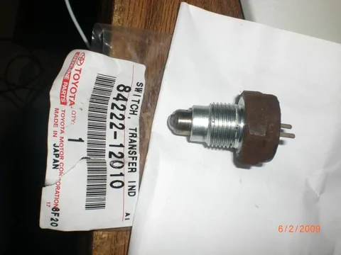

That explains why my front diff lock was extremely stubborn to engage recently. Is there anything else I should be aware of before I rebuild my front axle! I.E. can I drive it the meantime just without engaging the diff locks? Or is it benched untill I can repair?
FYI
This is actually very easy to repair. I think replacement switch is around $15 and should be available at Toyota dealer.
Takes maybe 10 -20 minutes to replace it, depending how stubborn old switch is. When you look on main locker cable coming down the frame cable splits smaller plug is going to the switch. Just remove it to confirm it. There should be spring in it too so once you remove it you will know what else is floating in the diff I will take pic of my broken one but you will see the internal part. If you missing only ball then you should be able to drive with it.
doesn't "bearing" usually refer to the entire supporting part, which would include many bearing "rollers" or "balls" for those types?
If so, what you have there is one "ball" not a "bearing".
Here is my old switch. Two connectors you see on the back should be under the plastic which broke off.
Part number is from my new switch.
Thanks for the info RedTacoma & the pics. E9999 I believe that you are correct. Bearing was the first thing that came to mind. I never would have thought that a small 5/32" ball was part of a switch.
