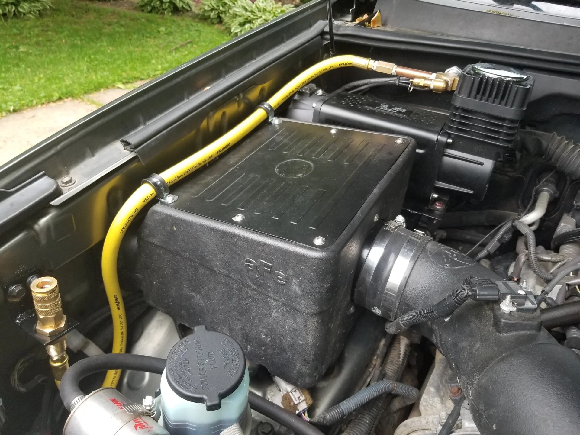

If you have the money, I might go with the ARB initially. I have no delusions that my modded Smittybilt will be as reliable as an ARB. After a year-ish of use, it's working great. I used the $400-$500 I saved on a 4-tire inflation setup and other mods I needed at the time. When it craps out, it should be relatively easy to swap in an ARB. I'm thinking of it as a cost deferral rather than a waste of money at this point.
There are a couple posts in my build thread starting here: Sheptastic 2015 GX460 Build - https://forum.ih8mud.com/threads/sheptastic-2015-gx460-build.1282907/#post-14418311
I have a Smittybilt 2781 (was $170 last near but is now $220-ish) with a DIY bracket and hard-wiring to the battery, with conversion to a normal 1/4" QD chuck. I have maybe $300 in it total. I can inflate all 4 of my 32" tires from 18 to 32 psi in just over 5 minutes. I've also inflated up to 2 other rigs right afterwards, though when its warm the compressor has required a 5 minute rest period after tire 6 or so.
I honestly doubt an ARB would be must faster at all since they are both rated ~6 scfm. For the amount I use it (monthly or so), it works great. If I was wheeling more often, or if the Smittybilt craps out catastrophically, yes I'd get an ARB. But I'm not, and $600 is a lot for a tool that isn't used all of the time.
See install information in my build thread. It's for a 470 instead of 460 but most of the same concepts could likely be utilized.

I had to buy an adapter from the cylinder head to normal NPT fittings. I think it was around $12. The info on the adapter is in my build thread linked above. Everything beyond the cylinder head is all normal hardware store stuff. The Smittybilt route works best if you don't mind disassembling and modifying the compressor to get it to work, plus building the bracket.
If you'd rather have an off-the-shelf option, get an ARB and pre-made bracket (but you'll be in at around 2.5X the total cost of a Smittybilt that is just as fast).

This from Amazon got me to 1/4" and it was standard air fittings from there: Fitting Adapter 1/4” Male NPT to M12 x 1.25 M12X1.25 Male

That's the one. Amazon links don't always display on my phone, so I just used the description. That got me into a 1/4" stainless tee where I added a pressure valve and a 1/4" chuck for my 4-tire hose system. I believe I got that part from Jake's video, or some other mod video on YouTube. This post shows it installed under the hood: Sheptastic 2015 GX460 Build - https://forum.ih8mud.com/threads/sheptastic-2015-gx460-build.1282907/#post-14459701.
Looks like @Rednexus used a different pitch for his adapter. I went off of the pipe at the end of the handle, rather than straight off the cylinder. Maybe that accounts for the difference?

Most likely that is the difference. Honestly, it's a pain to take apart the compressor to remove the handle, the only reason I went that way is because I broke off the factory pressure relief valve on the Smittybilt when trying to remove it to install a tee so I could add a 100-psi shutoff switch. So I removed the whole handle as it was a pain to try to extract the broken off relief valve. If I were to do it again, I would have cut off the OEM hose and added the shutoff switch at the end of the handle.
