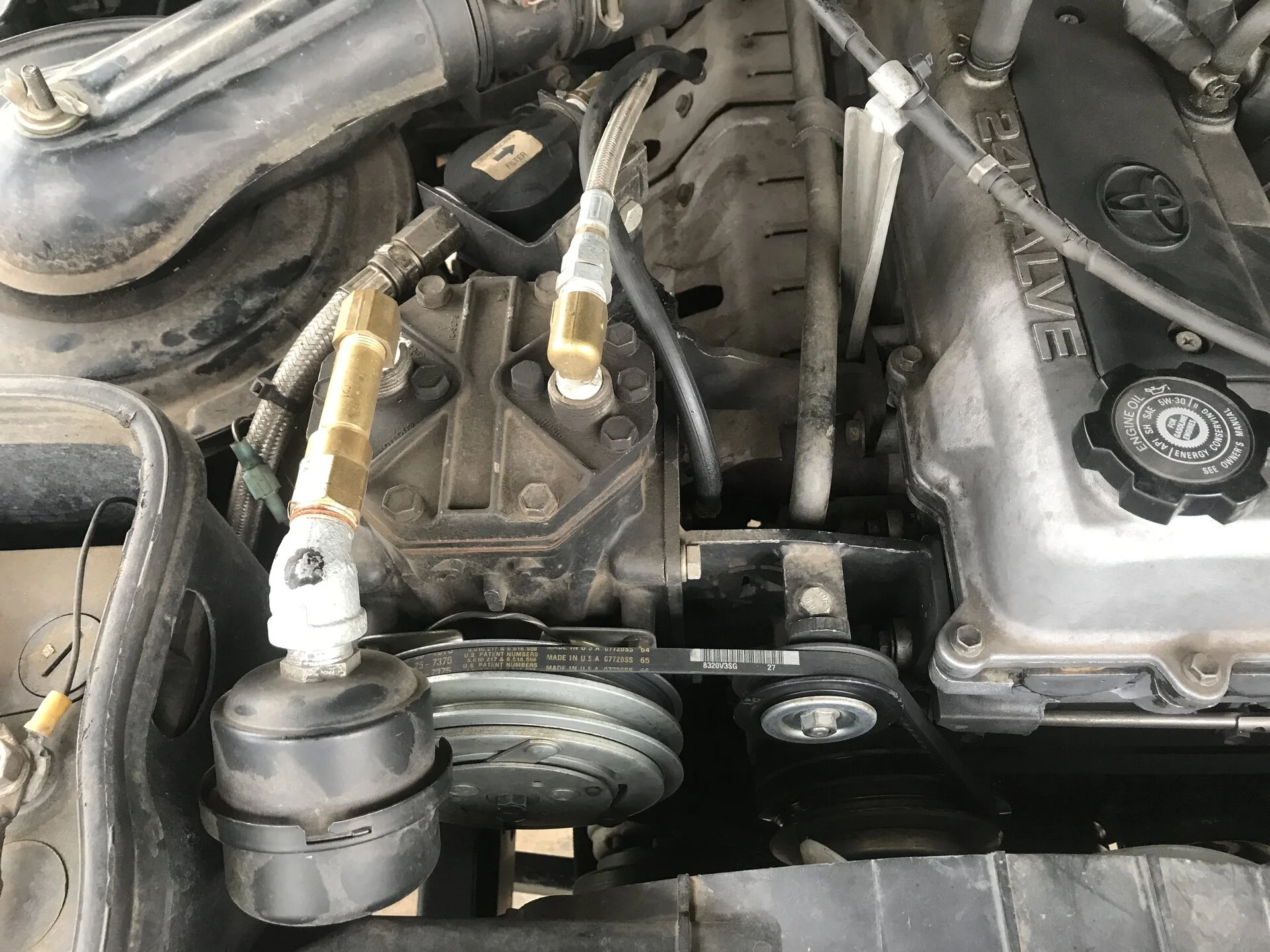

Here is my set up

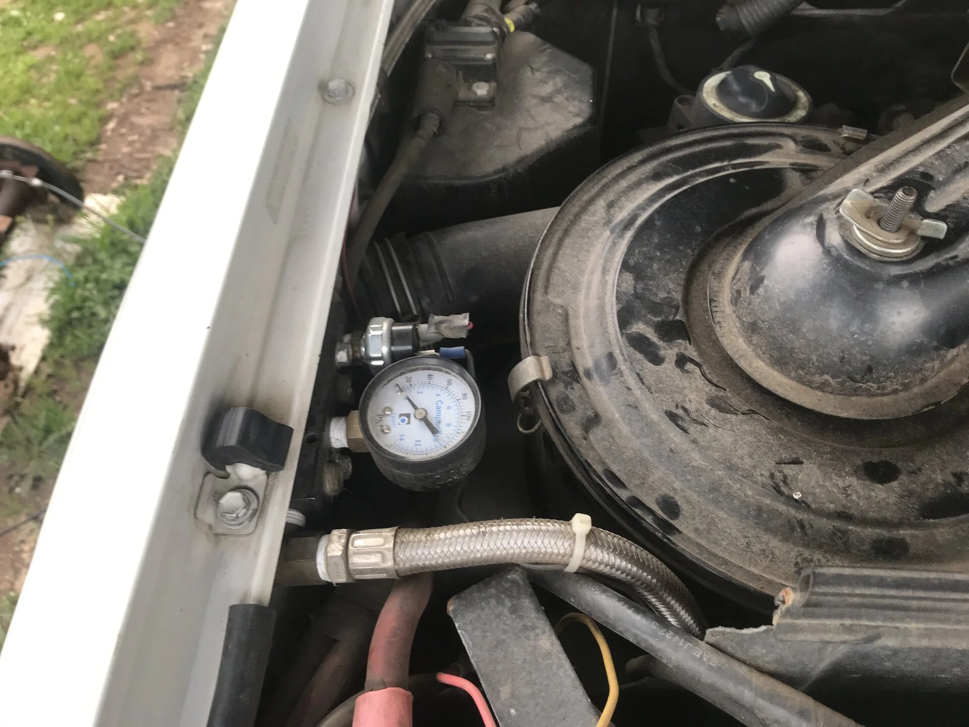

The Gage you see to the left in the pic is a distribution box with multiple connections for air intake, control switch, guage, rear air line and other options.
Also in the compressor pic, there's a coalescing filter to catch oil.
It has a quick release to remove and drain it.
I have run this set up on all my offraod rigs for 30 yrs, all ways worked with out failure!!!
There is one other option to all of these.
U can convert your A/C compressor, if you don't care about having A/C.
Just buy a Oil drip system, (very inexpensive) to lube the compressor in action.
Plumb the lines and voila

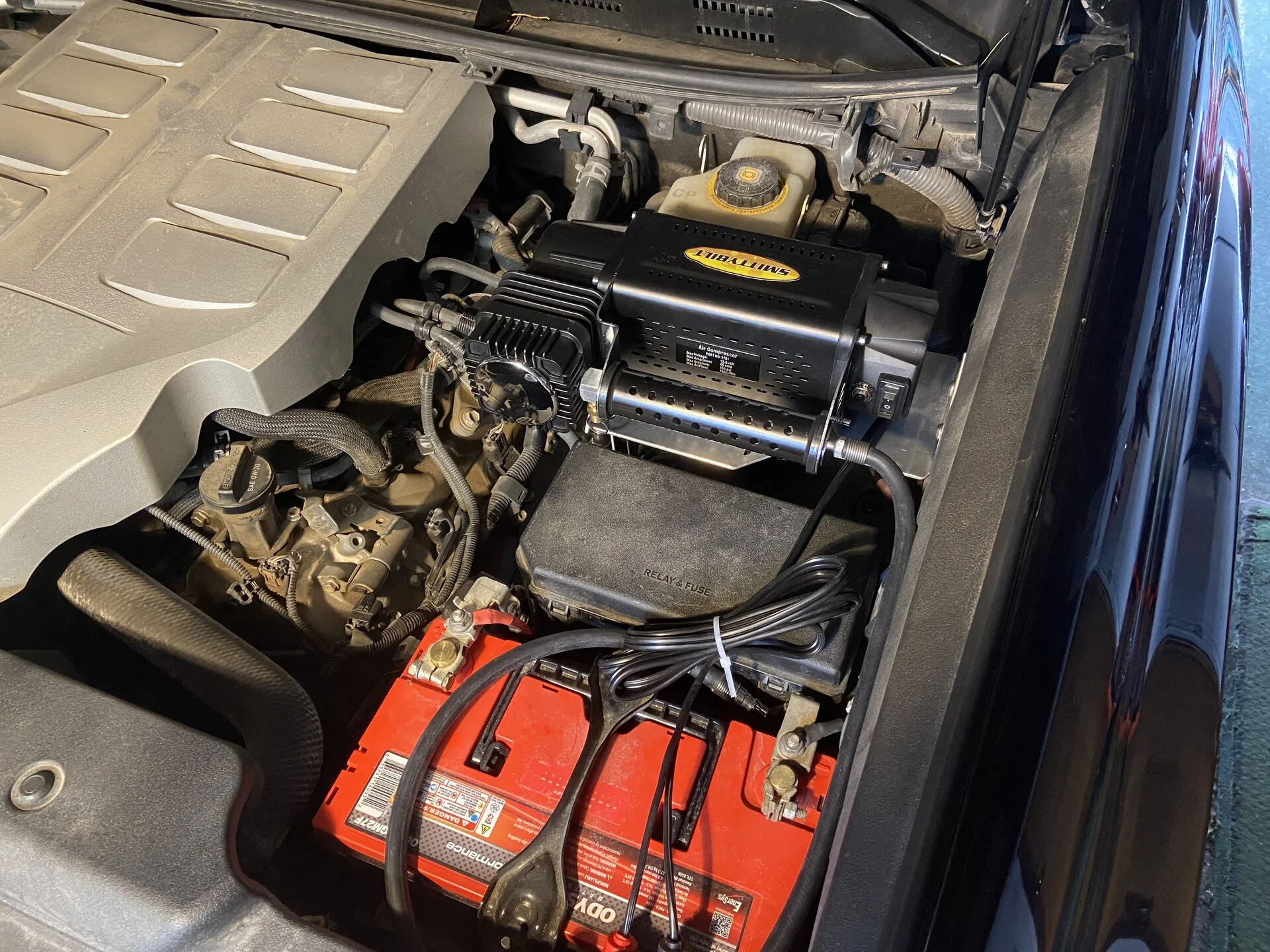

I fit the Smittybilt 2781 here. Very high volume compressor, I'm quite happy with it. I just use the hose that came with it and usually finish just as quick if not quicker that the guys with their 4-tire hose setups.
Unfortunately I am not sure there is room for that type of compressor on a 2UZ or 1UR vehicle. But a sweet setup!

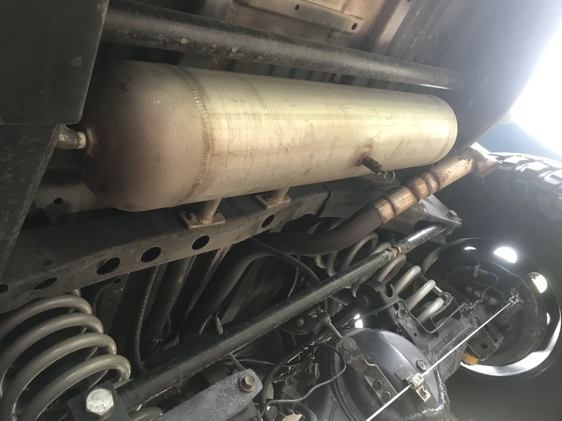

I run a York belt driven compressor with a small 5 gallon tank in the rear.
I regularly run with guys that have all the other compressors listed here and mine is by far the best at speed, NO NOISE!!
I turn it on a little before I stop, n I am ready when I stop to get er done.
I am finished with my 4th tire when they are starting their 3rd.
What psi does your 5 gal tank hole?

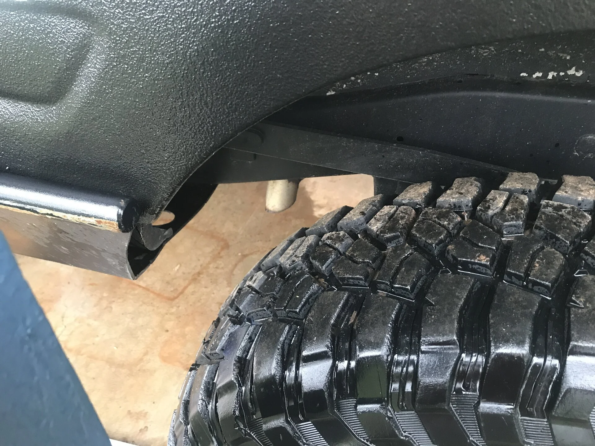

Just noticed your side exit exhaust. Twice already I've pushed the rear exit exhaust tip into the rear axle and pinched off the tubing going through rock gardens. The first time cost me over $300 at the dealer for the resonator/tail pipe assembly, and that was haggling over the price and putting it in myself. The second time, I just had a muffler guy weld a side exit straight to the muffler, exiting just before the rear wheel.
Looks like you did the resonator delete also. How's the sound to you? I hear my exhaust just a wee bit more and not sure if I like it or not.
Can you take a photo of how your exhaust exits on your passenger side?
