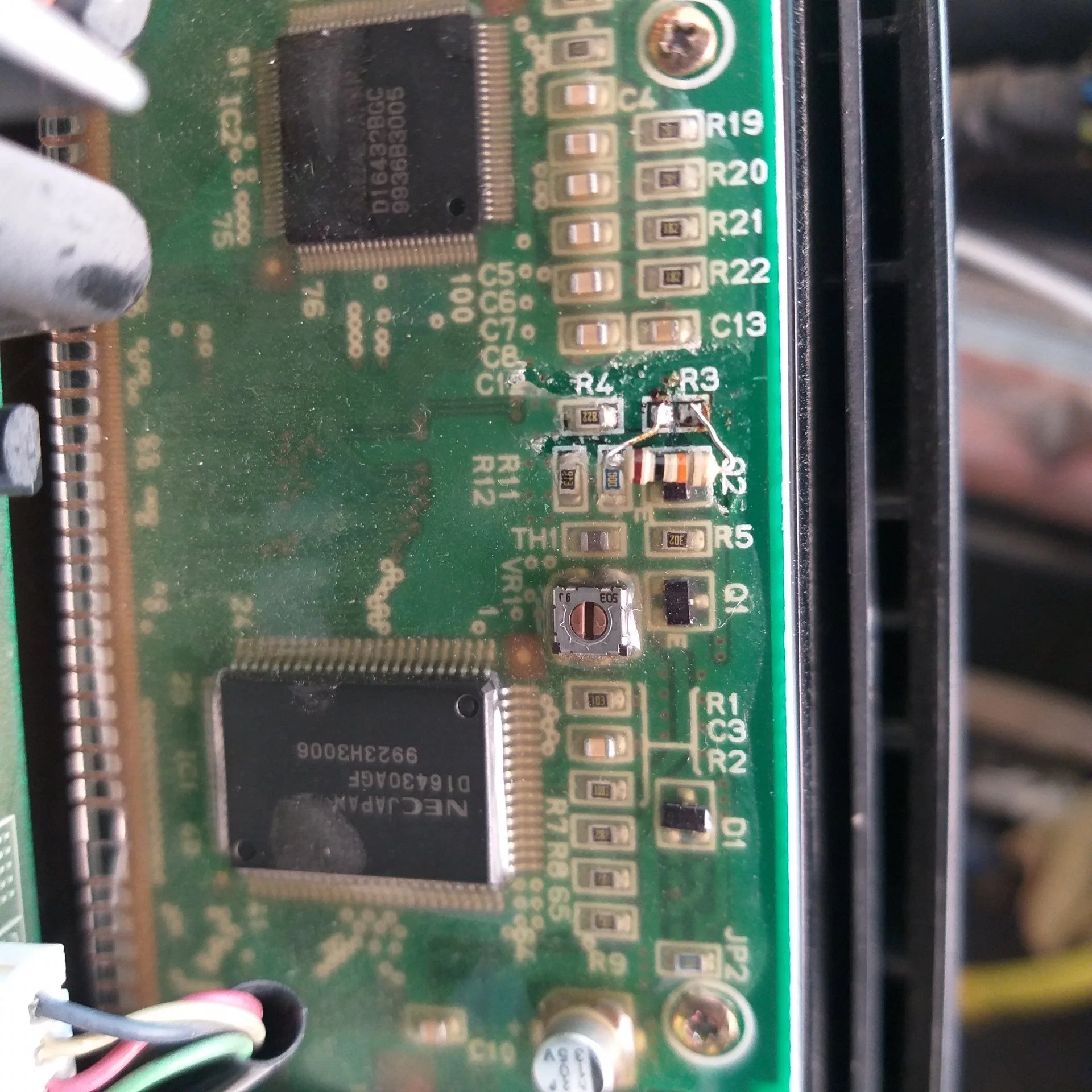

hi there, the solution for this problem it that:
buy a 10kohm resistor, smd or pth is not really important.
disassembly the clinometer, and focus on the display board (the small one)
IMG-20180721-WA0015_zpsxcr3w4c0.jpeg~original
remove the potective coating with a small plastic scraper (gently) around R3 resistor
IMG_20180721_195044_zps78xcg5ey.jpg~original
Check if resistence is near 11kohm, otherwise, desolder it and change with the previous bought one.
Check if everything is working now, reassemble it and have an happy landcruising day.
