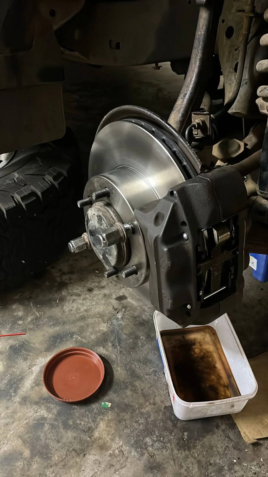

So yesterday we removed the calipers. The front right disc was warped. So I've replaced the the front discs and pads. We went for a test drive and all seemed great! The vehicle wasn't pulling while we were setting in the pads and discs.
Later on though, I went out with the Prado, and sadly, it started pulling right again, when braking. The last thing I can do now is a repair kit on the calipers. Strip them, and replace the o-rings and seals by the pistons, and maybe lubricate them up to see if that will help. Maybe there's a chance one of the pistons have ceased.

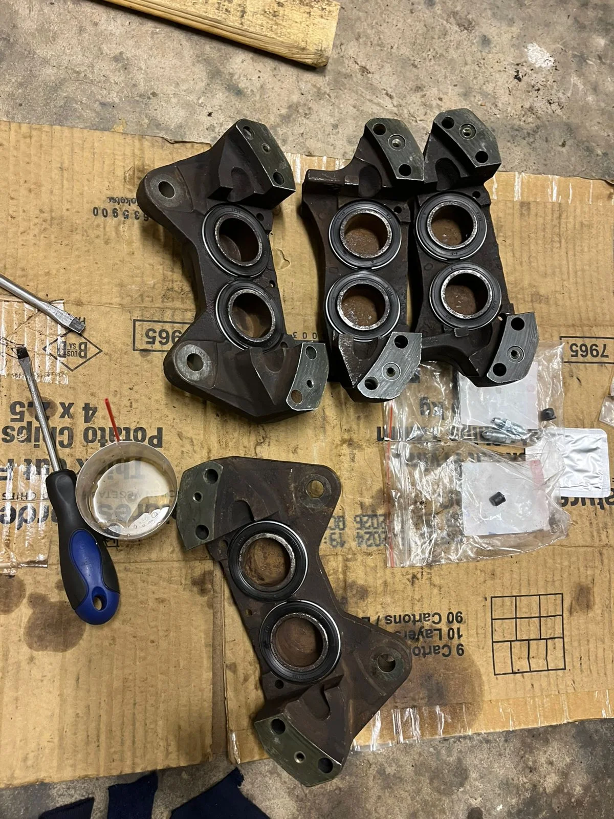

Another quick update:

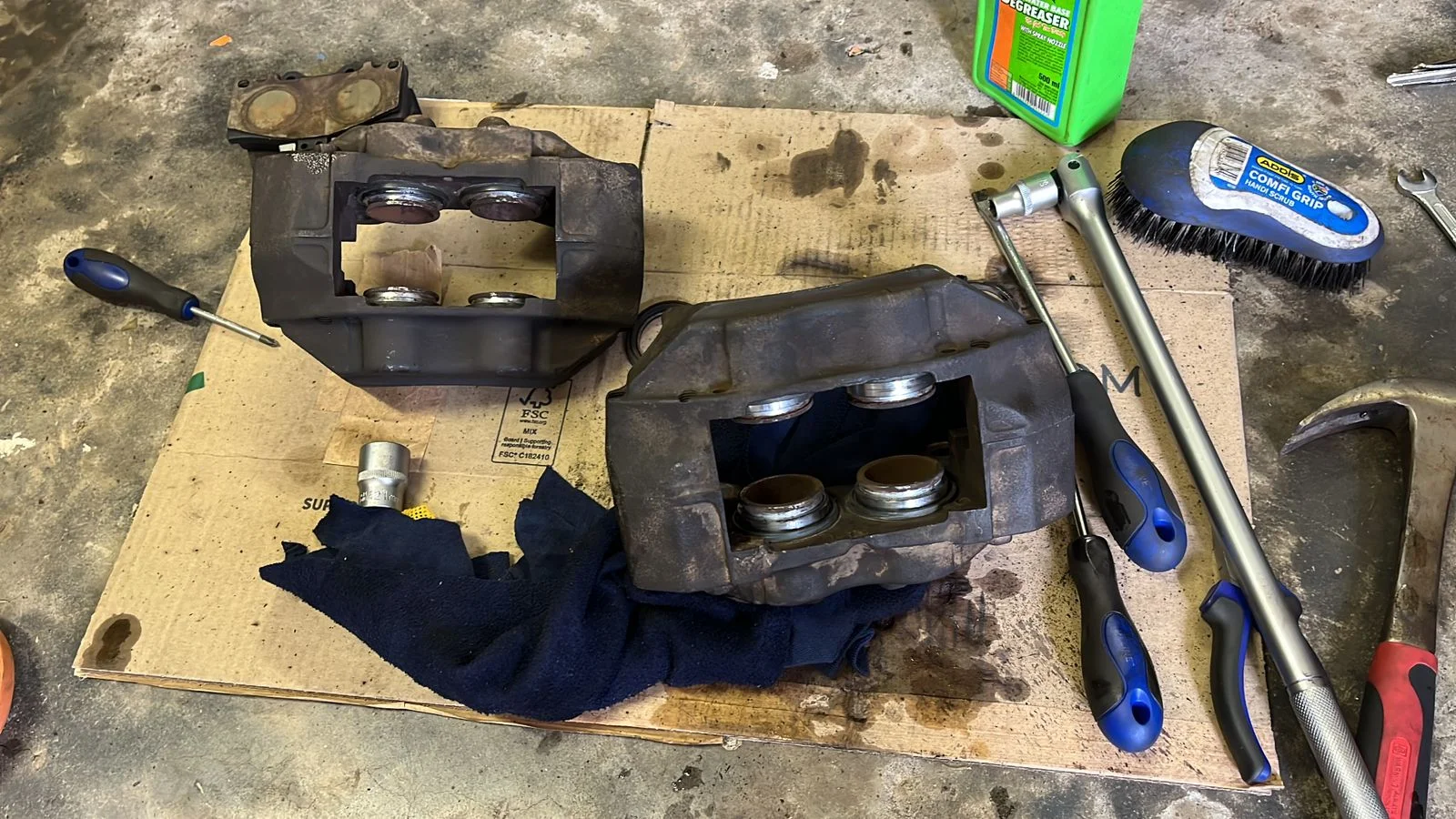

I removed the front calipers today. The dust caps basically tore off they are so old. I'm struggling to get the pistons out, so will see if there is an engineering shop with a compressor that doesn't mind pushing them out for me tomorrow. I also need to get the seal kit. I moved the left calipers pistons a bit, and they didn't seem seized, which is weird. But some very dirty brake fluid came out of the caliper, so maybe something is happening behind the pistons.
Another update coming!

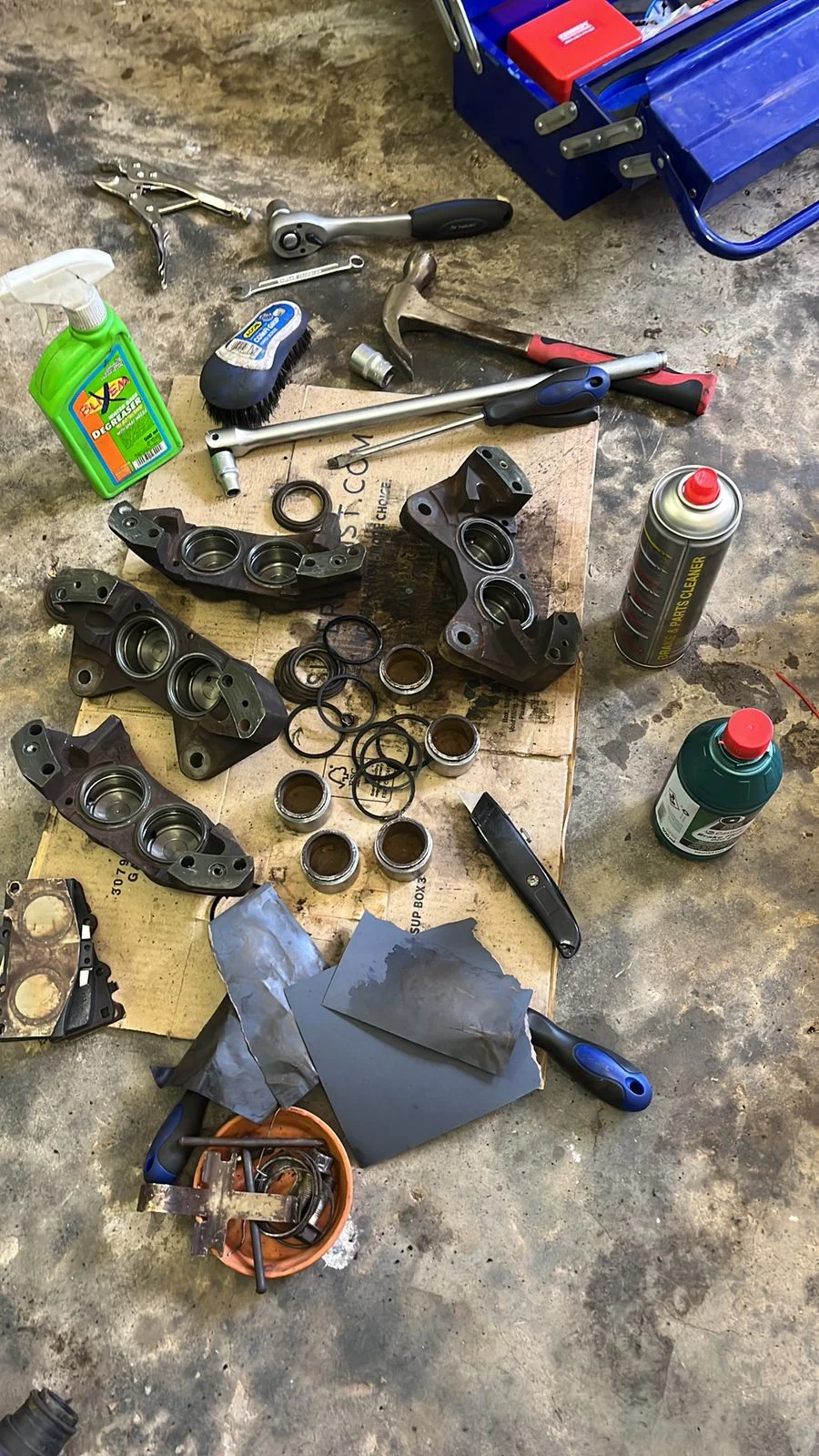

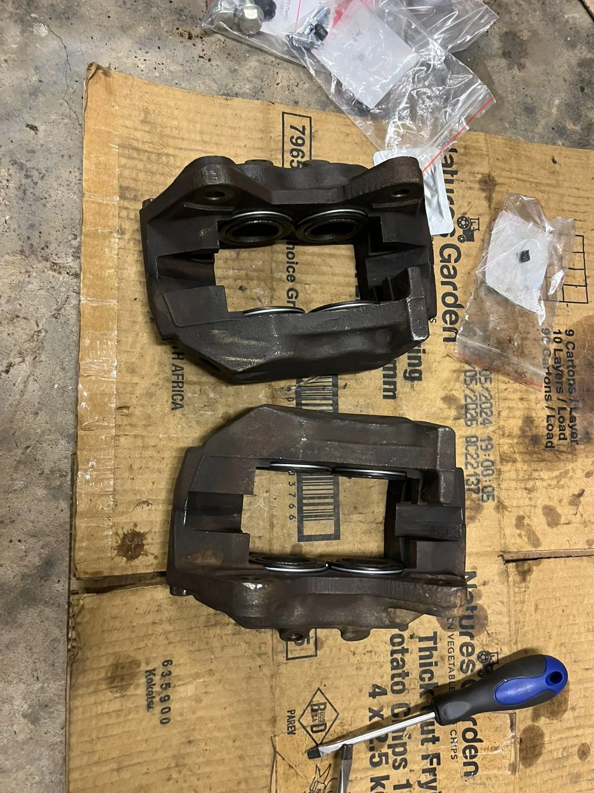

On Tuesday, I managed to get the pistons out, thanks to a local company who kindly assisted me. They split the calipers and then got the pistons out. I was hoping to avoid splitting the calipers, but it's ok.
I then cleaned everything. The pistons were very dirty, so I used 2000grit water paper and gave them a light sanding. I then reassembled the calipers with all the new seals (including the 2 small seals by the split), and tightened it altogether. I did all of this, then realized that I had put them back together incorrectly. I fitted the backing plate of the left caliper onto the right caliper, so that meant the bleeder was at the bottom, not the top. I had to split the calipers and reassemble again. Fortunately that didn't take long.
Now, everything on the front is back together!
Last night I removed the rear caliper, and today I'm taking off the disc. Going to replace the disc and pads on the rear and service the calipers too. On Saturday I'm hoping to complete everything and bleed the brake line. If I've done everything correctly, we should have a car that doesn't pull right when braking!
I've attached some pictures of the progress.
