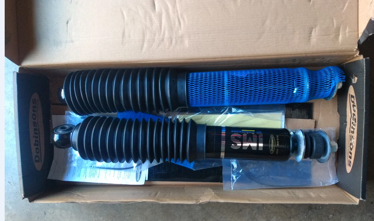

My requirement was a 2" lift in the front and 3" rear. The lift calculation was based on other 100 series owners in the area and knowing the level of mud and water crossings that I encounter. The 100 series was purchased to be used for strictly for off-roading. It goes off-road usually once or twice a month. I usually takes 1 to 2 hours of driving curvy AR roads to get to my off-road destination. Trails are a combination of red-clay, mud, and small rocks that fly up and beat the daylights out of suspension components. Also note that I wanted extended travel front shocks. I like extended droop to keep the wheels on the ground when running through deep holes that you can't see because they are covered in mud.
Requirements:
1) Extended droop. I currently have 24 3/4 inch of full droop in the front.
2) Upper shock piston design (e.g. like ICON or FOX) with a protective boot for the shock shaft.
3) Be able to withstand hot conditions without fade.
4) Handle like a sports truck on winding switchback mountain roads at speeds over the recommended limit.
Here's a good write up from @crikeymike about IMS from another Toyota Truck forum.
I had a rough idea of the total vehicle weight after armor and modifications before I purchased the suspension. I estimated the 100 would weigh ~6,800 after modifications, gear, and passengers. I knew I would be close to the 6,860 GVWR at the end. The initial weight projection turned out to be right. If you do your homework and estimate your final build gross weight, buying springs for your final destination can turn out to be a good move.
Post Purchase Evaluation
So I ordered all of the parts, put everything together, and worked out great. I was somewhat shocked at how well it drives and handles on winding mountain roads as well as the trails. As far as driving preferences, all of my cars have modified/lowered suspensions with crisp handling characteristics. I don't like a land yacht ride. I think the 100 can take curves and handles woops and bumps with ease. Overall I'm very happy with on-road manners.
Off-road manners ride are also good. Note that I air down to 24 lbs for off-roading. I haven't see a need to go lower with my current mud tires.

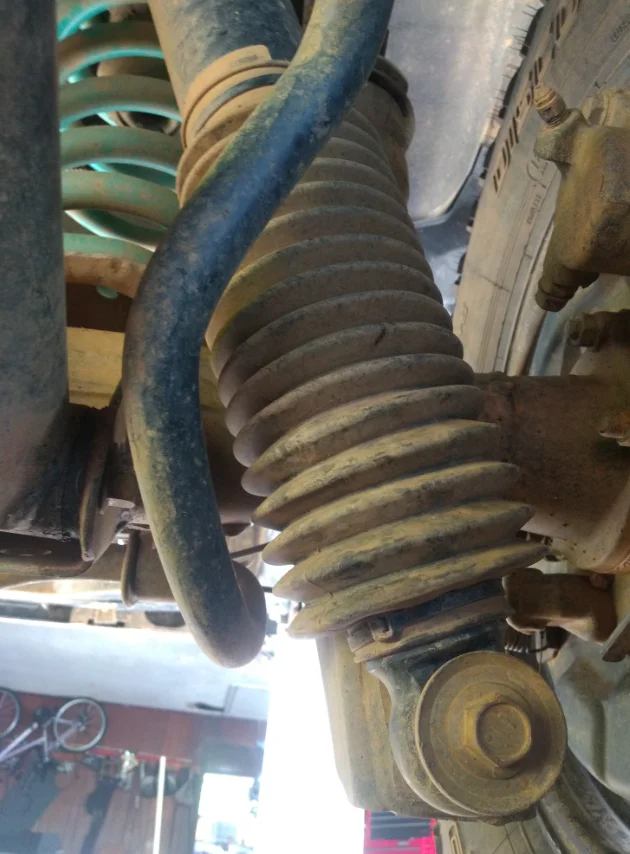

How do the shocks perform off-road and can the shocks take the kind of abuse?
Let me switch computers to continue with some pictures.

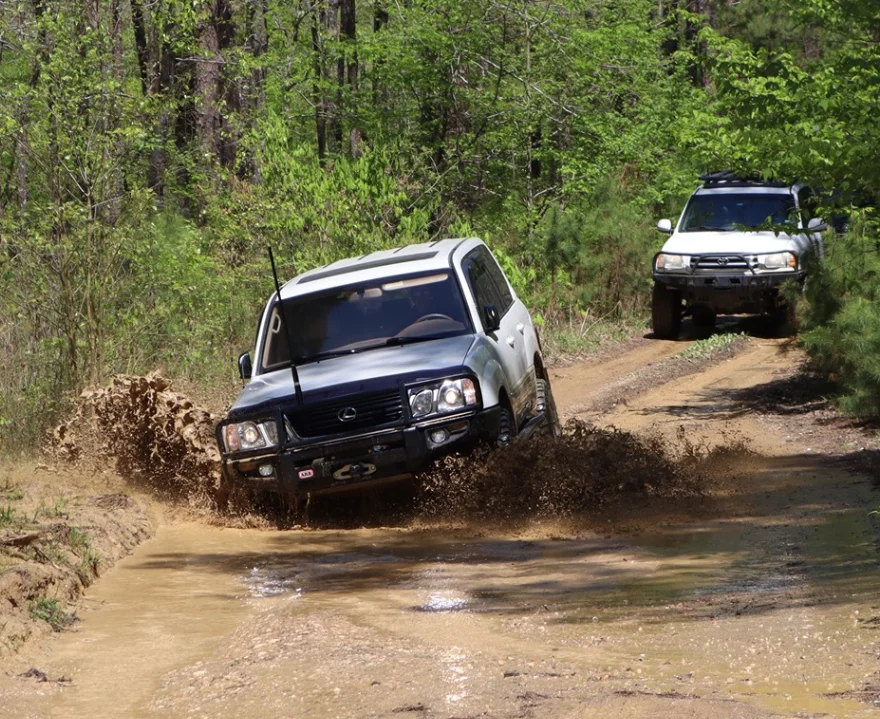

Trail Abuse
This is a picture from last winter when I started off-roading. Today, much of the paint has been beaten off of the LCA. Little trail rocks beat the daylights out of my suspension components. I like the top mounted piston design with the protective boot for the shaft. After some real-world experience, I don't think I could live with a bottom mounted piston design in my environment.
Protective covering on the shock bottom mount area.
I like extended droop in this situations.

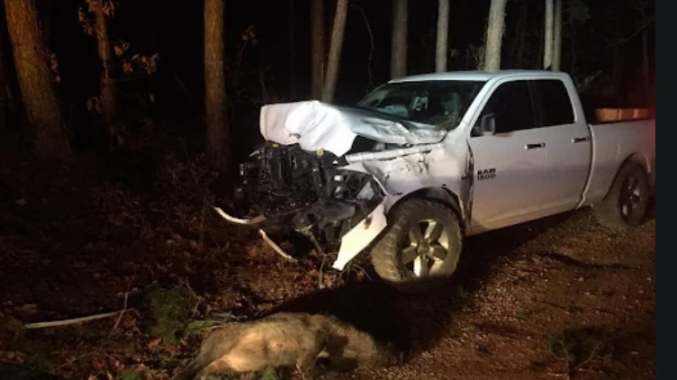

We have regional animal problems down here in the ArklaTex that can put a strong bull bar to good use. Suicidal deer and wild hogs.
Wild fogs are more popular as we go south to Texas. I've hit deer and have torn the front end off of my truck. Animal strikes are a real problem.
You're not going to avoid damage when you hit a wild hog. You just need to be able to make it out of the woods.

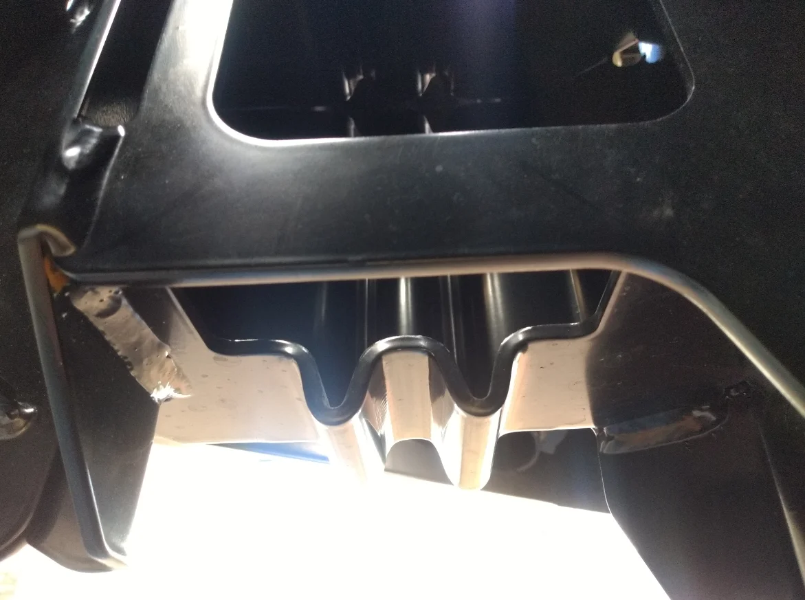

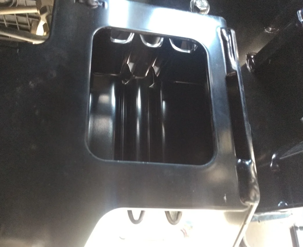

With ARB, it's what you can't see in the pictures below that may save you and your vehicle.
If I should eventually hit a hog, maybe my ARB bumper will keep from damaging the frame or limiting it to being repairable.
A few months ago, I saw a "drop dead georgious" 100 series get toatled. I almost cried when I saw it.
It didn't look like a lot of damage from street pictures.
1) Wheel spacer broke/malfunction causing vehicle to veer into a concrete road divider.
2) Steel bumper without crumple zones. The frame took the impact.
Personal opinion - It just takes too much time and resources to build up one of these vehicles to leave vulnerable areas.
