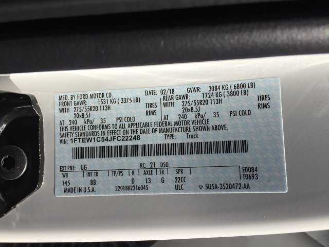

Interesting fact, the LC has higher weight and axle capacities than the F150 if you ever want to consider towing with it.
F150 vs. LC
GVWR: 6800 lb | 7385 lb
GAWR Front: 3375 lb | 3595 lb
GAWR Rear: 3800 lb | 4300 lb
F150 Platinum:
LC
F150 vs. LC
F150 Platinum:
LC
