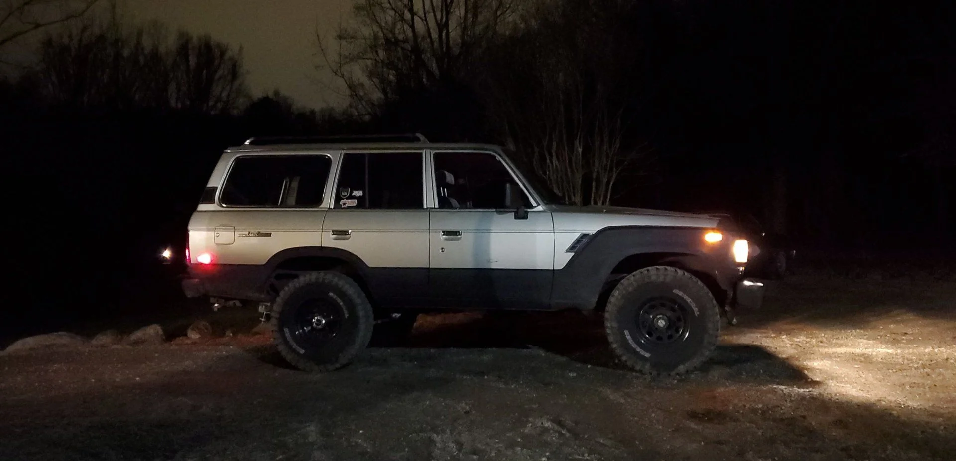

With the OME suspension on my '86 I went with 70-Series 16" wheels (they retain the stock look) and BFG 235/85R16 ATs. I like the tall skinny look. The tires are about 32". It has a 3FE, H55f 5-speed, and FJ62 4.11 differentials. I really like the combination.

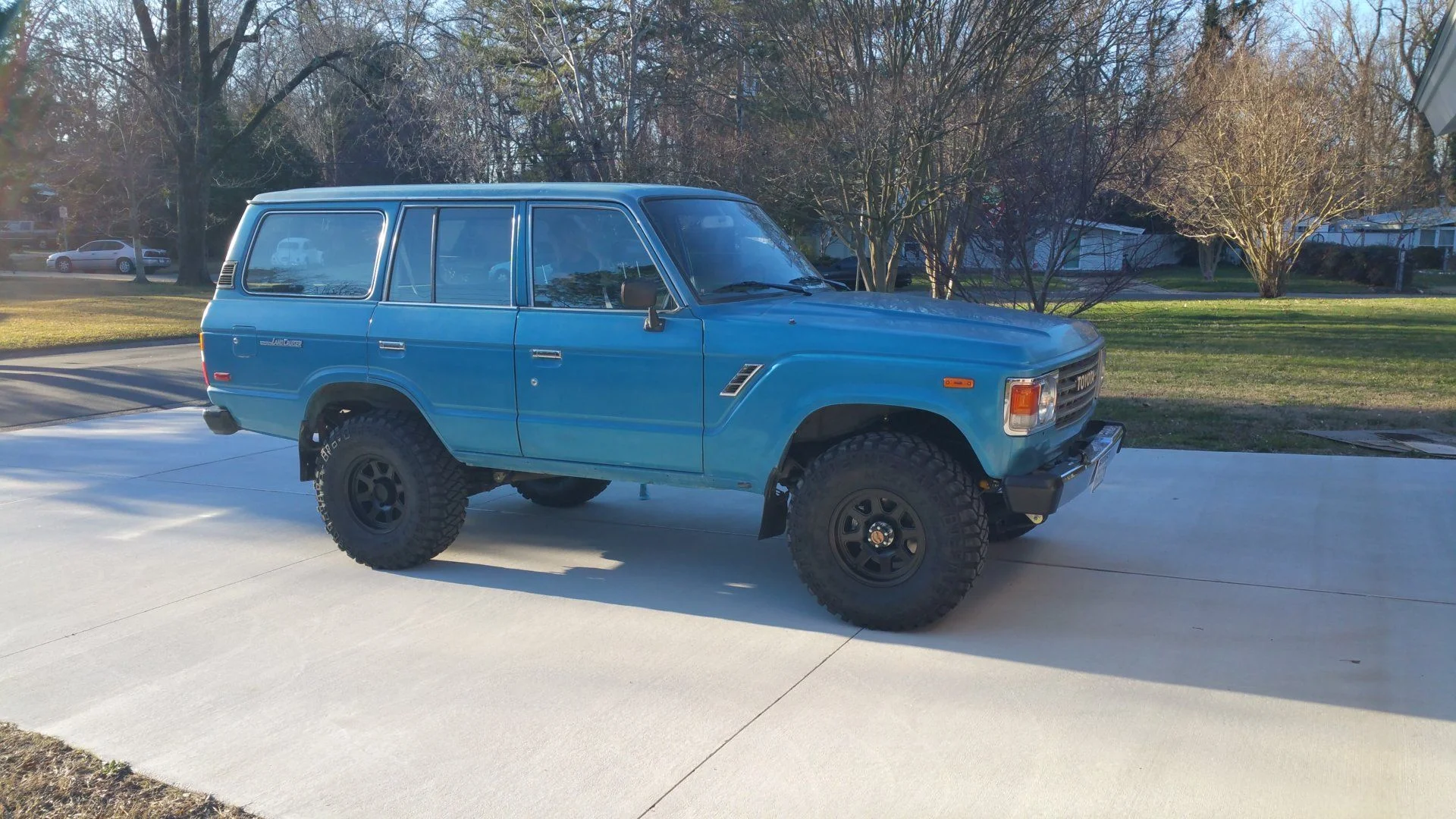

I have the same combination as you: Original 4spd, OME. The 5 speed would be loads better but the 4spd with 33's is fine on mine, which I drive daily. The rubber overdrive you get from 33's is a real thing so coming from 30's the 33's helped me a lot. I would be much more concerned with the effect on drivability the tires have rather than whether they rub when choosing tires. These trucks are such dogs to begin with that any extra slowness you may see from 33's is fairly imperceptible, at least to me. I think 33's look better with the OME setup if that counts for anything. Fills in the wheel wells better than 31's. But that's just me. But to answer the question you actually asked here...the only rubbing I get on mine is against the tail pipe driver side rear. Seems to be the way my tailpipe is routed right by the tire. Other than that nothing touches. HTH.

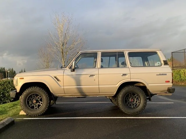

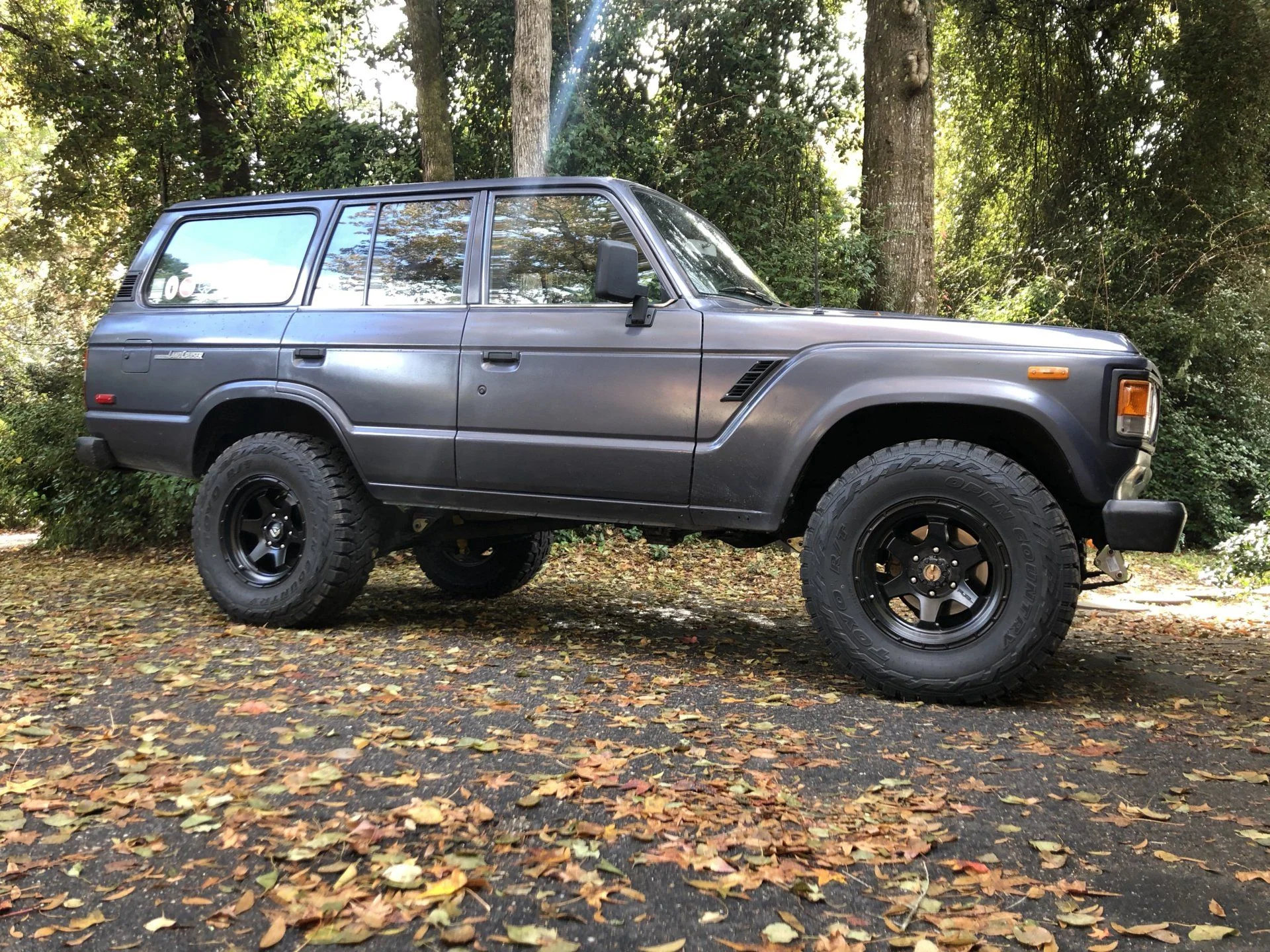

I second what @Robert Franzke says. I recently changed from 31” to 33” and Robert’s experience echos mine. I have 285/70 17r KO2 wit 17” TRD wheels. I did have to adjust my drivers side steering stop because the tire rubbed on the leafs a tad. I have the same OME med/med setup.
