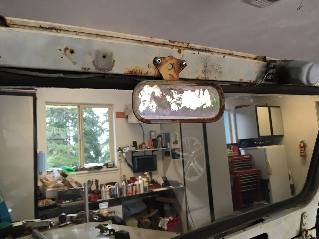

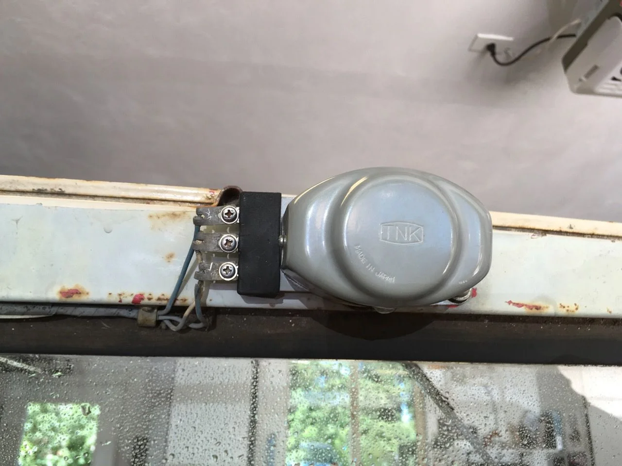

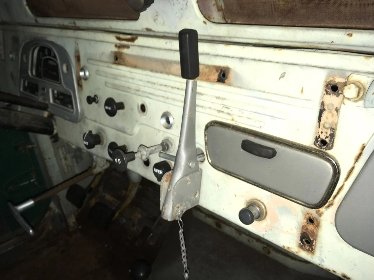

So the question is, why does the hole exist? Something was there. Perhaps a switch for optional fog lights?
There WAS a Vader light switch in that hole when I got the truck, but the switch was not factory and was probably added by the original owner. I just got lucky that he actually drilled that hole in a good spot. That was not his normal MO.

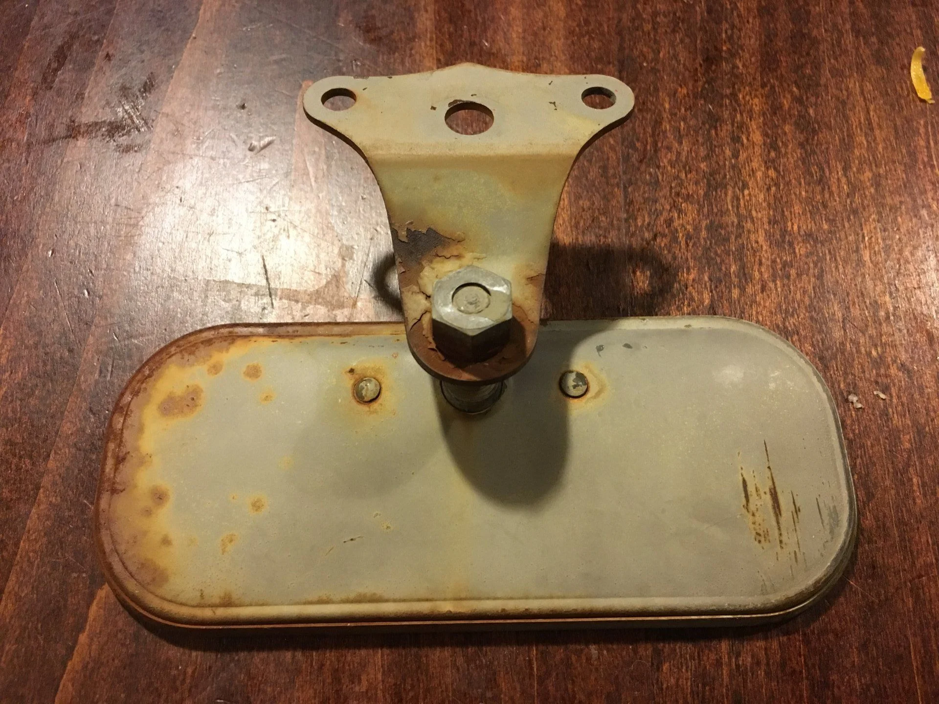

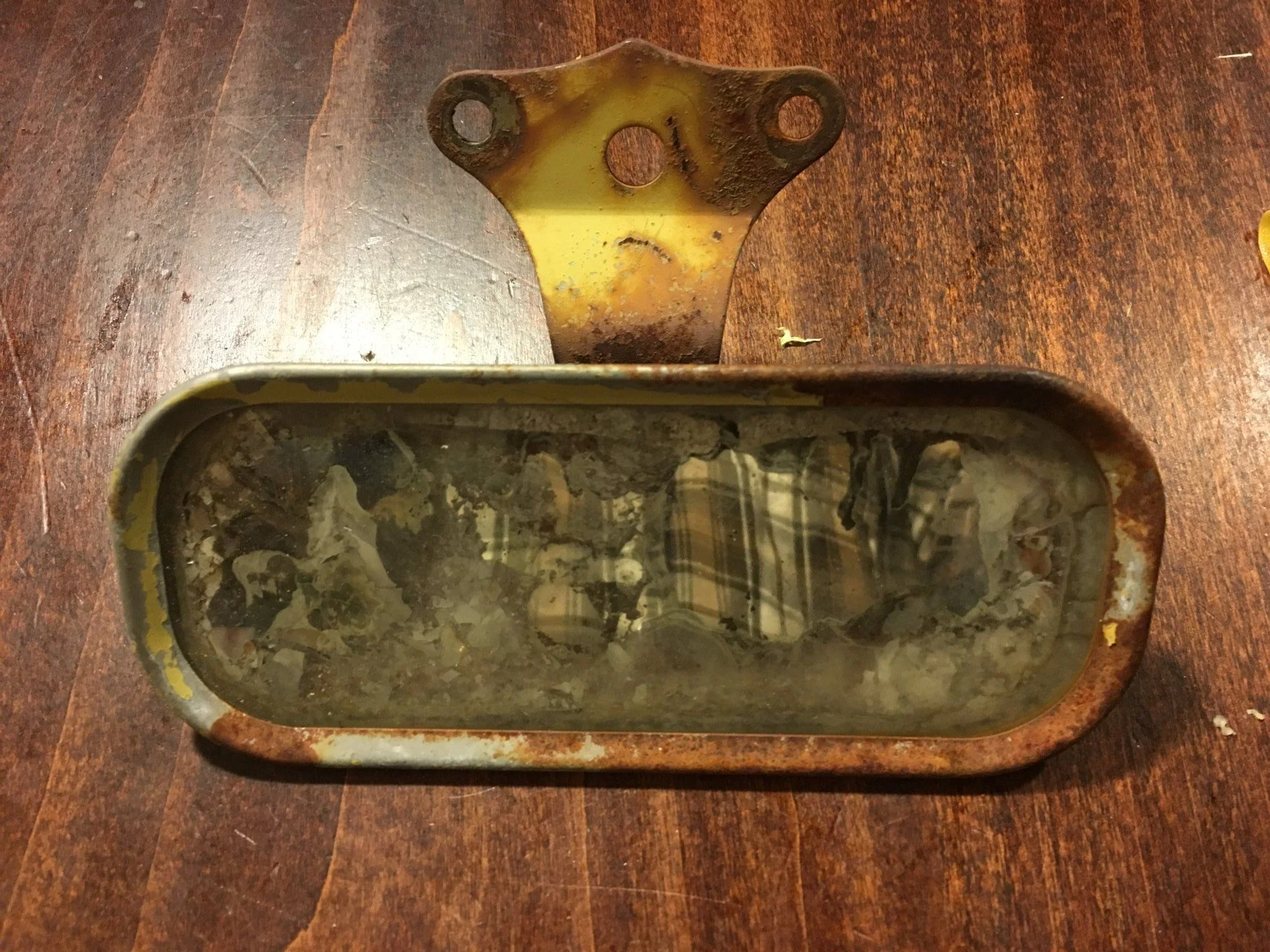

More parts trickling in. I now have a correct inside mirror, although it needs some help.

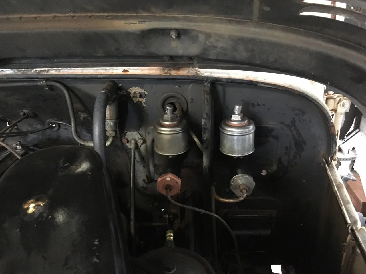

Working through the fuel system now. Installed new fuel pump, and cleaned up the original fuel filter (glass bowl) and put in a new element. Sheet of phenolic material just arrived, will begin building a carb spacer tomorrow.

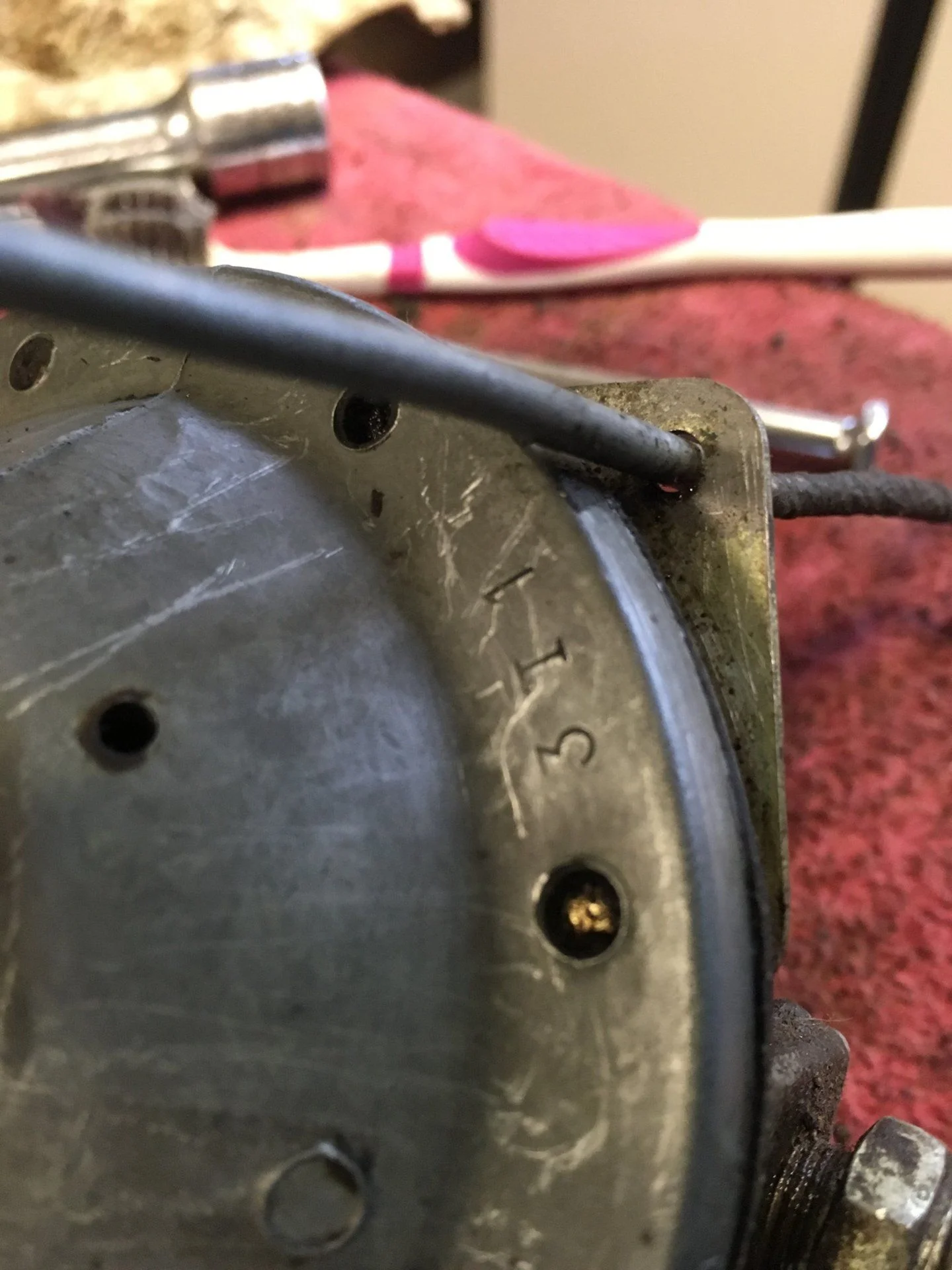

Found two more date codes, one of which really narrows the build date range.
Fuel filter -
Fuel pump -
So the progression of dates so far is:
Carb - 3A3 - January 3, 1963
Block casting - 30112 - January 12, 1963
Fuel filter - 3B1 - February 1, 1963
Fuel pump - 3I1 - September 1, 1963
Sold to 1st owner - November ?, 1963
So the actual build date was probably in September.

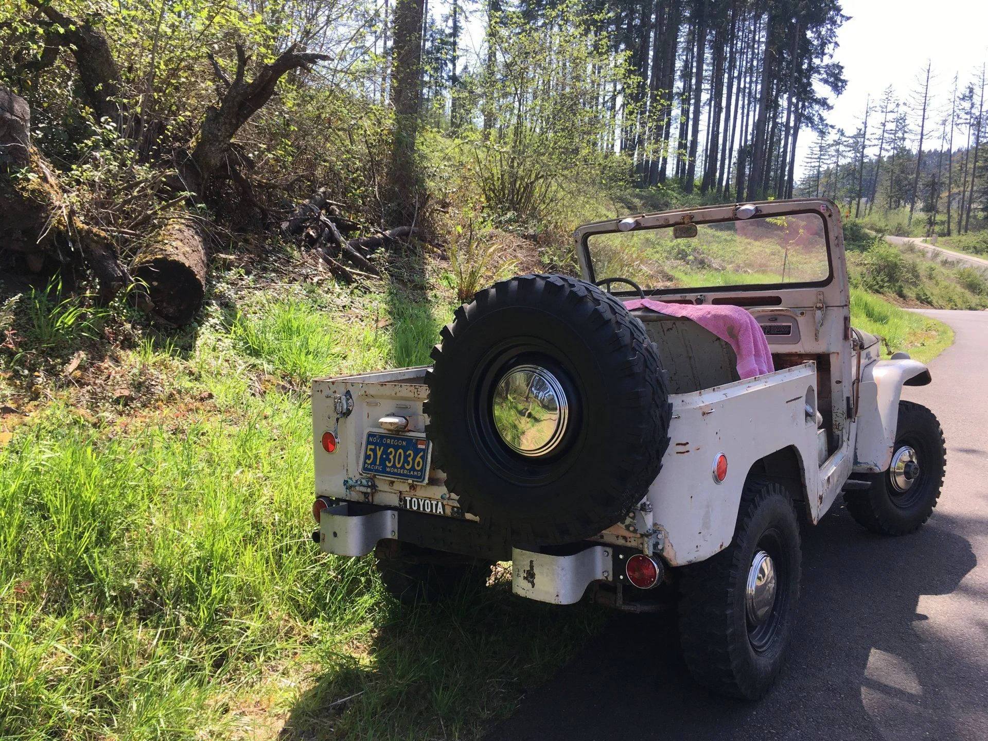

Back on (and also off!) the road again after the front axle work. Also now sporting the final prototype of the new repro reflective rear sill stickers I'm selling. (See Small Business classifieds or link in my signature.) The real one won't go on until after paint.
Determined the root cause of the rig's underwhelming performance. The throttle linkage is so sloppy from wear that I'm never getting much more than 1/2 throttle. Some work required on that.

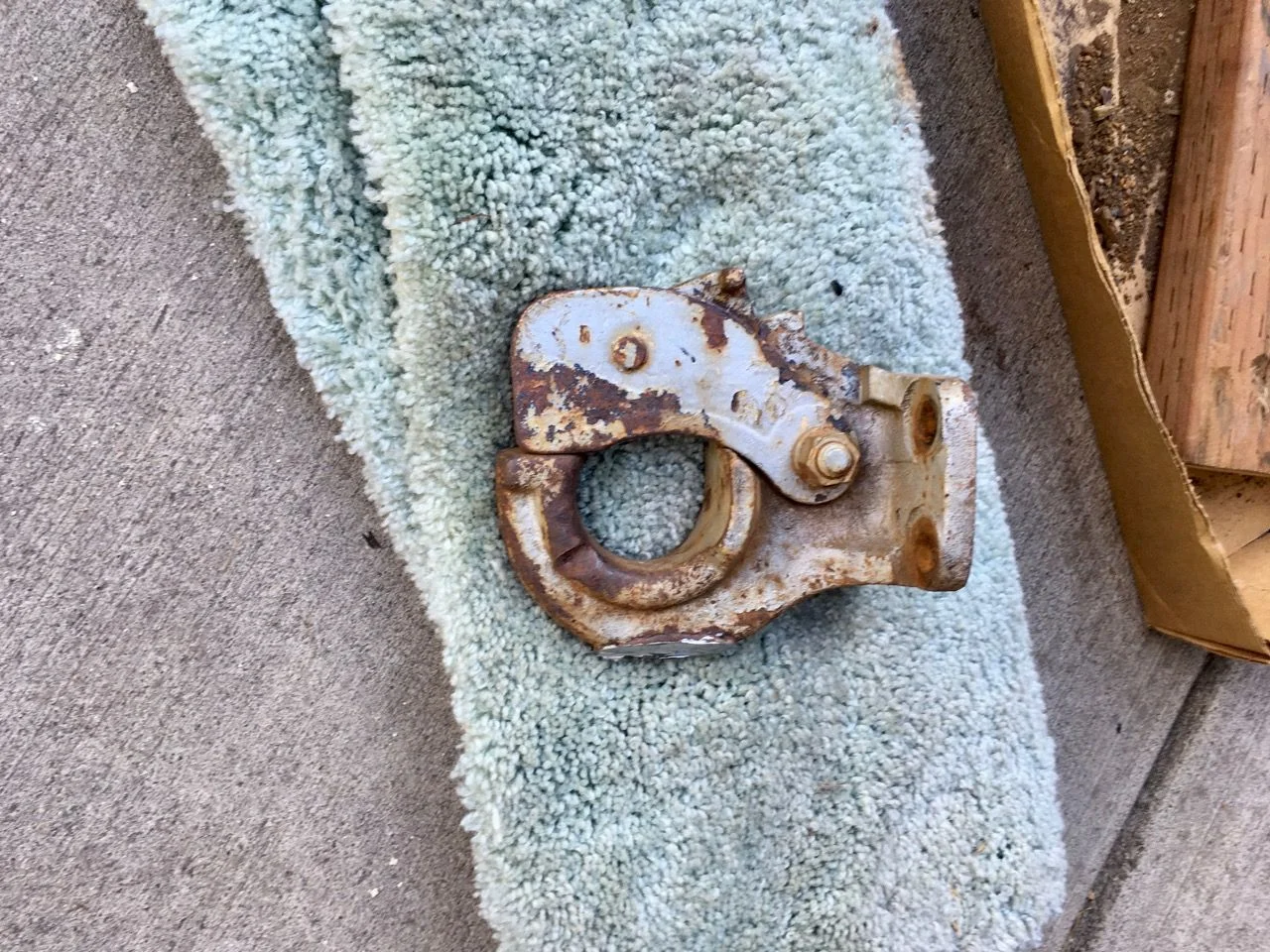

First owner welded some sort of hitch stinger to the bottom of the pintle hitch. No other connection, no reinforcements, just arc welded to the bottom of the pintle. Looked bad, worked worse. Here's an early picture.
2e22c637-a6a5-4c36-ba6d-7f3b5536b4d8-jpeg.1582138
I spent several hours over the past 2 days cutting through the weld beads to try to remove the ugly and save the pintle. Took way longer than I expected, the two beads he welded there were by far the very best welds he ever did anywhere on the truck! I still need to clean it up some with the bench grinder, but the end result is that the pintle will be OK.

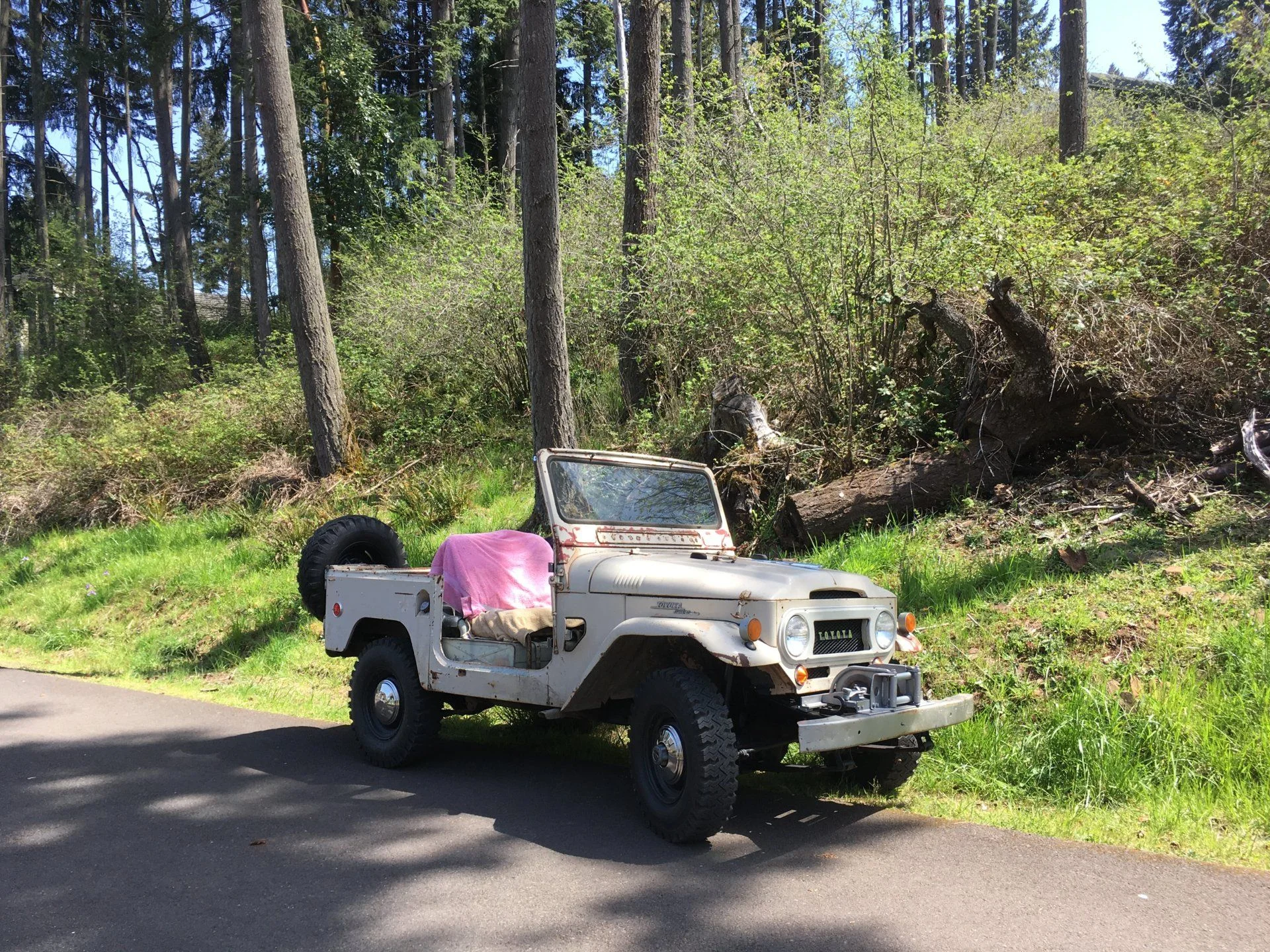

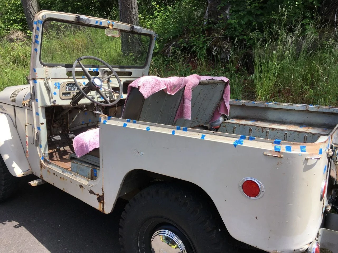

I think your going to have to keep the pink towel with the rig. It seems a part of it now. ;)
Found another pink towel for the driver's side, but haven't got it installed yet...

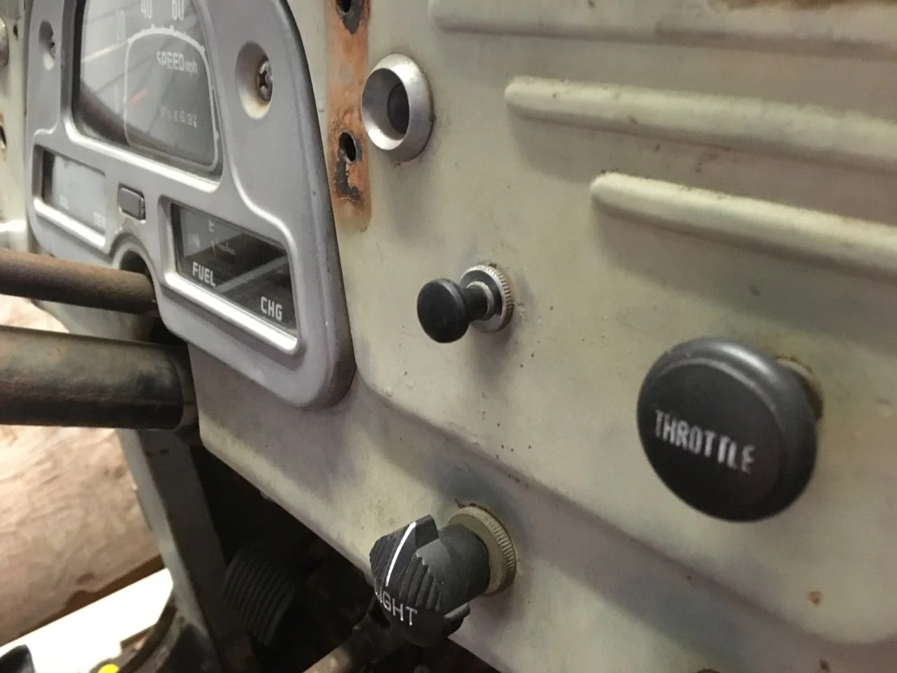

New room light switch for the Vader light.

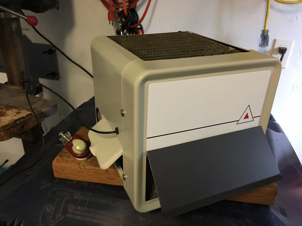

Finished restoring the dealer installed Hupp heater.

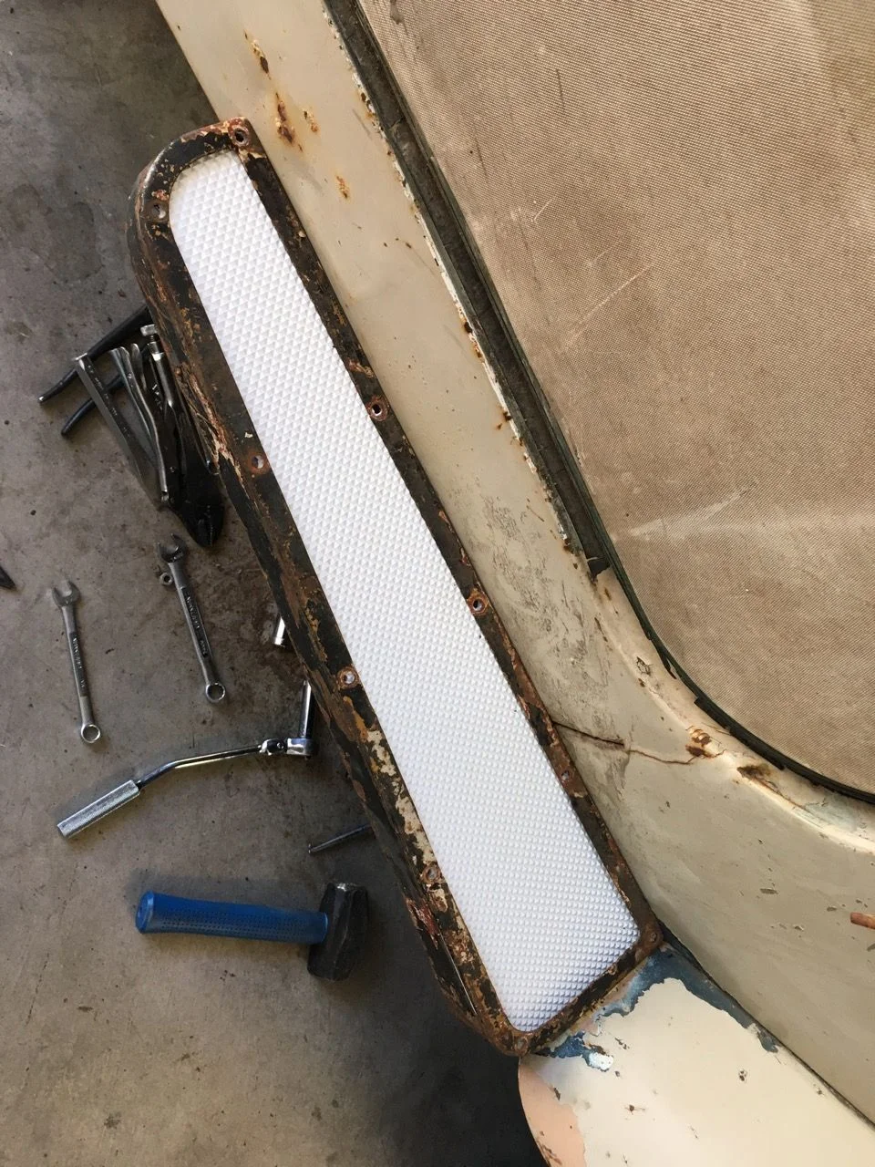

Test fitted running boards with white pyramid vinyl.

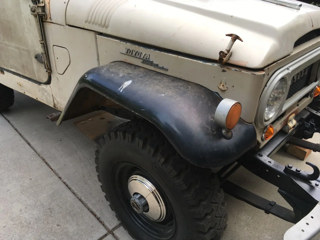

Continuing to gather bits and pieces. Stuff arriving from all over. After looking at it closely, I decided the right fender was really hocked up and full of filler, so I picked up a really nice one off Craigslist. Now attempting to get all the front sheet metal to fit reasonably well as practice for after paint. Looking to possibly start disassembly for media blast next week.
