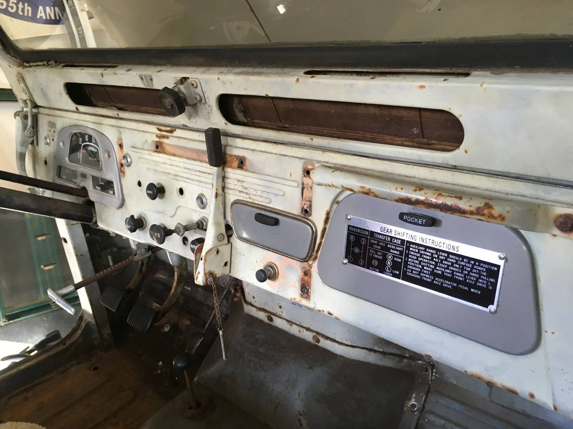

Ashtray installed, using the unit from @cppilot plus the black handle from the remains of my original.

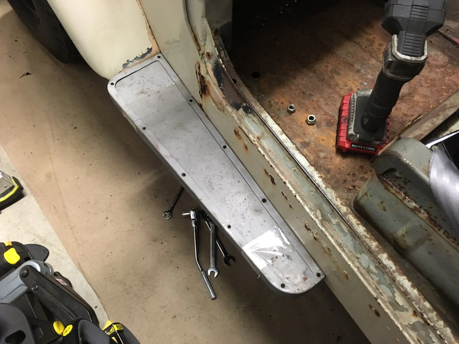

Driver’s running board and turn signal hub from @pardion arrived today. The running board will be test fit within a few days, but is bare, blasted steel now, so won’t be permanent until after paint. But I did install the turn signal hub, and took it for a short drive. Signals cancel properly now. Yay! Another thing off the “does not work” list.

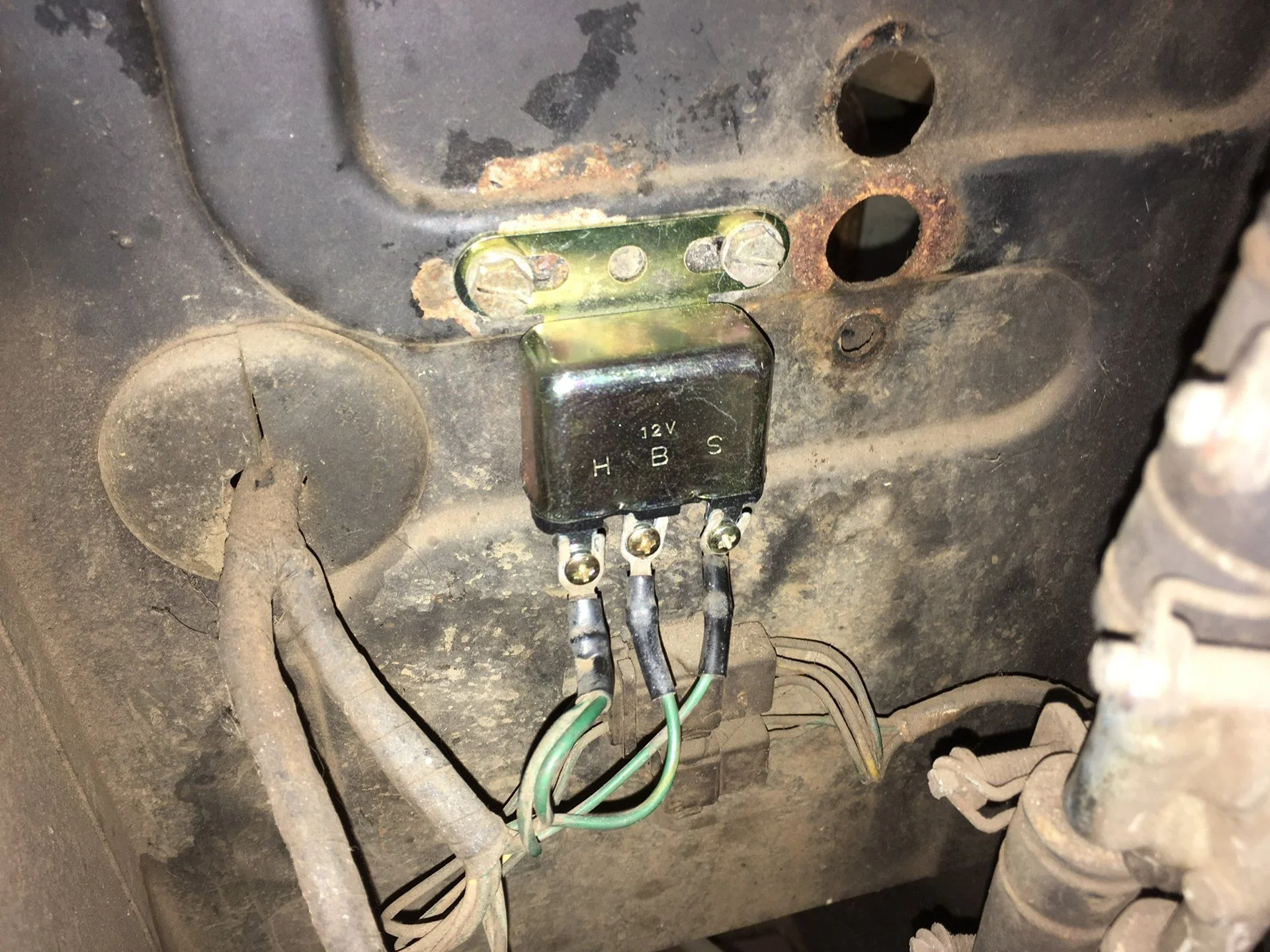

Actually, I think the only thing not working (at least somewhat) right now is the horn. The original metal case Denso relay has a bad coil, so I need to find a replacement relay that looks reasonable there.

Did ash tray nobs change color? I wondered about this..
Don’t know. Mine is black, and so is the one that was on the ashtray Mark brought me. But his had one broken stud, and the nut on the other one was backed off and rusted solid. So swapping the knob with mine fixed it right up.

The second running board arrived. It is a bit rougher than the first, but that was disclosed from the beginning and it is as expected - solid and repairable. I’ve started straightening it out, and I’m sure it will be fine. Thanks, @whitey45 !

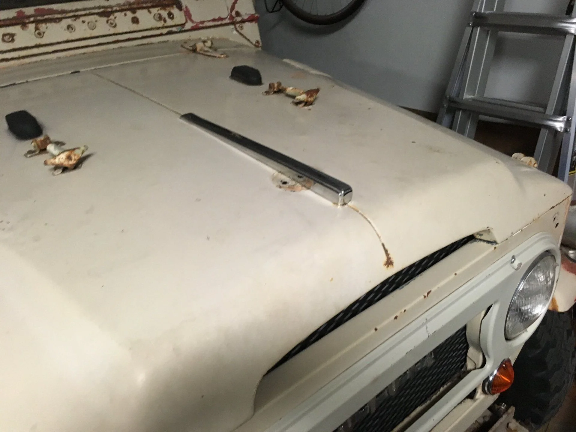

Last, just tonight I got a hood spar from @HelloKitty65 - he knew I needed one, and had a chance to snag it for me. It’s a pretty nice one, better plating than most I’ve seen, and only one broken stud. It’s a nice addition to the rig.

After failing to find a horn relay that would work on my rig w/o modification at 2 modern full service parts houses, I paid a visit to the old fashioned, same-family-owned-since-1960 non-computerized parts place across town. Went to the counter, showed my non-working Denso to the 2 women and 1 guy behind the counter, and said I needed an old fashioned 3 terminal horn relay with screw terminals, and if it was similar in shape and mounting, even better. All 3 looked at mine, and after a few seconds the man said, “Wells HR610.” One of the women walked down a back aisle, came back with this one. Works great, now both horns work!
Excellent! One ordered. Can you make it clear which wire to which terminal? Thanks.
