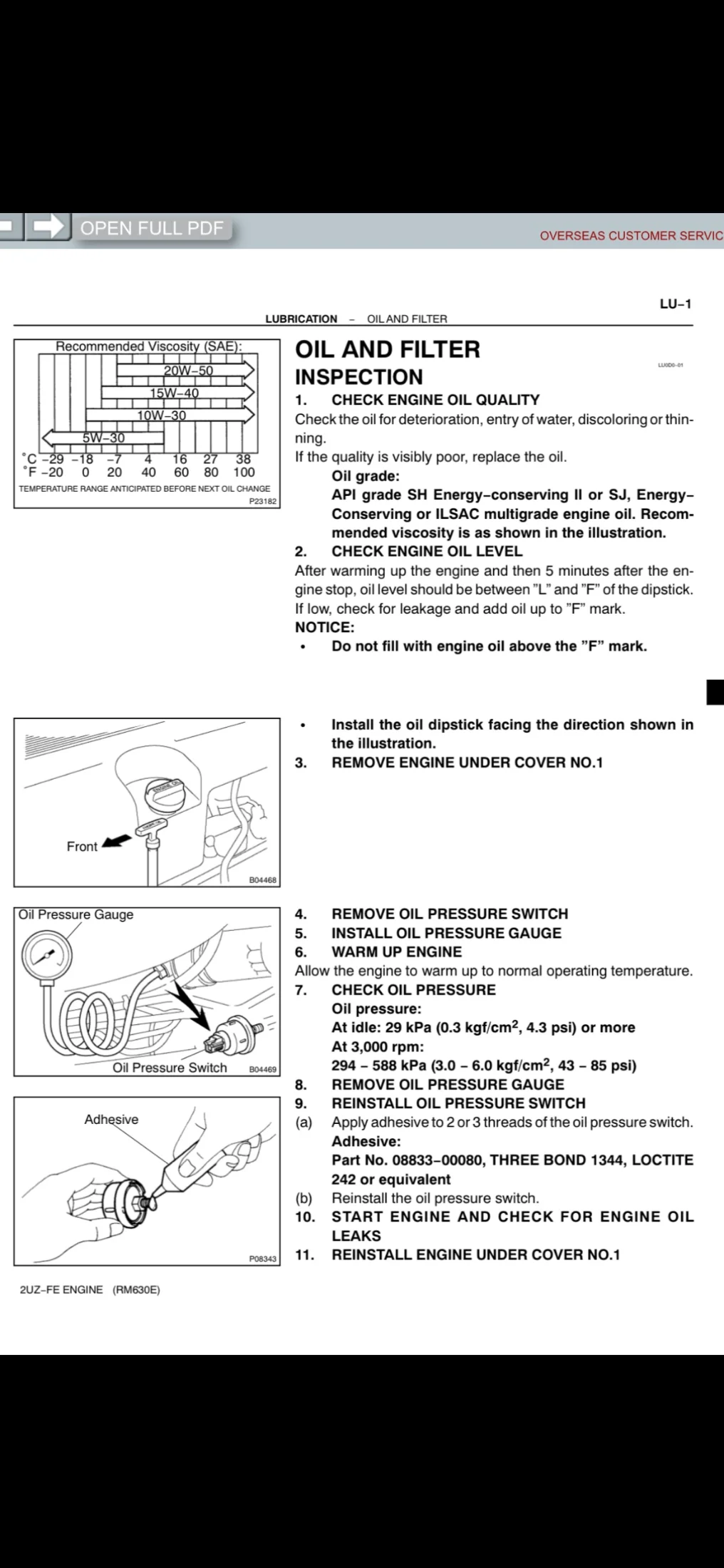

Hey guys,
I found some sources on this but hoping someone with an owners manual in Australia, the GCC, or EU for the 2UZ can 100% confirm.
If possible, can you post a picture of the recommended oil viscosities in your owners manual?
Hoping it looks something like the attached picture. Thanks a lot.
The viscosities in your attached photo are in line with what is recommended for GCC. Most cruisers here run viscosities on the higher end of that graph.
I still find these graphs kinda hilarious at times.
The W in the number is WINTER weight. And the other is its viscosity at temp (210F).
A 5W30 and a 10W-30 are going to essentially perform the same in most driving cases. Botha re going to be 30 weight at temp.
So honestly that arrow for the 5W should cover all of that graph.
TLDR or don't care: 5W-30 if it drops below freezing. 10W-30 if not. Maybe the 15W-40 if you tow s*** in hot weather all the time.
Modern day 5w30 is fine and will cover you for a wide range of temperatures. If you don't drive below freezing you could put 10w30 in but otherwise don't overthink it , 5w30 is fine.

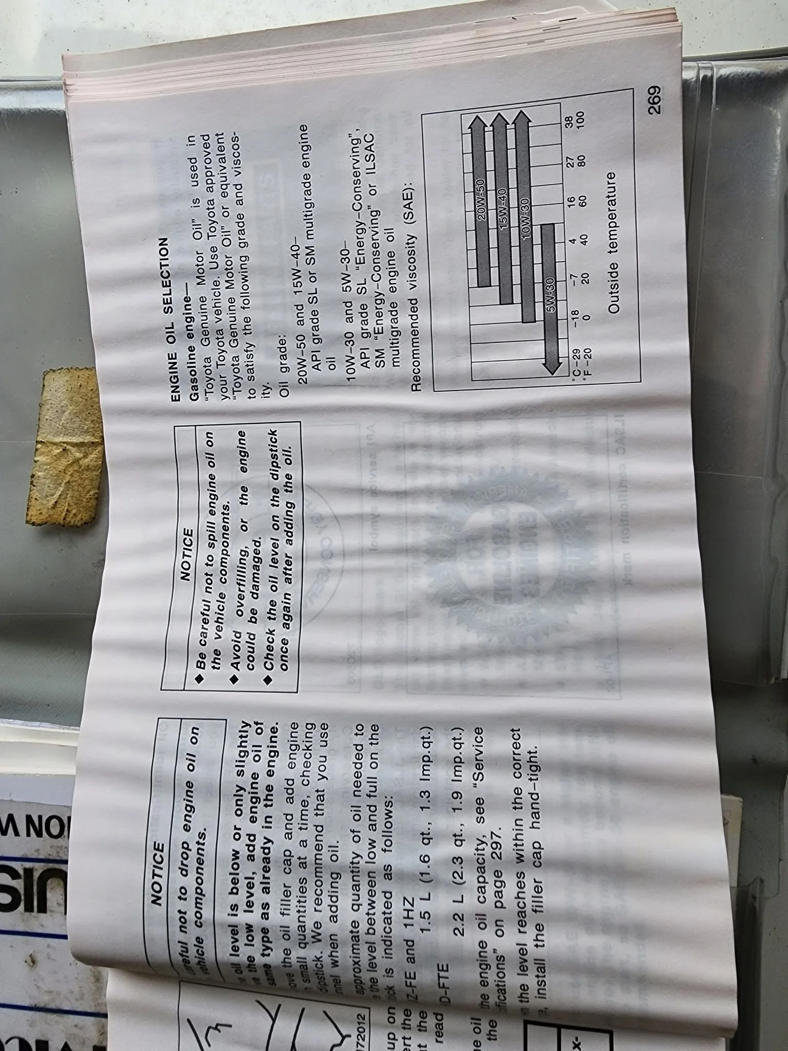

Thanks for all the replies guys. Agree @Jack90210 oil threads are very fun haha.
I made a new LC 100 series friend in Melbourne, Australia. He was kind enough to send me a picture of his owners manual.
In short, I think we get screwed by the CAFE regs here in the US.

My new friend in Melbourne AUS runs 20w-50 with no issues and said the lowest he sees in winter there is around 1C or 2C (34-35 F)
