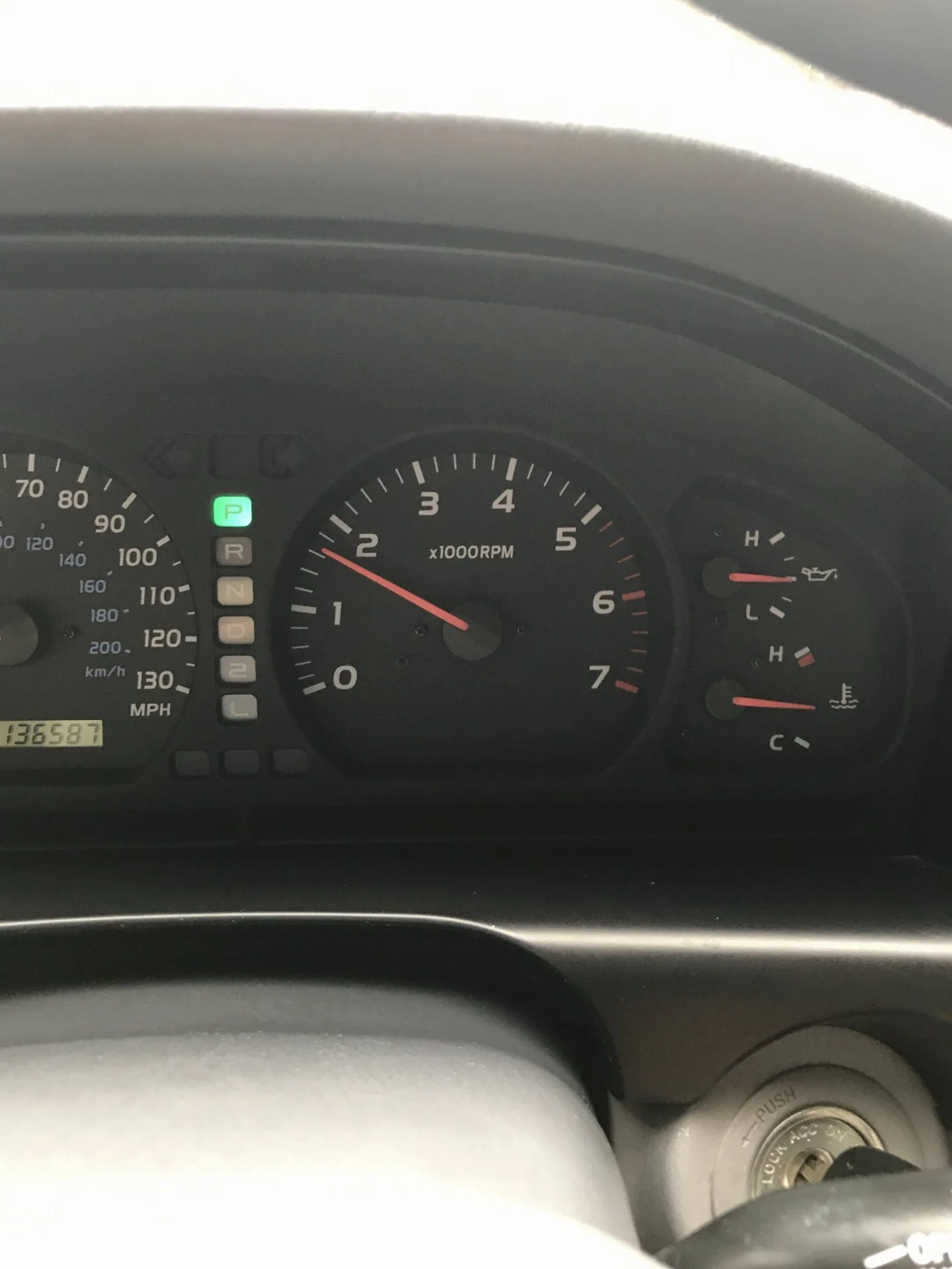

Pretty sure my oil pump is about to take it in the shorts. Here's a brief list of symptoms:
- cold motor start is ok. Oil pressure pegs right to the 3pm position
- cold motor driving - ok

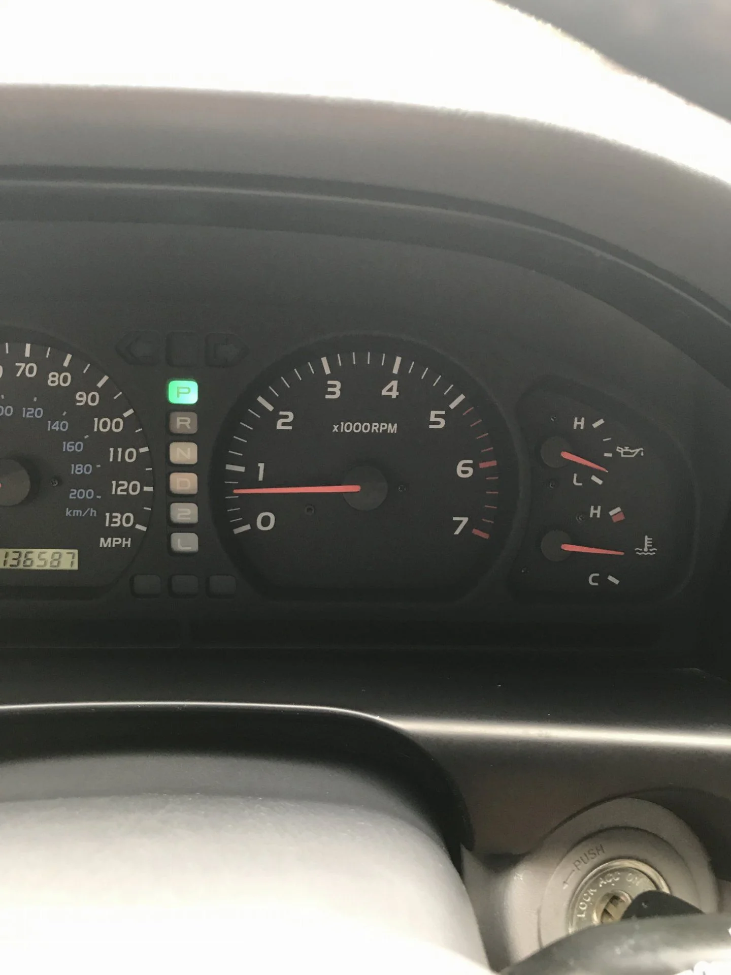

- warm motor idling - oil pressure drops to the tick mark between "L" and the normal 3 o'clock. Sometimes it will drop a smudge further.
- warm motor driving. Oil pressure is engine-speed dependent from (what I think is) low at idle to normal at anything over 1200 rpm.
So is the oil pump about to give up? I have to have the timing belt, and all the while-you-at-it's, soon and I'm hoping that the oil pump can be changed without much more labor?

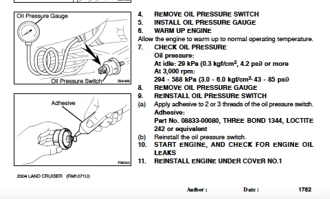

Maybe the sensor is failing, I haven't noticed any mention of any oil pump failures in these 2UZFE engines here on the forum. I would remove the oil pressure sensor and put a mechanical tester on it and measure your oil pressure.

He'll be 4" away from the pressure sending unit when he goes to spin the oil filter off. While at the parts store for oil and filter, he can check out a loaner pressure tester at the same time. Doesn't seem like its all that much additional work.
If it's a $30 part I may as well just change the sensor. There is so much tolerance dialed into the gauges and sensors now a days I'm either not used to a 20 year old truck or there's something wrong.

A oil change is more beneficial than a sensor. This is how you would expect your oil pressure to act. Look at the FSM above to confirm this, the difference between Idle and 3000 rpm, if it was steady I would be more worried,haha. Oil pressure will drop when the oil thins when hot, it still achieves the same if not better flow. Post a video and others can check there's, I know mine does it, but to what extent I can't remember.

The school of thought used to be you need 10 pounds of pressure for every 1000 rpm engine is running. So at idle they can read pretty low and still be ok.
Ok. That puts my mind at ease. I'll replace the sender at the next oil change while I'm down there.

Again, if you've paid attention to the gauge in the past and this is new, then there's maybe something to chase. If you're just noticing the gauge and how it moves, I'd hold off on throwing money at things that might be normal.
