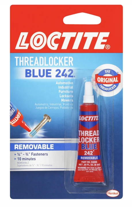

And then there's Loctite 242.

From the FSM: Toyota adhesive 08833-00080 (discontinued), Three Bond 1344 (likely the same as the Toyota part), or Loctite 242 or the equivalent applied to three threads before installation.
So point is, Toyota appears to be saying either of these thread locking adhesives are acceptable??
However when applying to a "wet" engine (oil in the oil galleries) it seems
that an oil tolerant thread locker (Loctite 243) might be a better choice, but even then the threaded port in the oil cooler cover should probably be cleaned of oil before installion, IMHO.
Checking the break away torque of Loctite 242 is around +/- 110 in lbs, for Loctitie 243 it's about double that depending on the size of the bolt. Not sure what level is too much??
