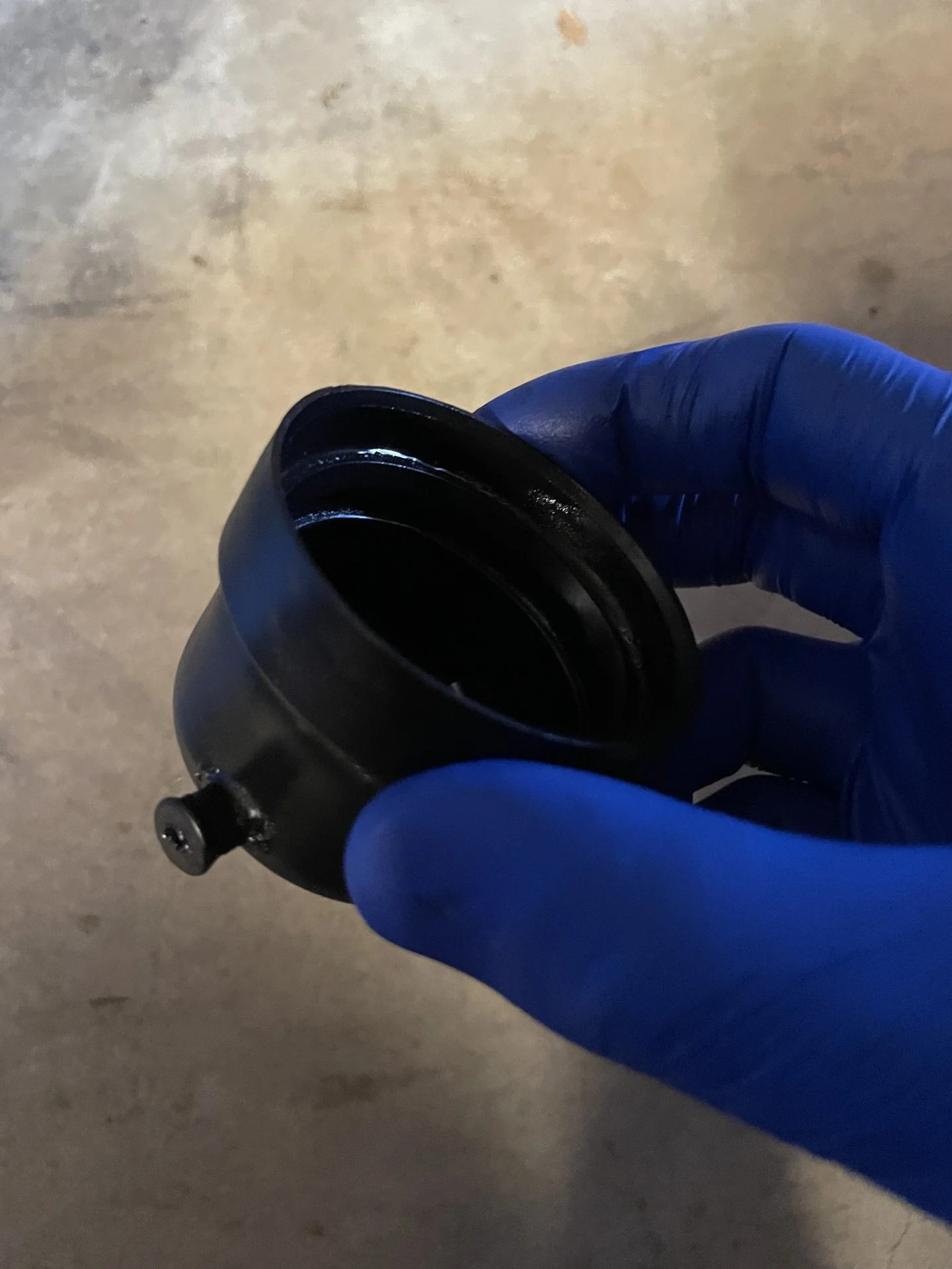

I am trying to understand how the oil pressure sender wiring works on my 87 FJ60.
I pulled off the rubber boot (which has a hole on the side).

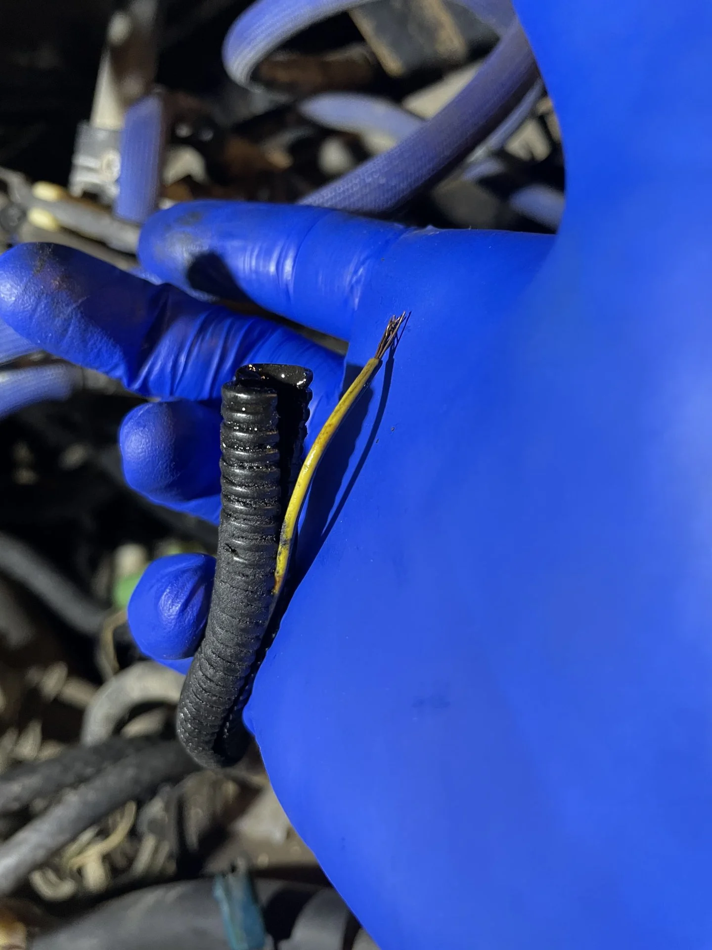

Into the boot ran a yellow/black wire which is encased in a plastic ribbed conduit.
The pressure sender itself has the spade connected to the spade on the side of the pressure sender and nothing connected the center "nipple".
How many wires are supposed to run inside the rubber boot?
How does this all get wired up?

Thanks for sharing. I read the whole thread and reconnected the yellow/black wire with a new spade to the center of the sending unit.
There is no response by the gauge as were yesterday it just read low and then stopped working.
I tested oil pressure with a mechanical gauge and it reads correct at 60+ psi.

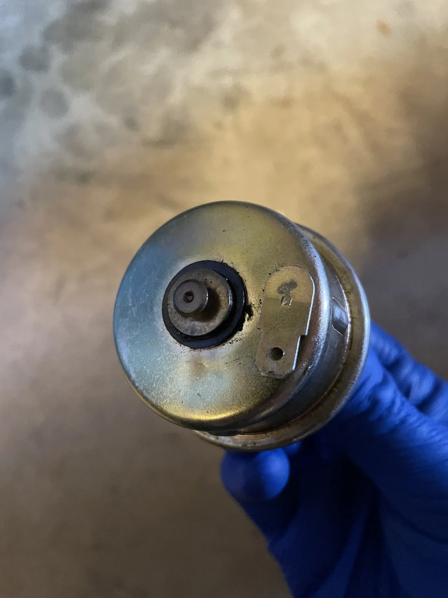

What’s interesting is that there was always a spare in the side tab but no wire going to it. However I could see broken wire stands crimped into it.
If the yellow wire was connected to the spade terminal, your oil pressure gauge is now burnt out. You may be able to mechanically bend it back into shape depending on how long it was left like that. You likely need a new oil pressure sending unit, and a replacement gauge.
It is possible but rare ,for there to be a poor connection to ground on the sender.
Re the spare tab from the previous link .
One more thing. The extra lug on the sender is for making a proper earth to the sender body. It's not usually needed unless you use too much thread tape when screwing the sender in. The thread tape can insulate the sender body from earth , but this rarely happens, so probably no need to bother with extra earth.
**if the sender thread is made of plastic, the extra earth is essential.
cheers, and good luck."

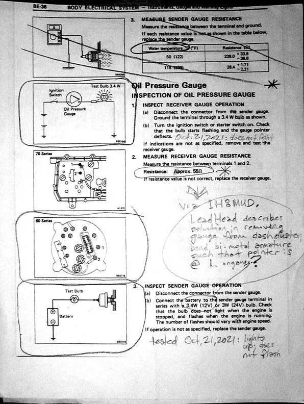

-resistance of yellow/black to ground: 53 Omhs. Did not fluctuate much with wire moving.
- resistance of spade to batt ground .8 ohms.
Looks like possibly the gauge is dead?

Look at page BE-36 in the factory service manual, your ohm test is near spec of 55 ohms, most likely the gauge in the dash is bent beyond proper reading. I just did this repair last month. Thanks to @Lead Head detailing this.
Here is the page BE-36:

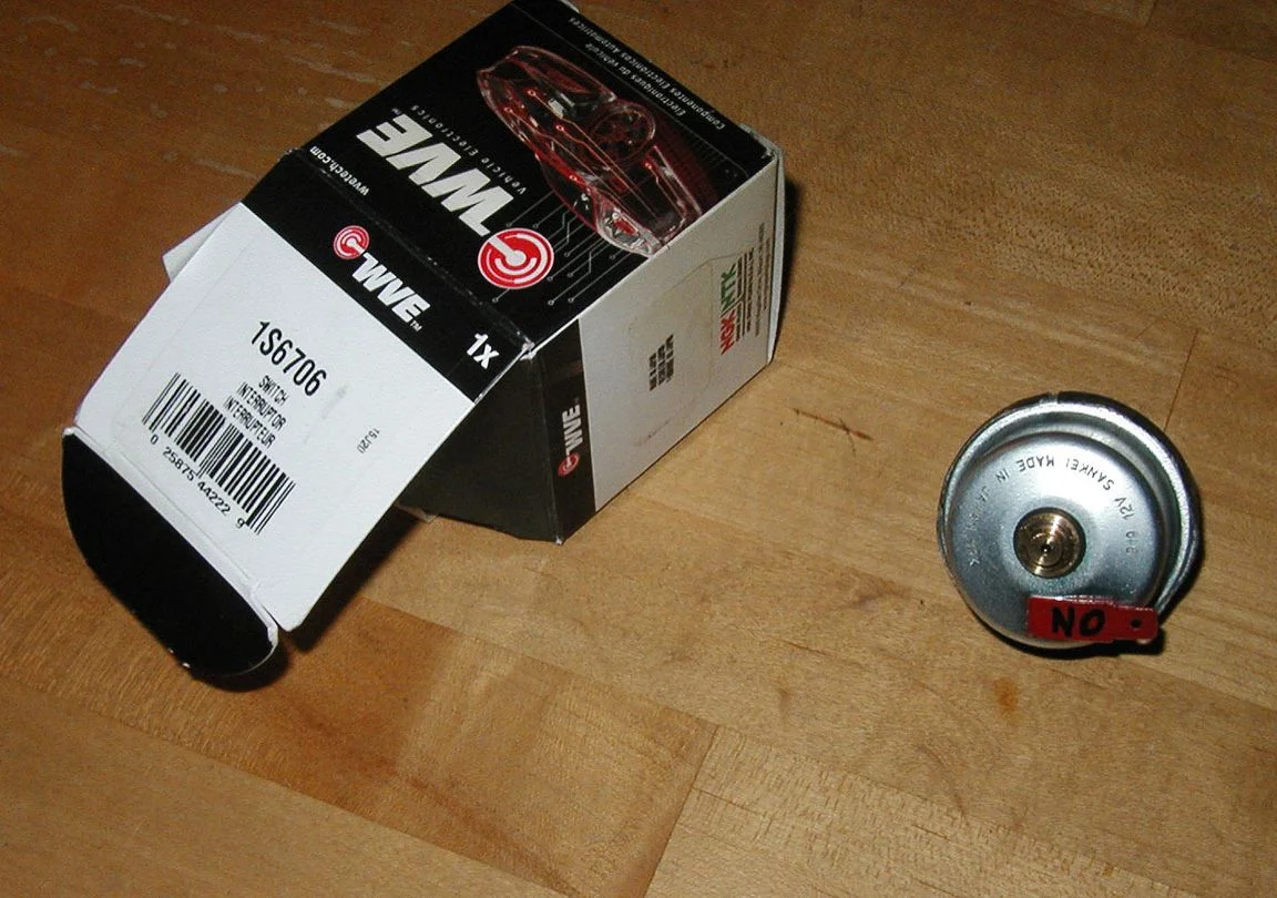

Additionally, I ordered a new sender from RockAuto ~35$ or so, made in Japan, WVE / NGK brand.
SKU was 25875 44222 also another number on the box was 1S6706
My gauge pegged when I installed this, and I was certain to place the connector on the center pin...

@Zhenya...Cruiser Parts has used gauges for $75 plus shipping. Pretty close to $100 total. I have one arriving Friday because my shop had to replace the sender, and didn't know how to wire it...and fried the OEM gauge. As @pithicus said, that male spade is typically not needed. Wouldn't it be nice if Toyota included some info with the new part! A you can see here, I put an insulated female spade over it so that it can't be used again by mistake. Builds - Sentimental Restoration of Family 1990 FJ62 - https://forum.ih8mud.com/threads/sentimental-restoration-of-family-1990-fj62.1095049/page-10#post-14126142

Here is a photo of the sender unit which I 'customized' with red paint on the no no spade and gorilla taped the flange for the rubber cover to fit snugly

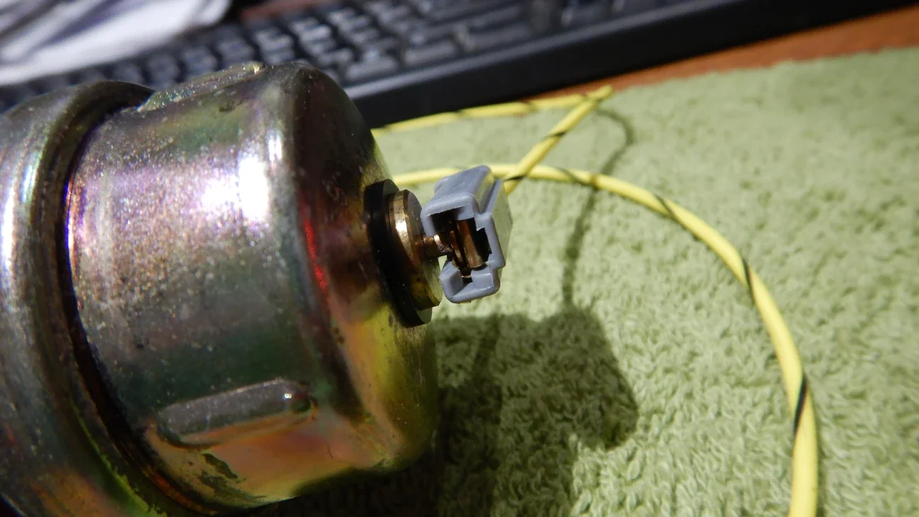

This Link may help you out , it includes :
- NEW Engine wire #4 complete KIT ,
- a OEM YAZAKI TOYOTA Updated Positive Grip DETENT Ball Equipped solid BRASS , oil sender Connector
- the 2nd Late Late MODLE Ground Tab u have in your hand sender , is a aftermarket later part...
- the 2nd ground tab was NOT introduced until the 1FZ-FE was installed into the 80 series 1993 era - LATER
- while NOT at all a bad thing , i update any job or my own land cruisers to the ground tab 100% , its a necessary feature i feel for a solid gauge signal , zero GREY area here
