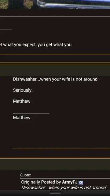

And... Lmao! Then it further dawned on me, the wife ain't home!
Edited the other post ,didn't realize I could with the mud app...
Just a screenshot of the dishwasher idea...
