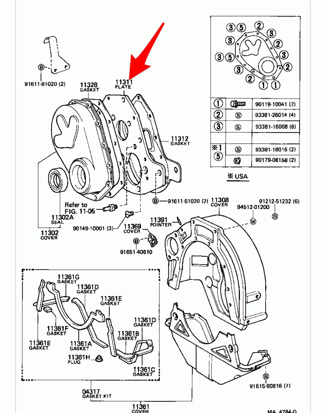

Are you talking about the timing gear plate?
Hi yes, I've attached a few pics. Ive tried to seal it up the best I could, so I know it looks super messy. I will probably just tear out the fan so I can get in their better. Looking at the first pic, it looks like a plugged hole near the top of the plate. First pic is looking up, second is through the fan. Pardon my newbieness.

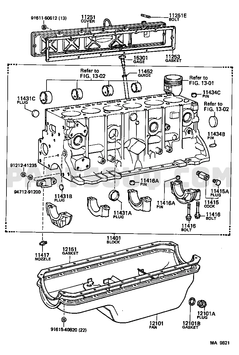

Tight plug #2, from 6/84 to 87 it was this part (11431B in the schematic). It's threaded so seems like you could take it out and put some loc-tite and reinstall.

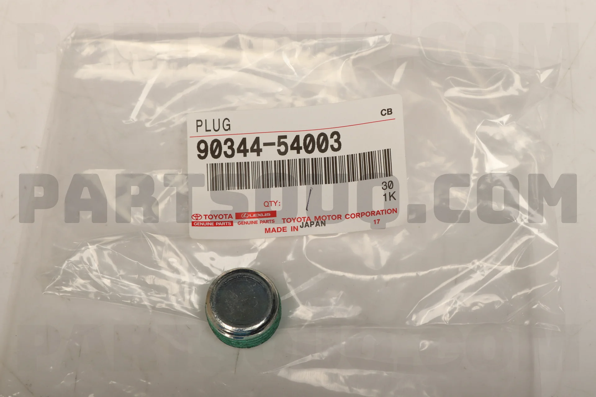

early or pre 6-84 shows part #
9033024013. not sure if this one is threaded or not. But partsouq shows as NLA.​
Hi gman, fantastic! That's it. I can actually see the oil leaking from there when it's running, so I'll find the part and get rocking. thanks for the help!

you can most likely just remove the plug, put some loctite on it and re install. Just clean up the threads on the plug and in the hole while it's out. I'm guessing the sealant on the threads is worn off.
