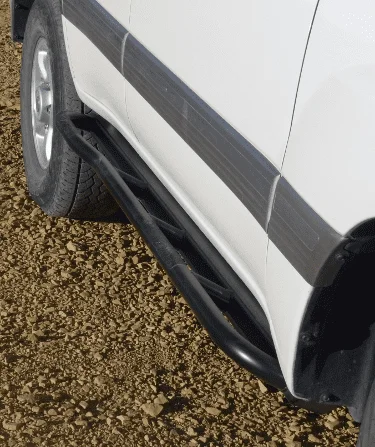

Actually, I was just thinking of outright removing the sliders - although those look pretty BA!:geek:
You’re confusing. Does your truck have metal sliders or factory Toyota running boards?
Sorry, not caught up with all the terminology yet, but yeah they're the stock running boards.
Those won't slide all that well :rolleyes:. Not more than once, anyway. Lots of us take them off because the truck looks a little nicer that way, and we don't have to worry about banging them up at the mall.
Actual metal sliders like others have mentioned are going to be loads cheaper than a wider stance, and (IMO at least) much more useful. There are a couple of really good vendors there on the front range (Slee, BIO), and a few more scattered around the country.

- Ditch the running boards, replace with sliders. Really - sliders are likely the only mandatory upgrade/armor for these trucks.
