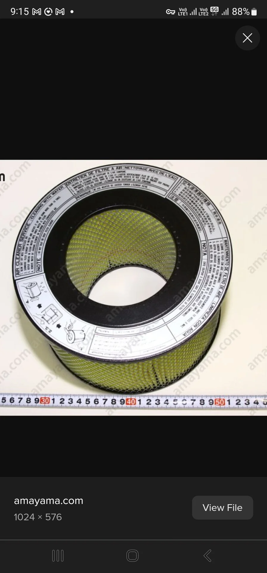

Toyota-brand filters are washable?
Yes at least some are. They have a graphic on the top of the casing with instructions.
Toyota makes a disposable air filter and a washable air filter.
Been running the washable for 40,000 miles and I just washed it for the 4th time today.
