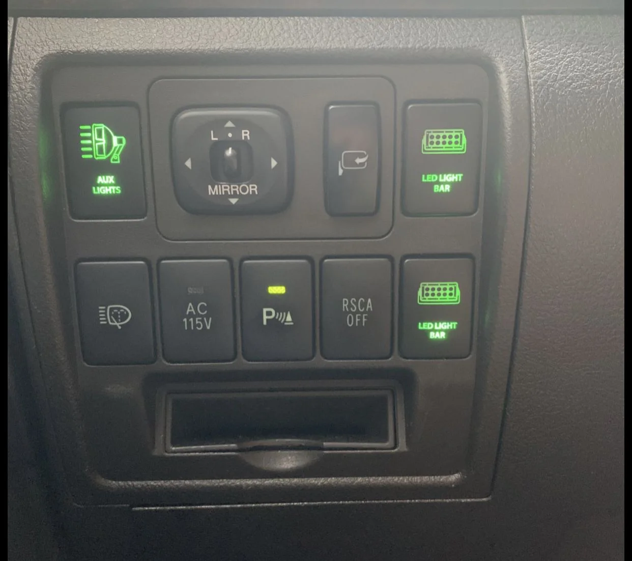

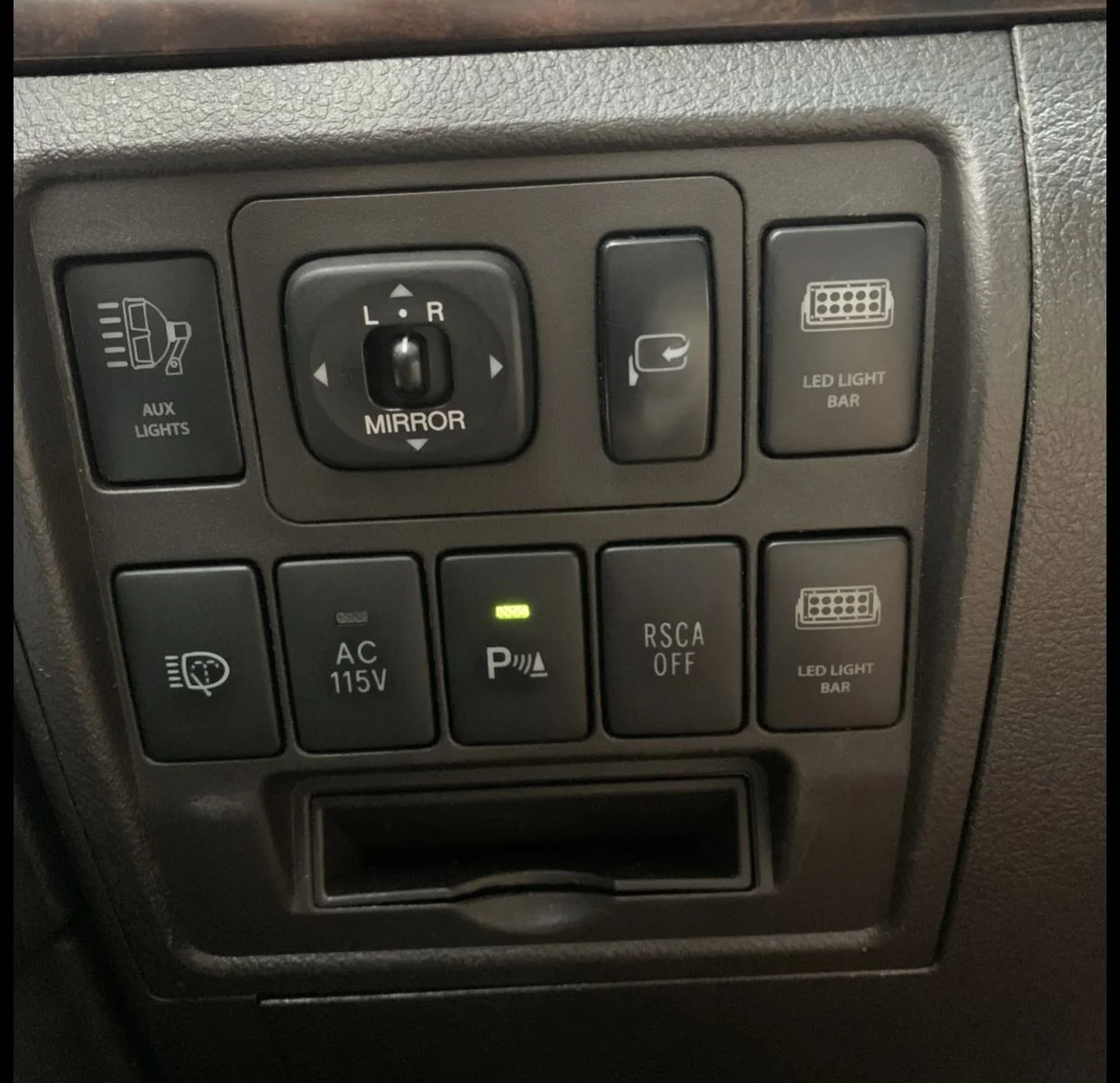

I haven't had any issues with them. I also installed one of their switches for my spot lights middle of last year. So far so good. 🤞
Mine is an 08 and these match pretty well.
