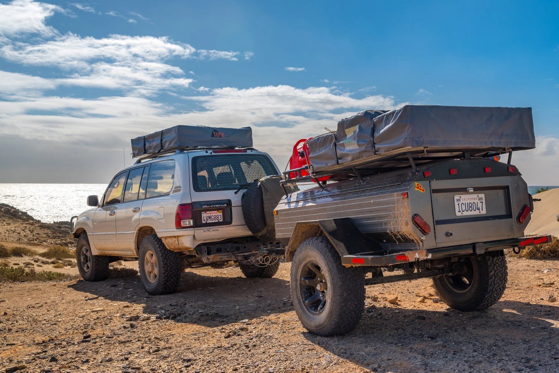

@BEG my fully inflated Spare fits just fine. Gotta finese the drive side Hook for chaings when towing but no issues. 285/75
Great pics. Did you get a non-NA spec tailgate also? And, from what I can gather, larger than stock spares don't fit with the stock bumper?
I did source the JDM lower tailgate as well. It was worth it to me to have the oem offset plate holder.
35” tire fit no problem with stock bumper and carrier.
Good to know. Any info on installation of the backing plates for the carrier?
I couldn’t tell you about installing the oem backing plate as I fabricated my own.
I think I’m going on three years with a 35” tire mounted on it and haven’t had a single issue with the mount. The rear corner of thrucks are stout.

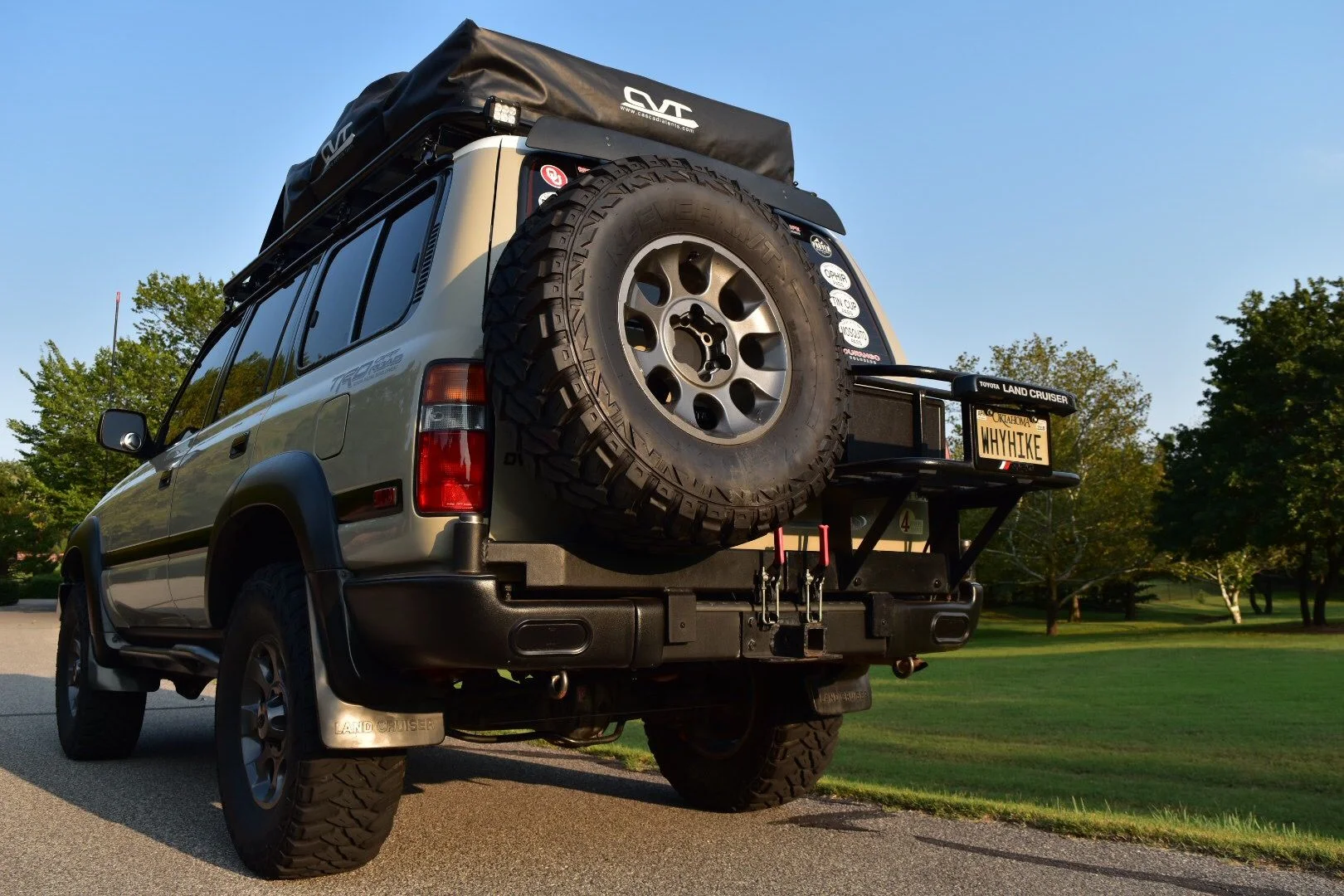

I may be getting around to the 100 series version of my swing out this summer after I get an 80 series batch done.
Here it is on the ole 80
