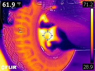

Maybe? it was pretty subtle. Going to drive more today, and check the hub temps with my thermal camera.

I'm going to bring some feedback after driving it today. If there isn't excessive heat in the hubs I'll just drive normally and keep an eye on the hubs for a while.
I wasn't able to do a ton of driving but I was unable to replicate the noise. I'll bring my camera to work tomorrow and check the temps after my 20 minute commute.

Hub temps were fine this morning.
