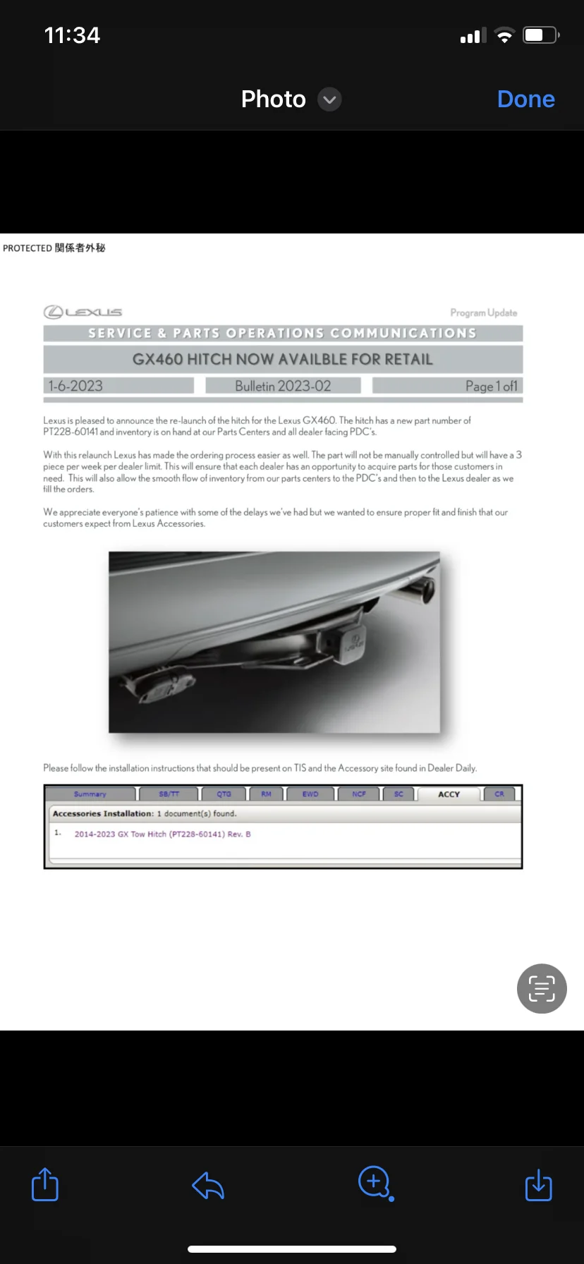

Just got word the OEM class IV hitch is now available from Lexus. My sales guy just sent me this memo.
I just called my local dealer and they told me the installed price is $1,268.00 - should be in their system tomorrow and available for delivery next week.
