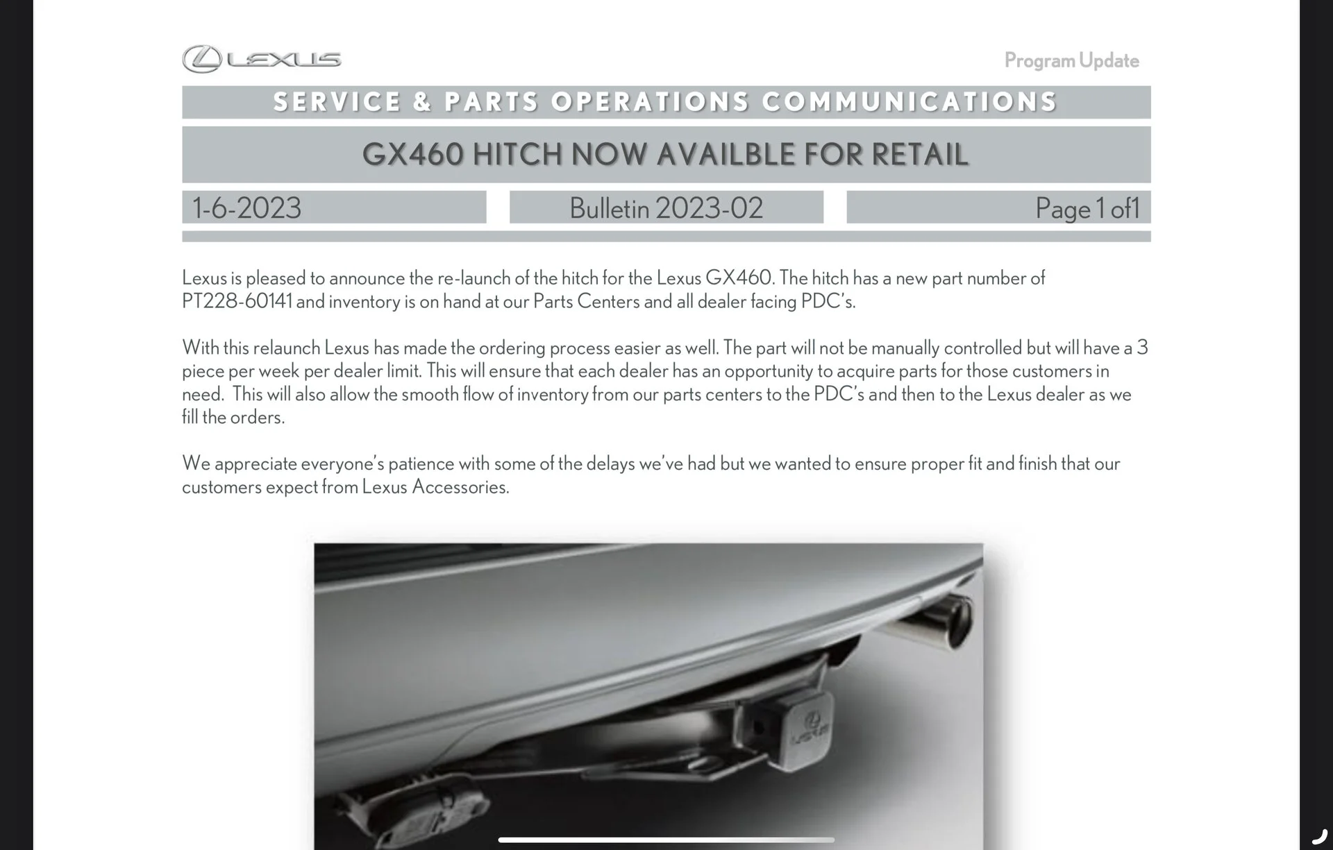

I just called my local dealer and they told me the installed price is $1,268.00 - should be in their system tomorrow and available for delivery next week.

I was told there is a "3 hitches per week, per dealer," allocation limit. I'm in the allocation for next week with the dealer I selected.

Class IV 460 hitch is now available for sale again… a few have already gotten them
