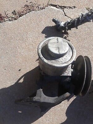

central american rig? pics of engine to see what you actually have.
Believe on non air pump 2Fs the power steering pump was on the right side. Alternator goes where the air pump goes and power steering is on the top right with the A/C Compressor below if it has one. The air cleaner on general market FJ4X model interfers with power steering pump on the left side.
On the non-US 2F's I like to use the 3FE pump/bracket setup from FJ62/FJ80, bolts right up and easy to find used, and they generally last a lot longer then 2F pumps. A lot easier to find in the states than the Non-US 2F pump bracket as well. 3FE crank pulley is a nice way to get the extra groove as well.
